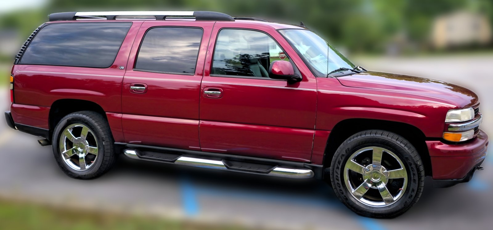

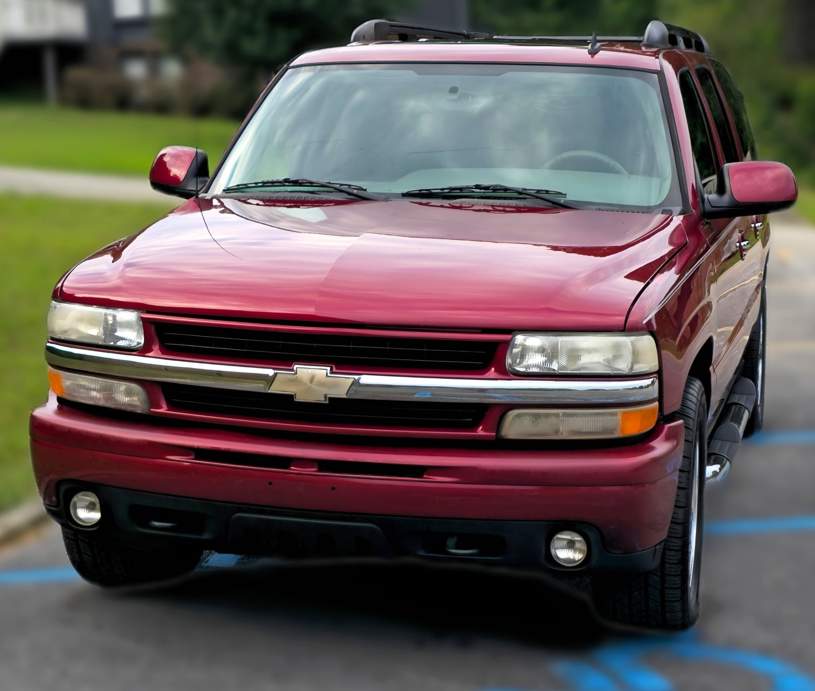

I couldn't have resolved either issue without being made aware of the existence of charm.li and the users in this thread so thank you to each of you! With that said, if anyone is in the market for a very clean and fully functional 06 Suburban LTZ and lives in or near Alabama, let me know as I have one for sale now
