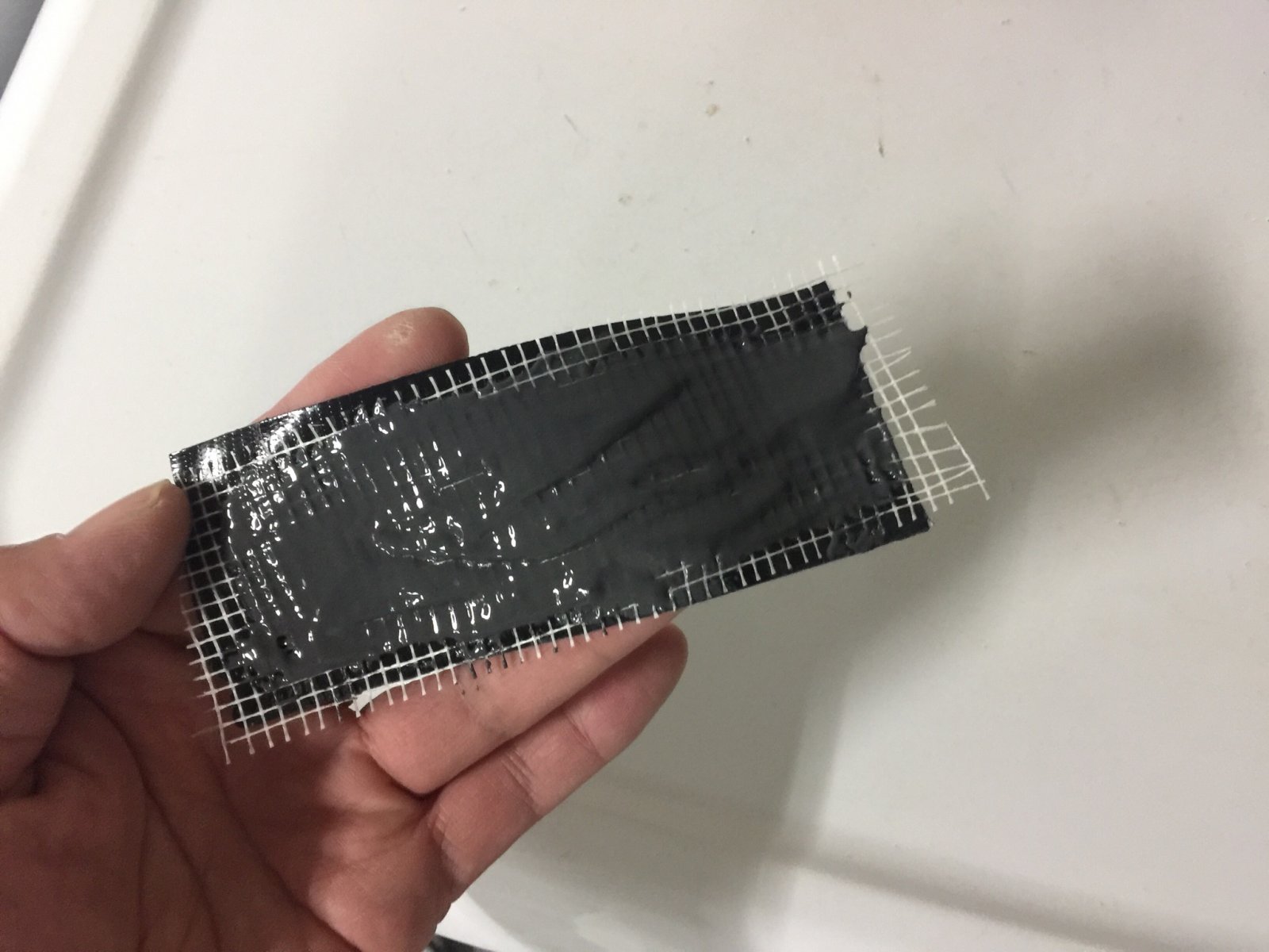

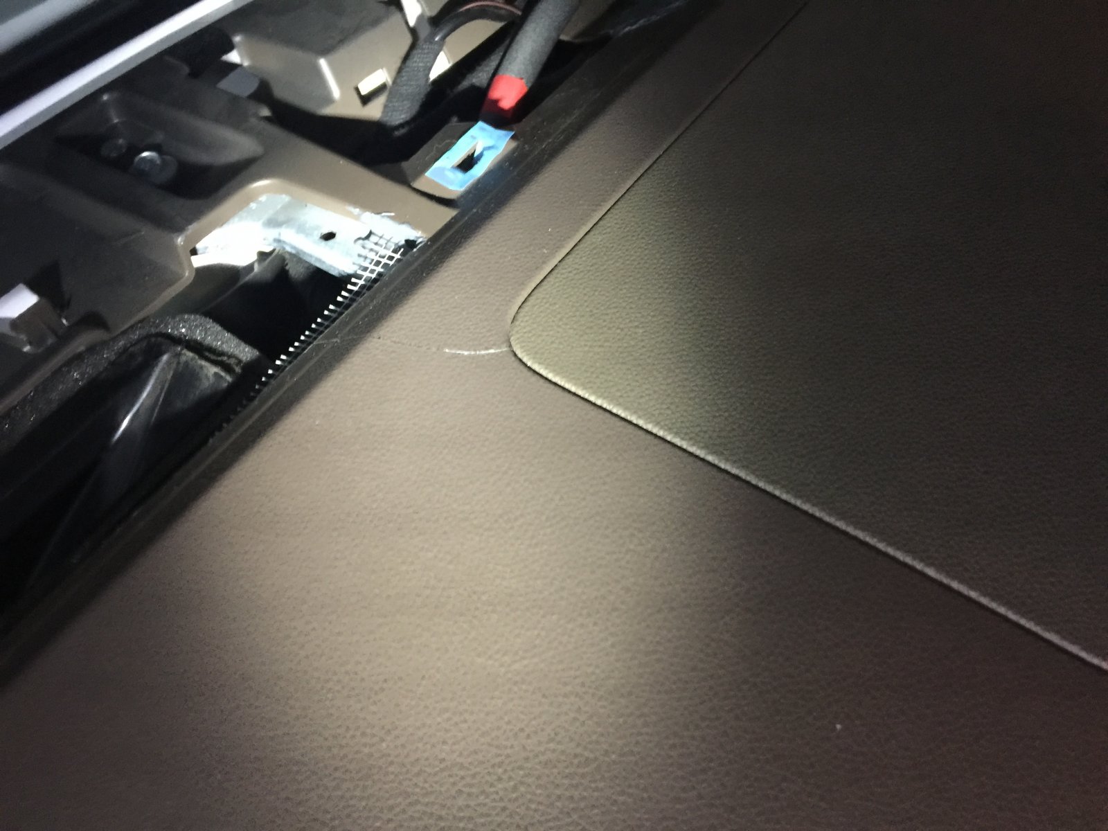

made some dashboard band-aids..
these went underneath of course (removed cluster and glovebox/airbag.. )
how long will it last? I didn't really prep the surface other than an alchohol wipe..
would change the dash, but after investing that kind of money i would want to fiberglass the bottom and vinyl wrap the top.
if the bandaids break, i see a dashcap in my future.. I know some of you hate them, but i dont like fuzzy things on the dash...
when I got mine is was cracked.. started checking it out and seems the center speaker has no support. it's just hanging off the plastic that gets hard and brittle. I made a quick support for it, popped the cracks back together so they didn't look so bad. it's not gotten any worse so far and looks good enough not to bother me everytime I drive it.
the thin plate near the base of the windshield just pops up with clips. a few are going to break off, but mix up some plastic weld for them and it pops right in after making a center support.
after seeing it, I'm convinced if gm would have supported that speaker the broken dash wouldn't be nearly as bad is it is. the plastic is crap, but all gm dash plastic is kinda crap and they don't break

Regarding the plastic, I'm amazed I didn't break the trim pieces! BIG Thank You to Tom who did the dash removal instructions on this site!
Yep I noticed middle was weak too. What did you use to prop it up? When epoxying my dash back, I couldn't get the parts to lineup without weighing down the right side of the airbag crack and pushing up center part. Same with cluster crack. If I only pushed center up, the crack opened up. Terribly flimsy dash.. Here's some pics of it now..
actually epoxied right side in two stages, just a little jbweld showing inside crack, but its pretty much perfectly level, driver side theres a ledge in the middle third..
