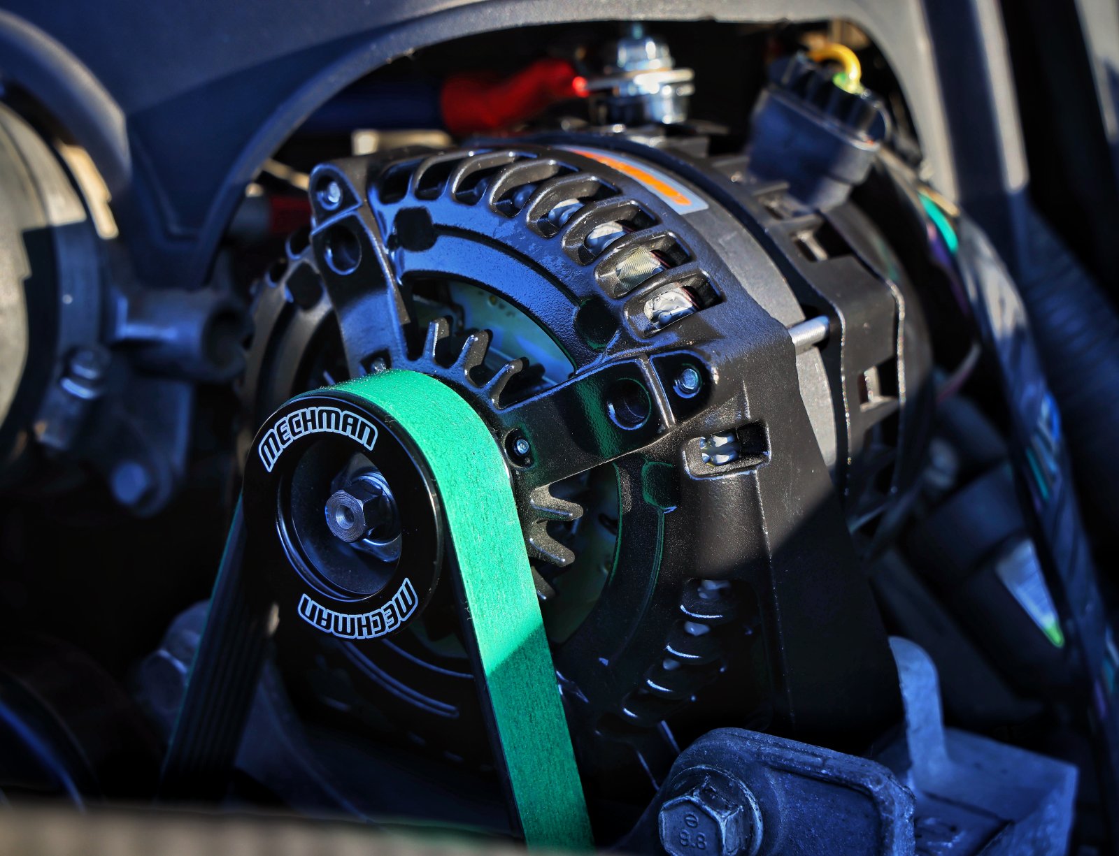

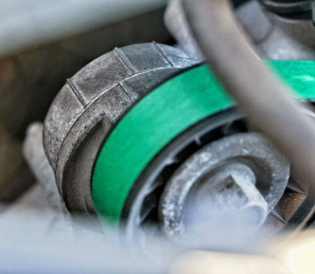

Dang it. I had it switched up in my head. Looks like I might be getting a larger pulley. Idk. Doesn’t seem to be slipping at all. I could probably use a new tensioner assembly but not sure if that would help
30,563
48,043
doesn't look like a problem, I only replace mine when they start making noises, those bearings don't live forever.

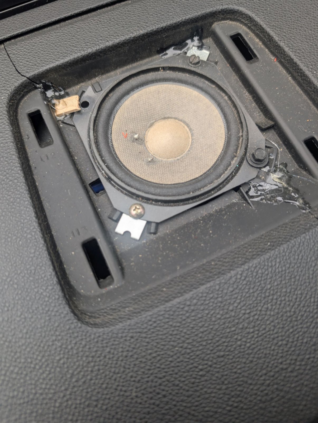

added a little clear gorilla glue to the spots that I previously repaired with epoxy that had broke loose again. thankfully these haven't ever expanded in the last 9 years
have to let it set for 24 hours before I pop the cover back on.

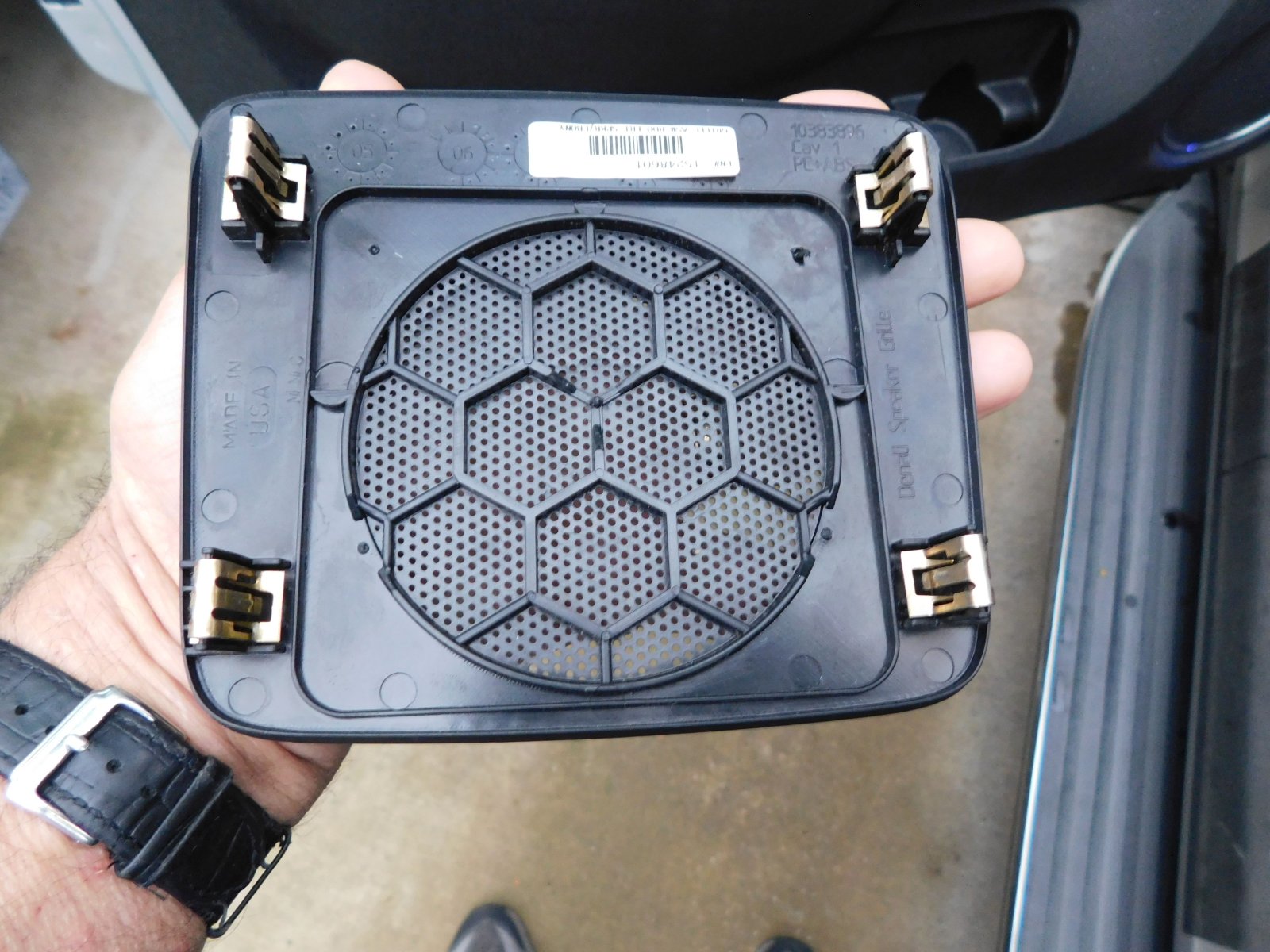

How did you get the screen over the speaker off? Does it just pry off with thin plastic pry bars?
30,563
48,043
those 4 holes you see around the outside edge are clip holes, if you use a thin pocket knife you can go in the edge of the cover and very gently pry up on each side until it pops off.
I say very careful because if yours is like mine the plastic is brittle. They are the same type of clips used on the pillar covers or other plastic covers like around the mirror bolt access
***a plastic pry tool wont fit, you have to use something thinner the blade of a pocket knife works well

mine has like 6 cracks, but that hasn't changed pretty much since I bought it, there are 3 of them around that speaker, hence the glue.

That is my interest in the speaker grille. I too have a rattle that is driving me nuts. I'm going to try to remove the speaker grill and see if there's anything visible that makes that noise, as that is where it 'seems' to be coming from.
30,563
48,043
there is no bottom support under that speaker so that's probably why the dash's crack in the same spot (upper left corner)
I put some hard foam and whatever I could shove in there under it to support it last time I had it out, I don't remember what all I used but it doesn't bounce anymore.
I have been hearing a little tiny squeak in that area which is why I re-glued it, hopefully that's all it was.

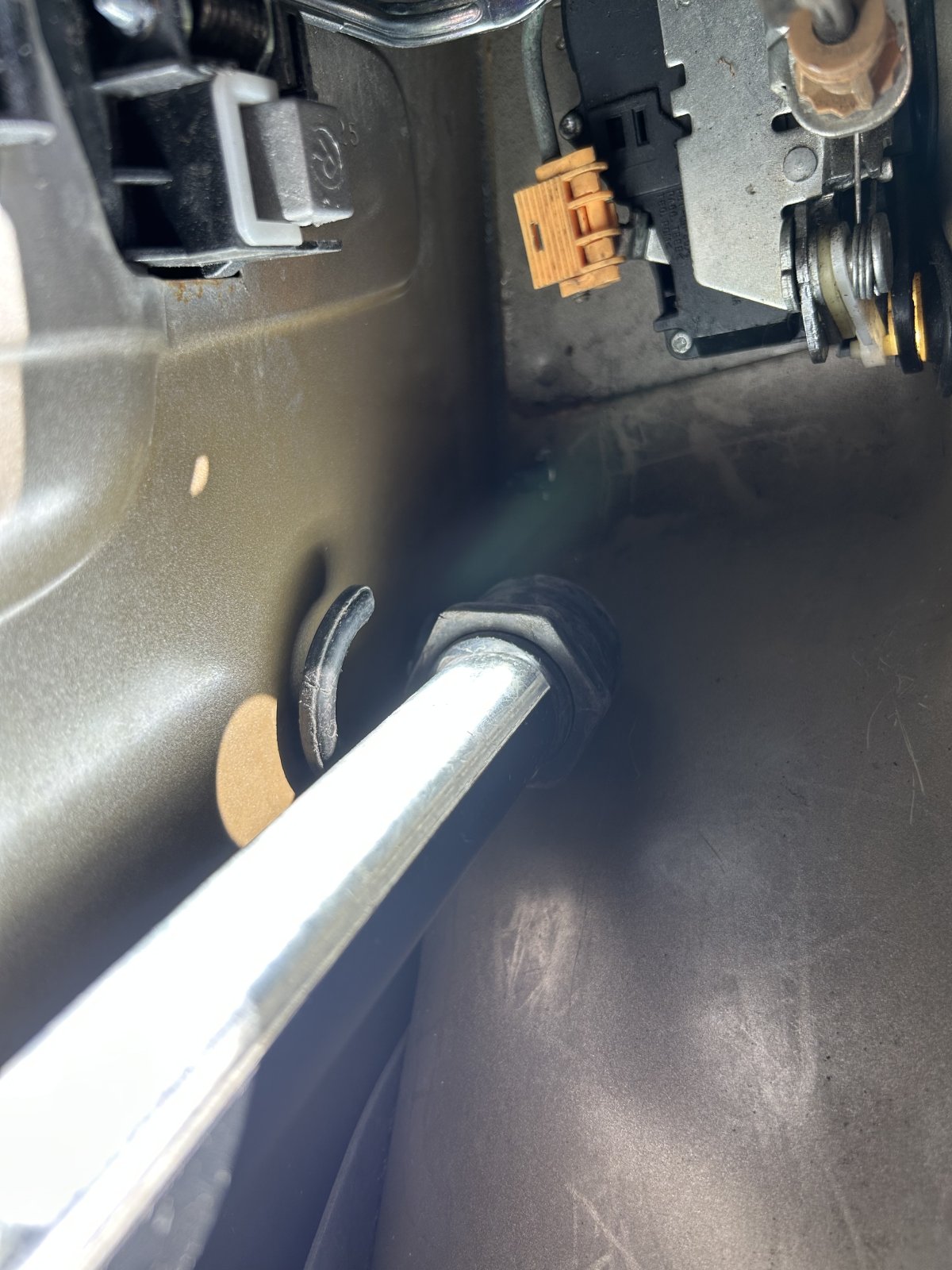

I don’t remember which of you clowns mentioned that little plastic clip on the door handles. I swear it was the next day I pulled up on the outside handle on my right rear door and felt something pop off. The handle quit working from outside. It’s the door my dog uses to get in and out. Today it finally was nice outside so I opened it up and that damn thing had popped off the rod. I snapped it back on and am left wondering if my visiting the forum was the reason I knew how to fix it or the reason it popped off because that’s one helluva coincidence. So maybe quit this talk about cracking dashes for gods sake. :p :p:p
89Suburban
Bull in the china shop
Space X Supporting Member
Jan 10, 2013
17,854
50,890
SE PA
I don’t remember which of you clowns mentioned that little plastic clip on the door handles. I swear it was the next day I pulled up on the outside handle on my right rear door and felt something pop off. The handle quit working from outside. It’s the door my dog uses to get in and out. Today it finally was nice outside so I opened it up and that damn thing had popped off the rod. I snapped it back on and am left wondering if my visiting the forum was the reason I knew how to fix it or the reason it popped off because that’s one helluva coincidence. So maybe quit this talk about cracking dashes for gods sake. :p :p:pView attachment 479496
It was a PITA, but I put a mini zip tie around that clip to keep it from popping back open. I ordered a few new clips to have on standby next time I have to dive into one of these doors.
