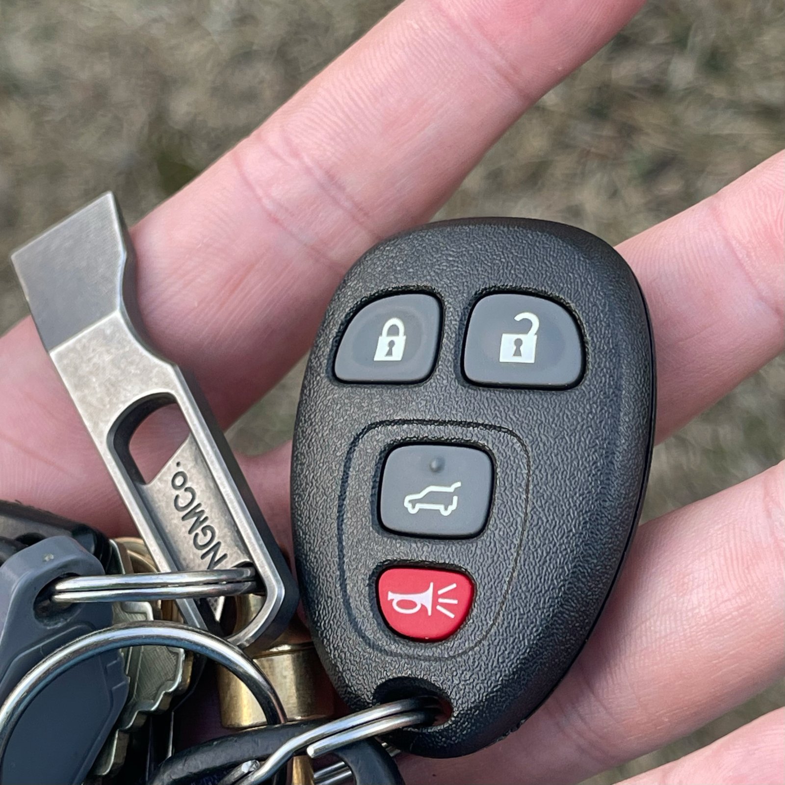

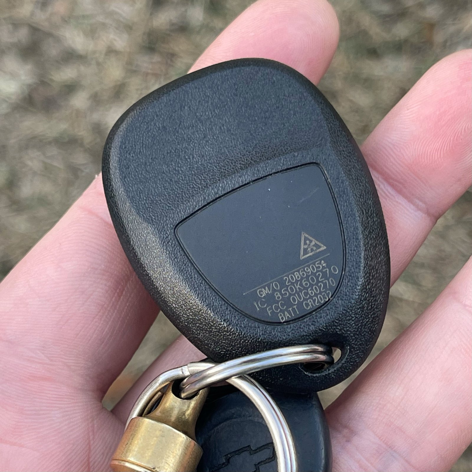

Got a “new” key fob. I’ve been using a 2015 style retrofit for about 4 years, but it was looking pretty bad and it has some extra buttons I don’t need. Also those buttons seem to press more easily (when I don’t want them to) so I’d always walk out to rear hatch being open.
Felt like returning to the old simple one. I got this from NorthCoast Keyless and picked the “lightly used” option (it’ll get scratched up anyways). $24.94 shipped and it appears to be an oem one
Boost Auto has 2021 style now and if you get the correct one for your vehicle, it wont have any “extra buttons” . Mine dont inadvertently open anything

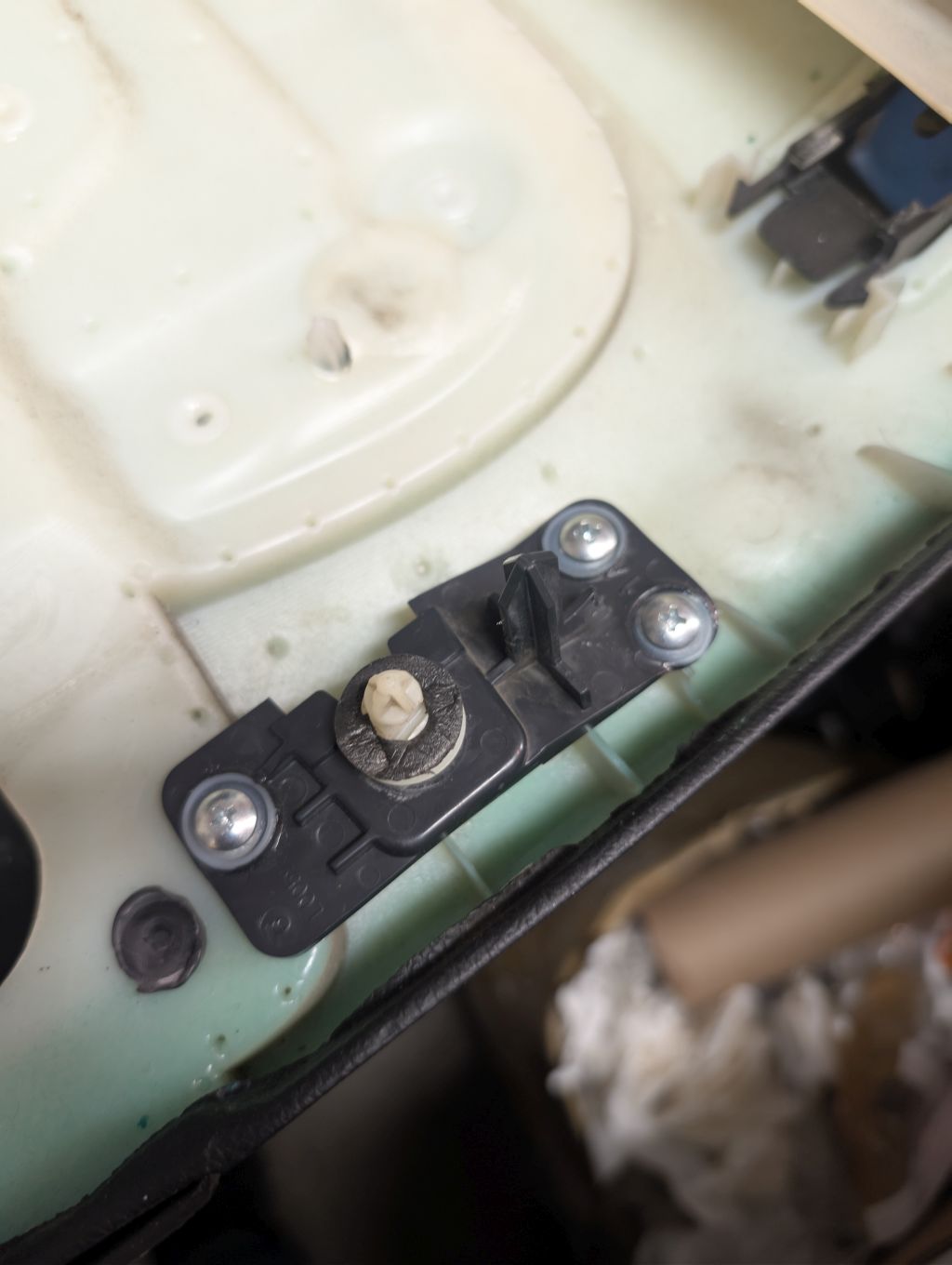

Nicely done! I need to replace my passenger side rear door handle that came off in my hand last week. I'm waiting until the temperature warm up a bit first.
you'll probably have to do like I did and grab the broken off nut with pliers, without scratching the paint. I managed to only make one tiny mark.
then the rod is held in with a yellow clip that just pulls back, it can be very stiff.
that part that broke off on my door panel is at the top outside edge (just below where the inside unlock pull-tab is), you might want to be extra careful right there

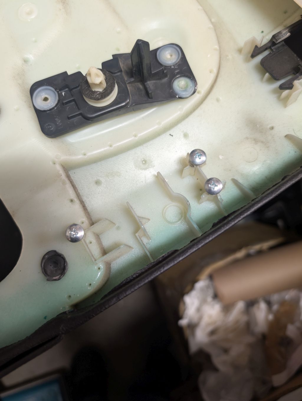

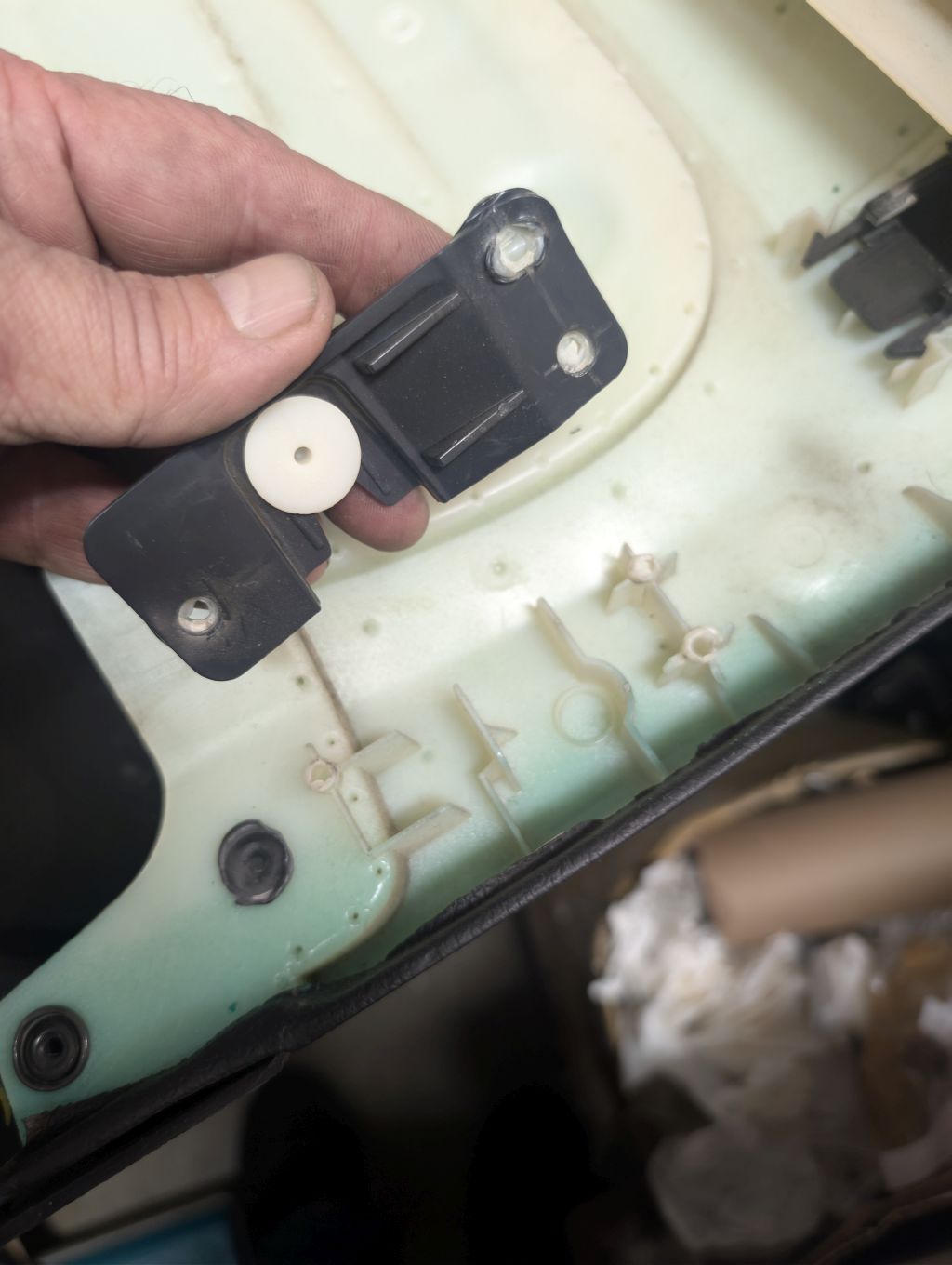

Thinking about that yellow clip hurts my fingertips!
I believe that door panel clip & bracket (that always breaks) is only on the front doors.
If you have a proper clip removal tool, it's' definitely worth using it there.
Thinking about 3d printing a clip holder bracket as my replacement panels are missing them.
That said, I don't seem to notice the missing door panel clip..
If you have a proper clip removal tool, it's' definately worth using it there.
the one that broke on mine was a rear door

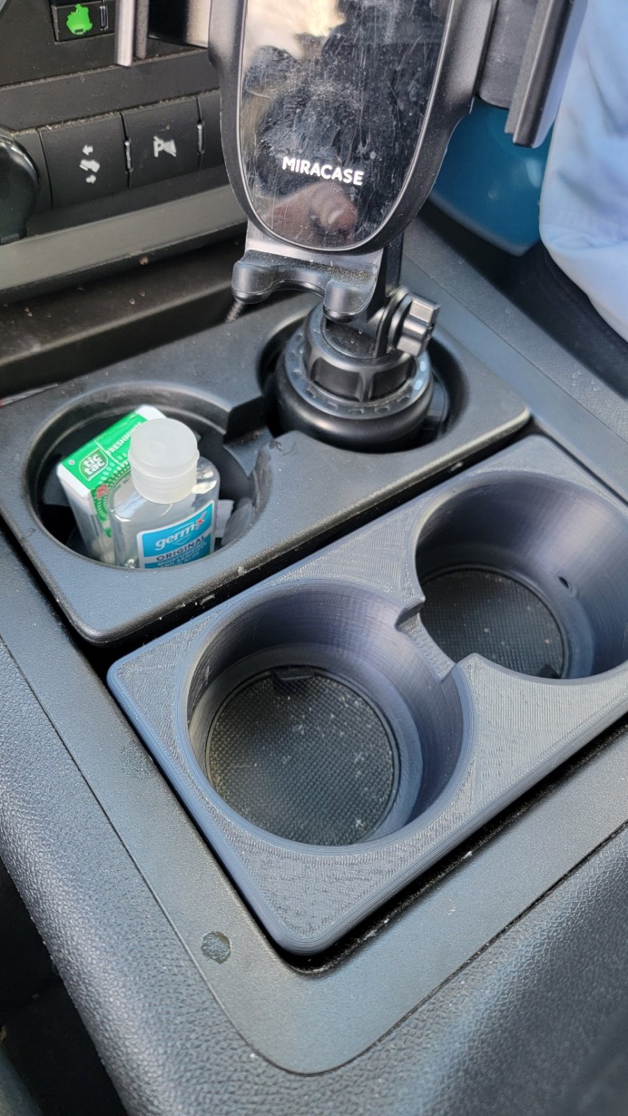

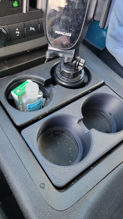

Buddy of mine printed this cupholder out and I like it. The print wasnt the greatest it warpped in a couple spots but the overall fitment and look is great. The cupholders are much larger than stock. It has a much tighter fit as well so its not rattling around. I'll have him print me another for the front set so it'll all match.

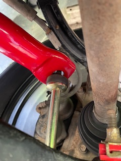

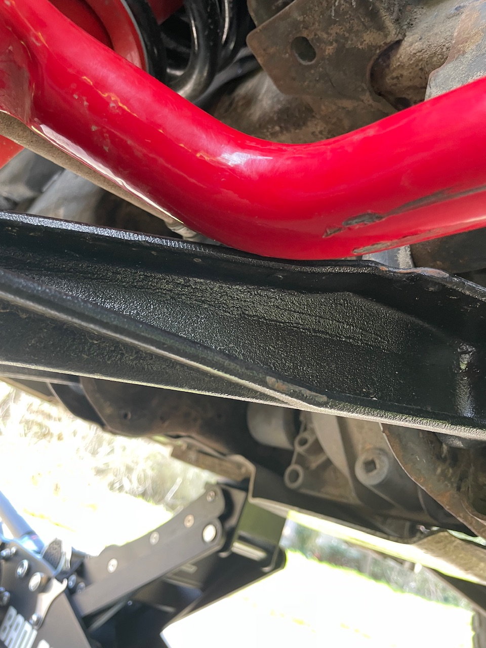

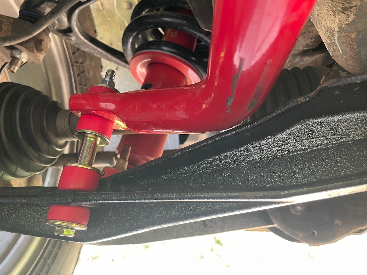

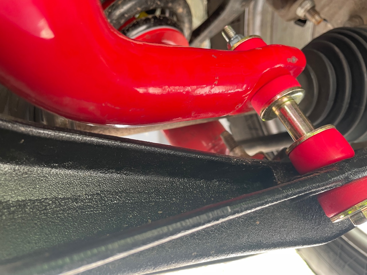

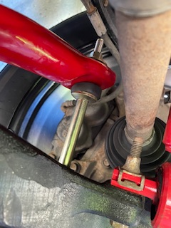

Installed some shorter endlinks to try and line up Nolathane swaybars better.
(Energy Suspension 9.8162 adjustable from 2-3/4 to 3-1/4" spacing)
I don't think stock is completely parallel with ground? but thought I'd try. 2 following pics, truck on ramps.
Found out the short links would cause the swaybar to contact the lower arm when suspension droops.
Passenger side could use shorter link than driver side.
Driver side is where the interference with lower arm is.. At full droop here...
Other scratches on the bar, from last time when I backed down my ramps, but still had a jackstand underneath frame which slid forward :(
(Why did I have jackstands when on ramps already? The ramps looked like they were starting to collapse!)
Went BACK to the 9.8123 links that are 2" center section and 3.575" spacing.
Installing them without jacking up stock height truck is no fun. Front diff plate rests on your chest..
Or a lifted truck you could use longer links, and it might line up better..
With stock length links, on stock height truck, the eyelets don't line up so well and the bar is at a less effective angle.
My recommendation for endlinks that work with Nolathane bars at stock height. (Energy Suspension 9.8123)

I hate to be an ass and ask, but: is the bar possibly on upside-down?
mikez71
Mar 9, 2023
3,236
4,010
Not at all! I had it upside down initially!! Alignment worse.. Looks like it might snap endlinks.
Current links are about .5" longer than the short links shown in my previous post.
upside down, rightside up.
Stock length endlinks.
