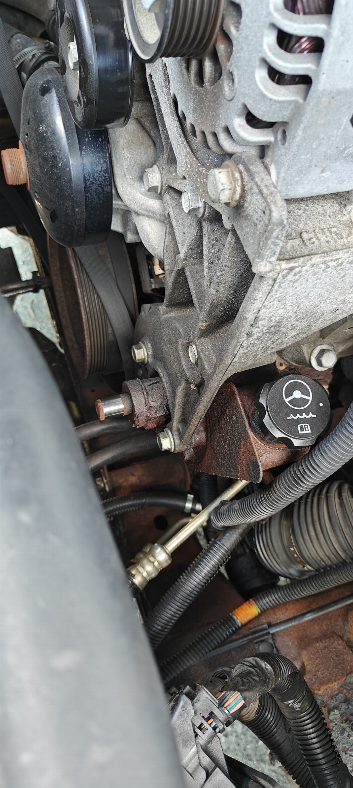

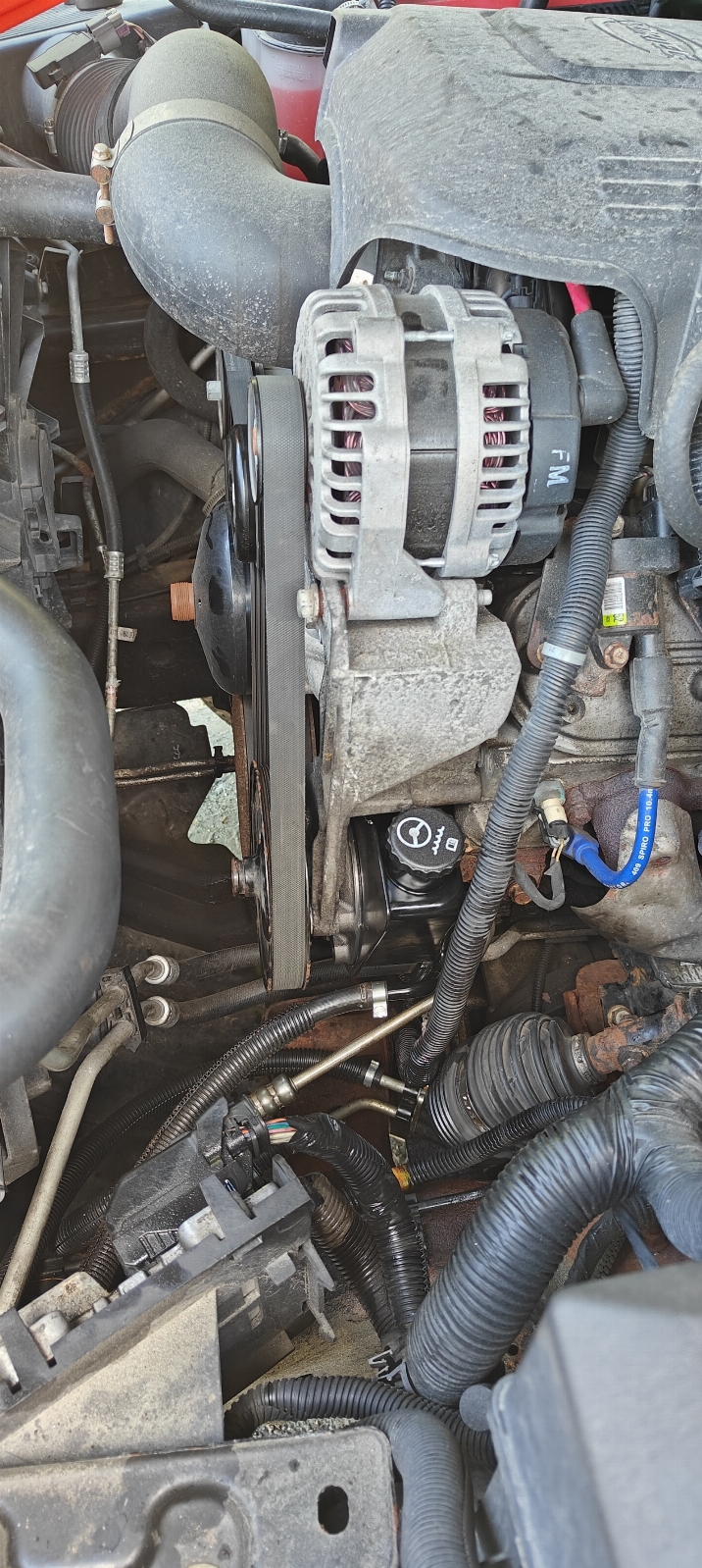

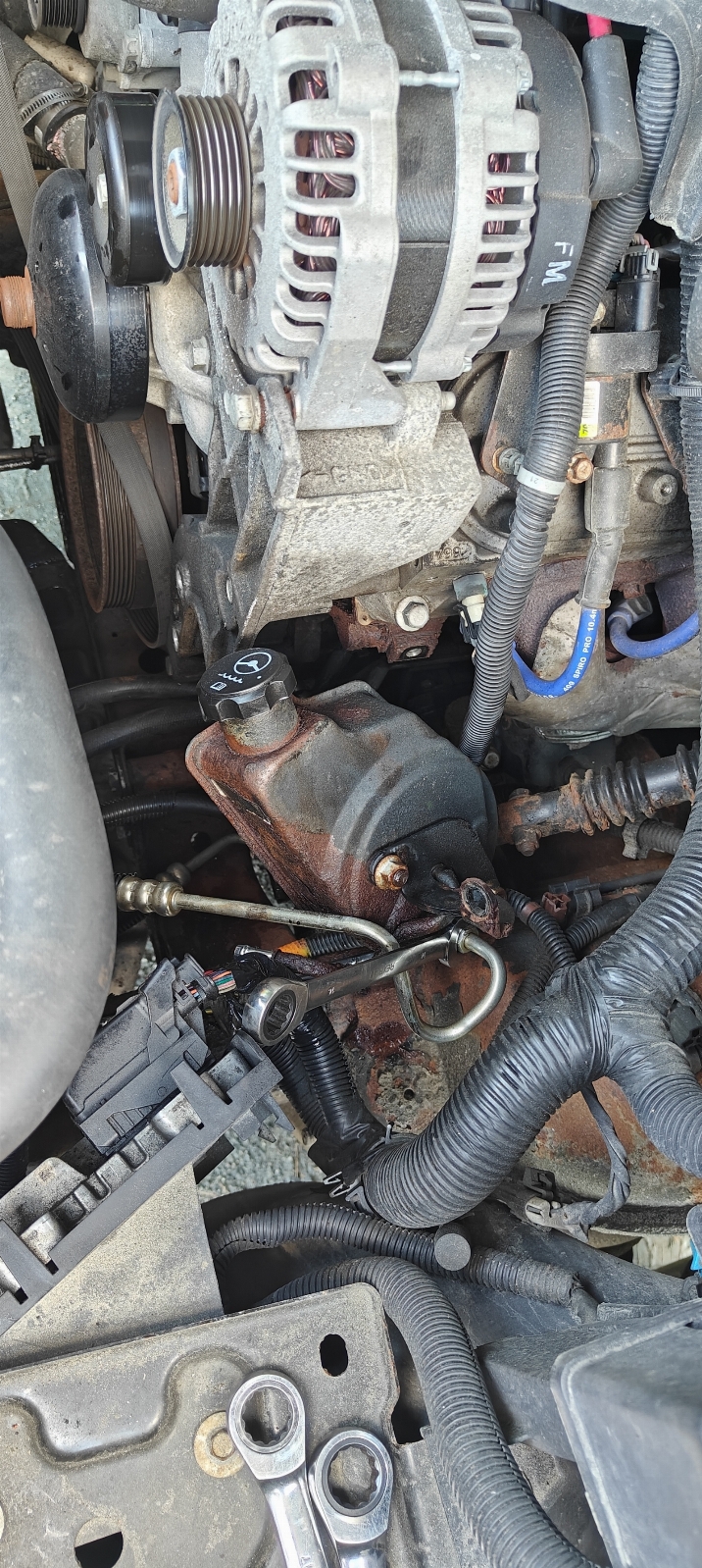

Replaced the power steering pump and reservoir. Replaced the lines recently, hoping that would end the seeping/leaking, but the cast iron pump body seemed to be magically seeping fluid through its pores.
Old:
View attachment 431158View attachment 431159
New:
Ignore the heavy patina on everything else.

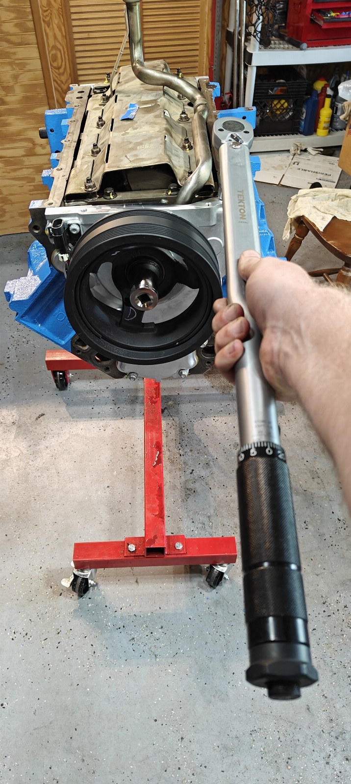

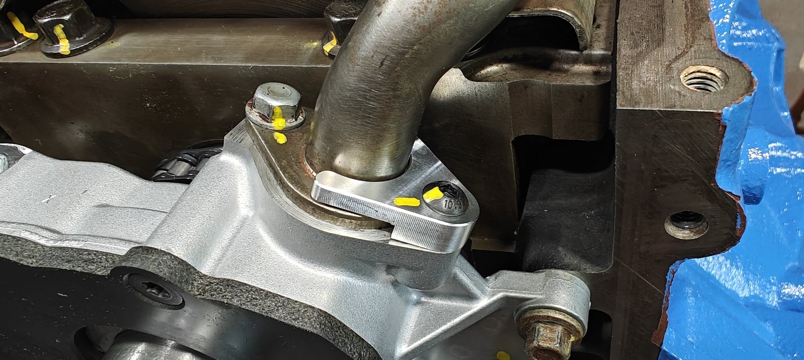

Man, it's been a busy day...

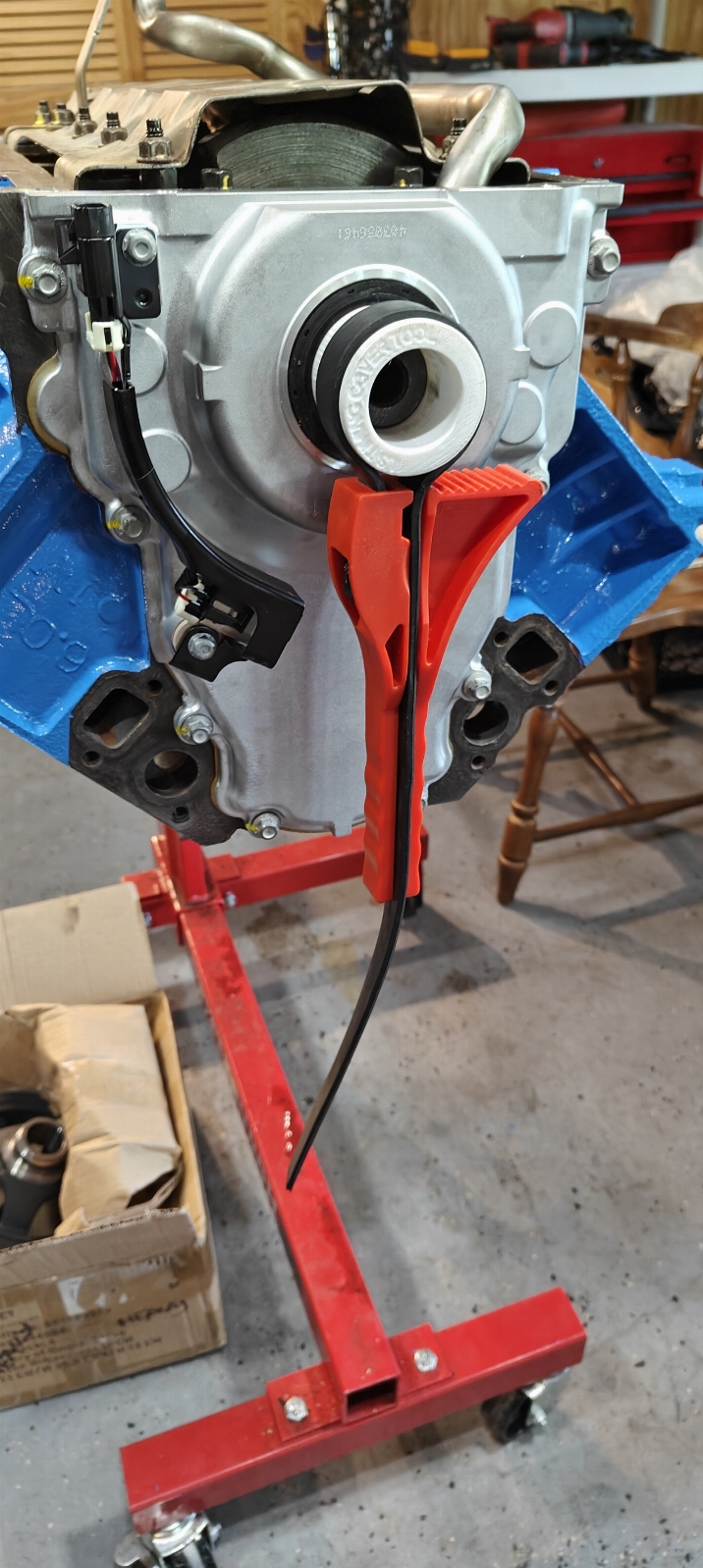

Oil pump return bracket thing showed up, so that went on. I added a squirt of blue thread-locker, because I couldn't find a 4mm hex-socket to torque the screw down. I guessed, and heard it "click" in my head, so I left it at that. Then the front cover went on, but it gripped the alignment tool a little too well. Luckily I still had a set of these rubber strap wrenches from tightening oddball AR-15 barrel nuts, and that worked. Then the harmonic balancer went on part way with heat, then the rest with the old bolt. Finished it off with 235lb/ft. of ARP goodness.
Literally the only reason I bought a new torque wrench (or two).

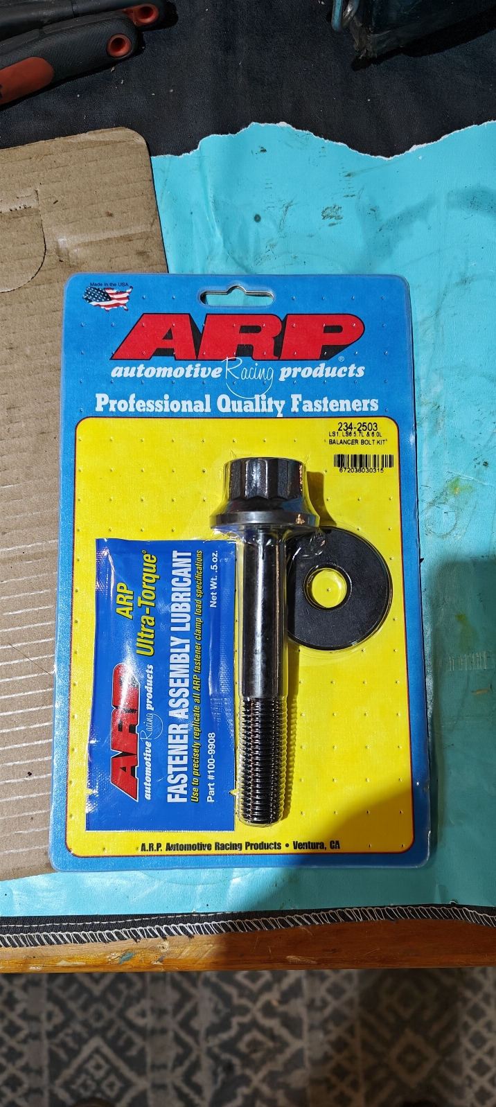

View attachment 431163View attachment 431164View attachment 431165
your build makes me want to build an engine lol.

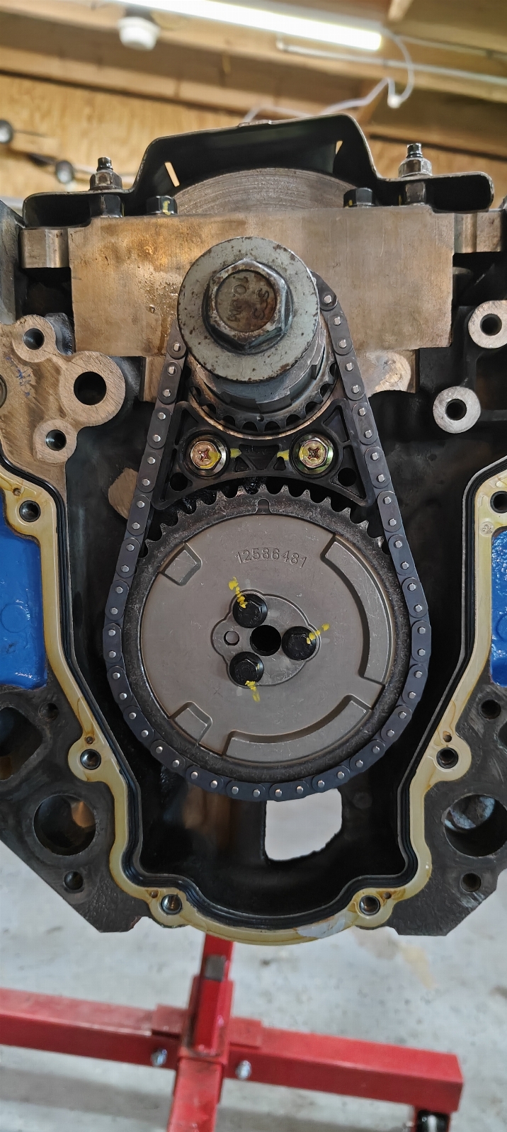

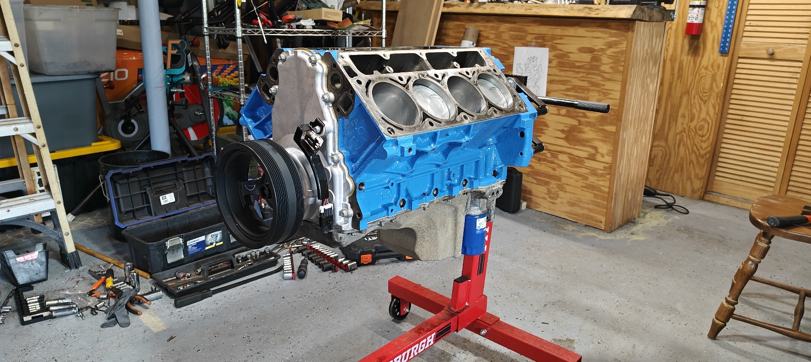

My favorite is when you forget to install a part because it was sitting in a box, inside another box, out of sight.... in this case the timing chain dampener. So off came the harmonic balancer, timing cover, oil pump & pickup tube, and timing chain & sprocket.
Added the part and buttoned it all back up while the workgroup VP rambled on in a Teams call about how we continue to set records, but that we also need to do more. He's definitely in touch with the shareholder's expectations. At least I'm getting paid to learn a new hobby. New progress was finally getting the oil pan & gasket installed, while explaining to the kids about how it's a big-brain move to replace your engine with one you've assembled in your basement before the one in your car expires.
Also emailed BBP about the logistics of getting a 6.0 tune to get this thing eventually firing/idling/running, and whether the LY6 or LMG injectors I have will be sufficient for a Truck Norris clone cam. (god I hope so)
