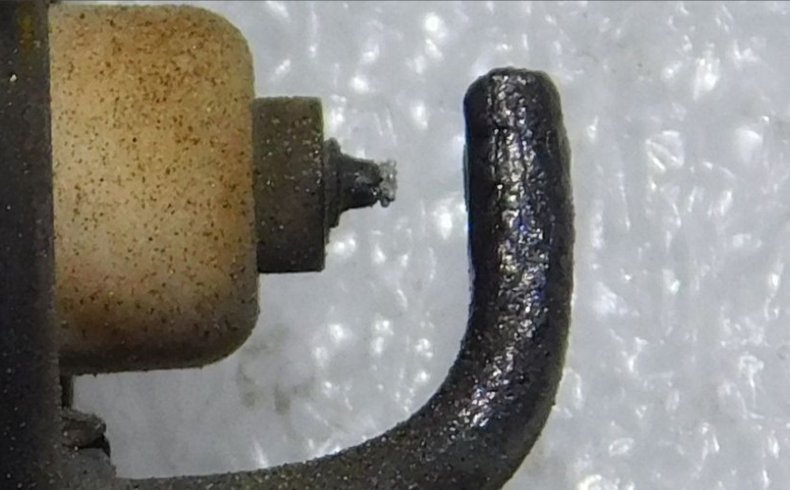

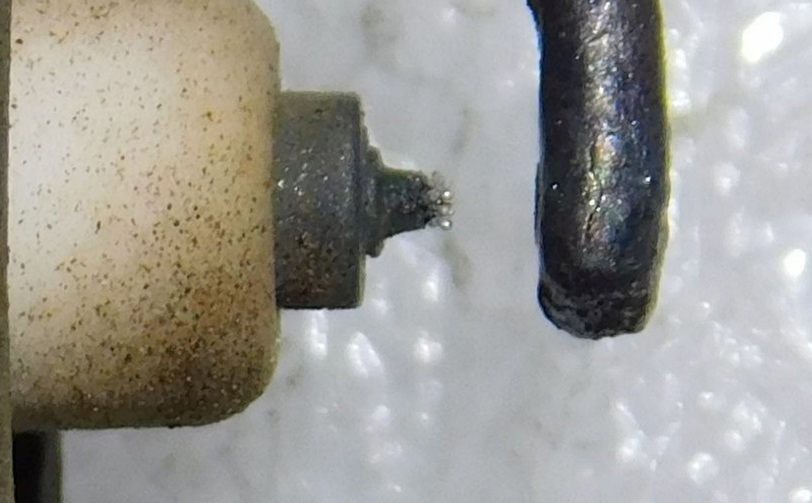

didn't look that close lol, already put it back in
here is a couple more zoomed in
View attachment 431145View attachment 431146
hopefully someone else knows better, I think I was confused carbon tracking with peppering. peppering is the specks, which can be conductive and cause a miss, carbon tracking is usually on the oitside part of the plug.
as for the tip, I have no idea what that is. could be iridium that's had a hard life with some ping?
30,574
48,067
Is that balls of aluminum on the center electrode in that top pic
appears so.......Additionally, on the ceramic there may be specks of material. The two most common types are pepper specks and shiny balls. They show detonation, but the pepper specks also can mean a slight oil-control problem. The specks will attach themselves to the ceramic and the outer shell of the plug. The shiny balls are tiny pieces of aluminum from the top of the piston. Similar to the side electrode, the ceramic also should have a ring around it. This is called the fuel ring. It should be a brown-gray color and half-way up the height of the ceramic. If its too deep on the ceramic, the chamber is again too hot. If its too close to the electrode, the chamber is too cold.

when I get up in the morning I will try swapping plugs 3 & 7 and see what 7 looks like and see if the missfire follows the plug

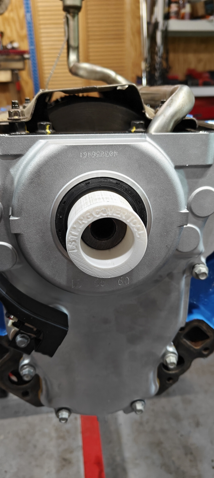

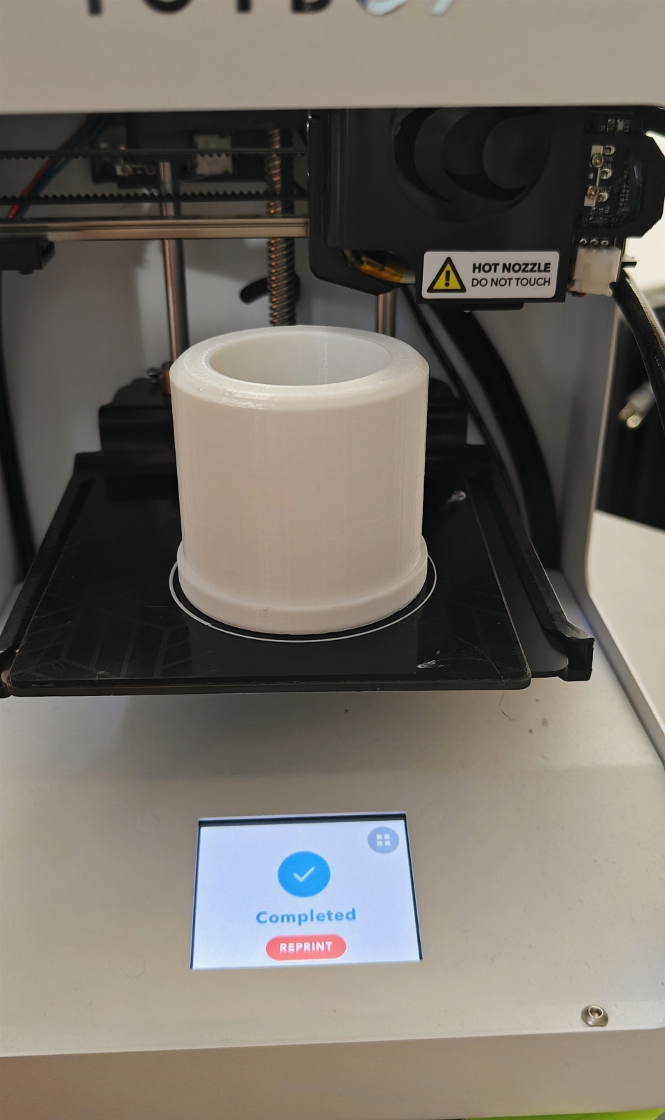

Made a thing to center the front timing cover. The kids don't use their little toy 3D printer, so I fired it up with a ThingVerse .stl, and made the overpriced tool for free.
View attachment 431061View attachment 431062
EDIT: Also, the new harmonic balancer just arrived. Now I'm just waiting on the oil pickup tube clamp to button up the front of the engine.
Yup, what I thought.
You can also use the discolored area on the ground strap and center electrode to determine the correct heat range plug. It's basically how far the plug sticks into the combustion chamber.

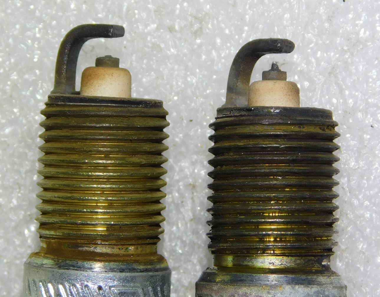

4 on the left and 7 on the right, no little ballz on 4 but the inner electrode tip is much shorter

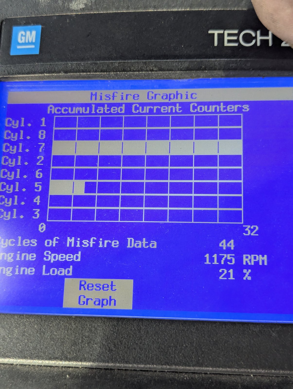

so could this be caused be a faulty lifter? that's what I am wondering or if it is just detonation, maybe I need a injector balance? I don't know, the fact that doing a crank relearn made a bunch of misfires go away makes me think maybe the crank sensor has been out of wack or needs to be replaced?
I'm pretty sure that plug on the left is toast. the special metal, I don't know if you're running platinum or iridium, but whatever was there is gone.
they do have some miles on them, probably best to start over with new set and check on them randomly to get a feeling how the engine is running.
from those I'd say you need higher octane fuel or give up some hp with a safer tune.
maybe send the pics to black baer?
Ya I'm going to reach out to BB dropping it off at the shop today so they can do a deeper dive and see if anything pops up for causing the difference in bank 1 and bank 2 getting new plugs minimum.

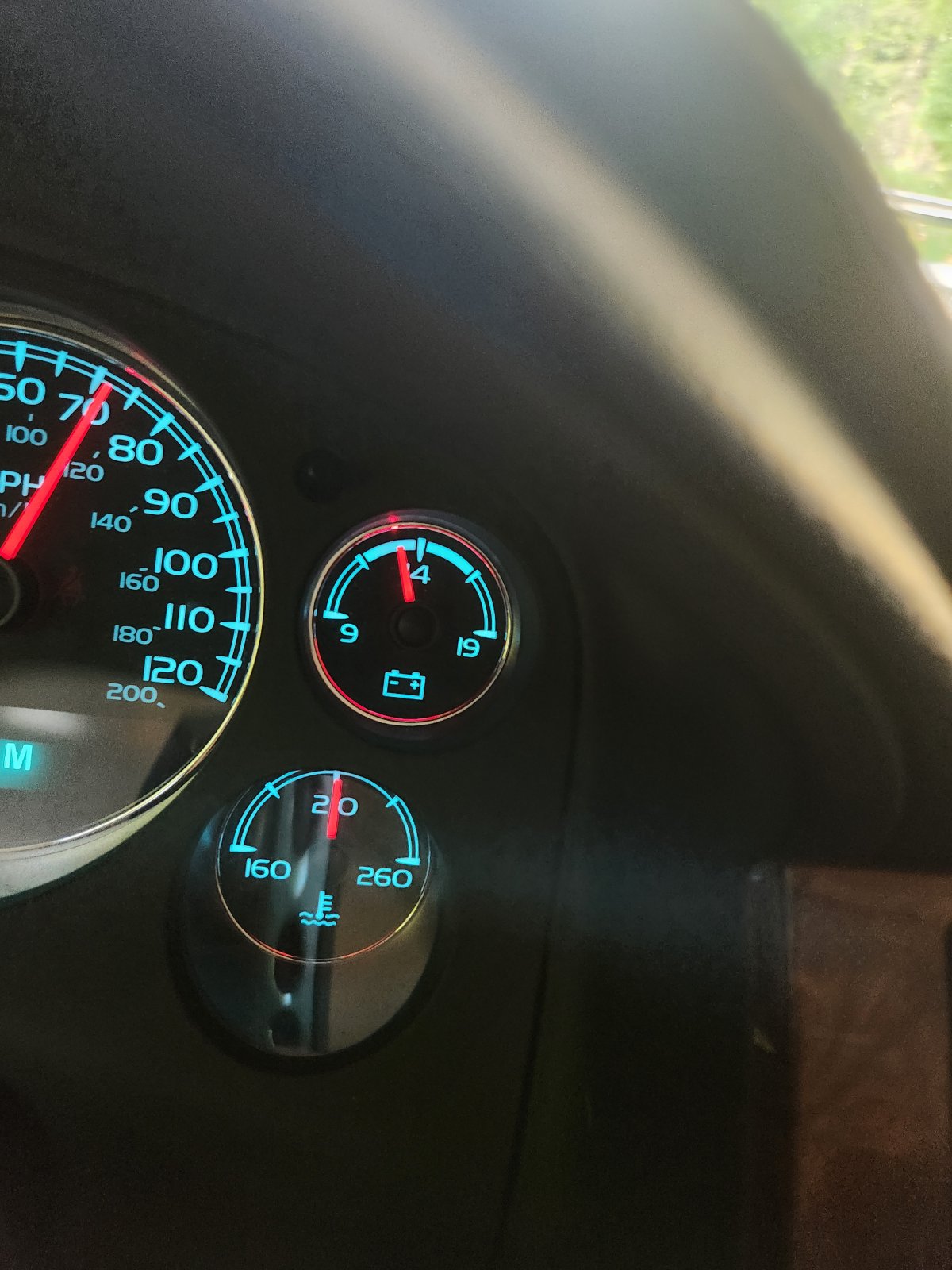

You're right NAPA batteries do suck. Walmart AGM here I come.
is it giving you problems? that voltage doesn't look bad it's not going to park on 14v all the time, the gmt800's without rvc would but not these trucks, although a "new" battery shouldn't wiggle around as much as a older battery will
My last one was always at 15-16
