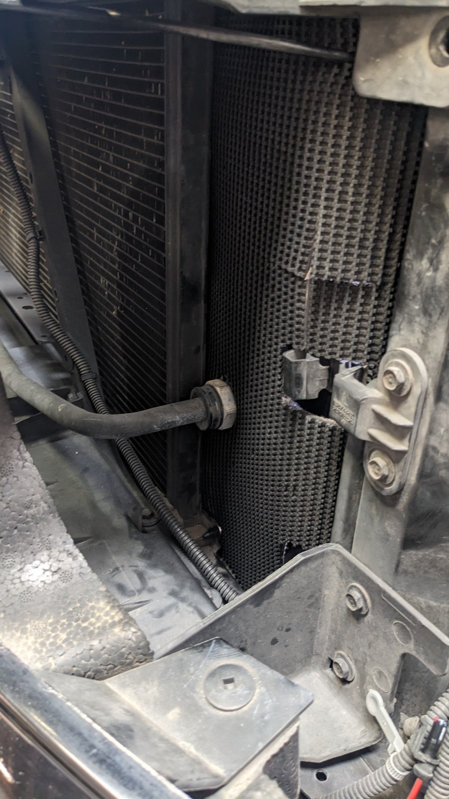

on the radiator baffle note, when I got it both were good. Just saw today the drivers side is ripped up falling apart. guess I need to do something with that too.

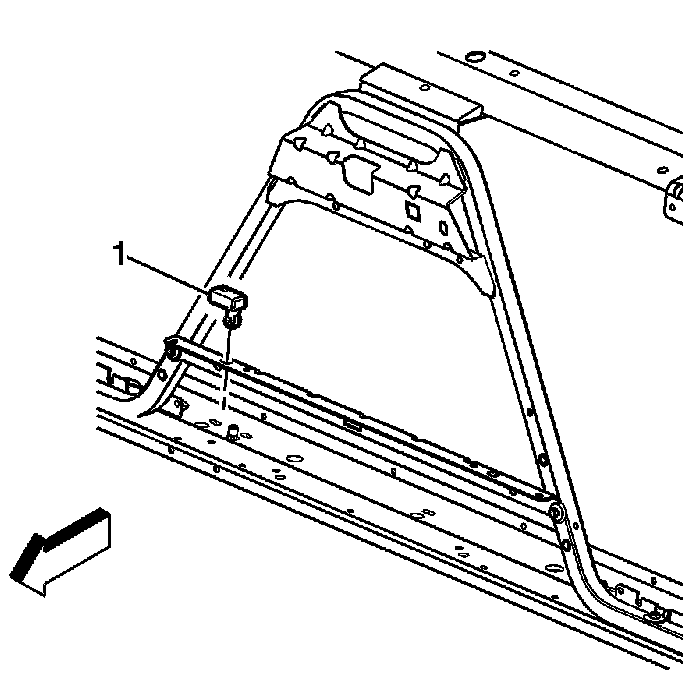

The outside temp sensor is in front of radiator on a little bracket more on the passenger side I believe..
Looks like it can be either driver or passenger side depending on options.

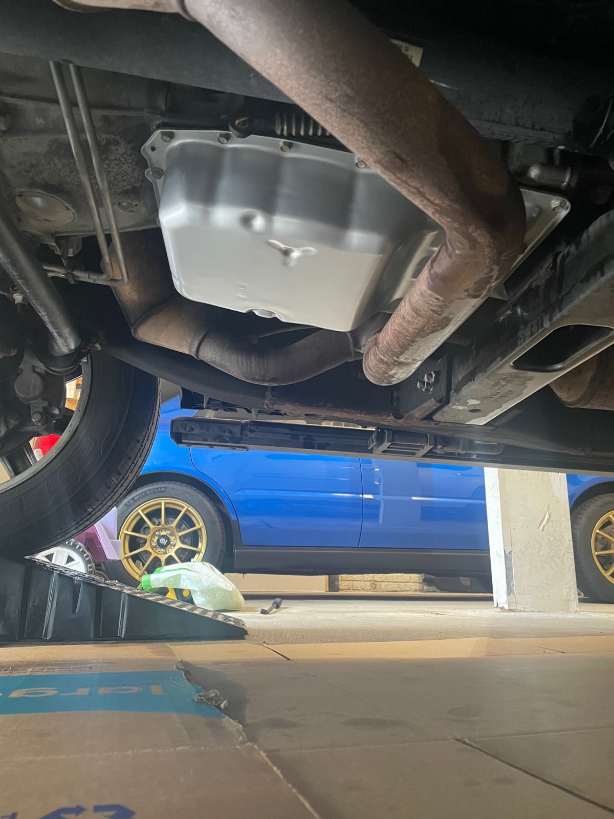

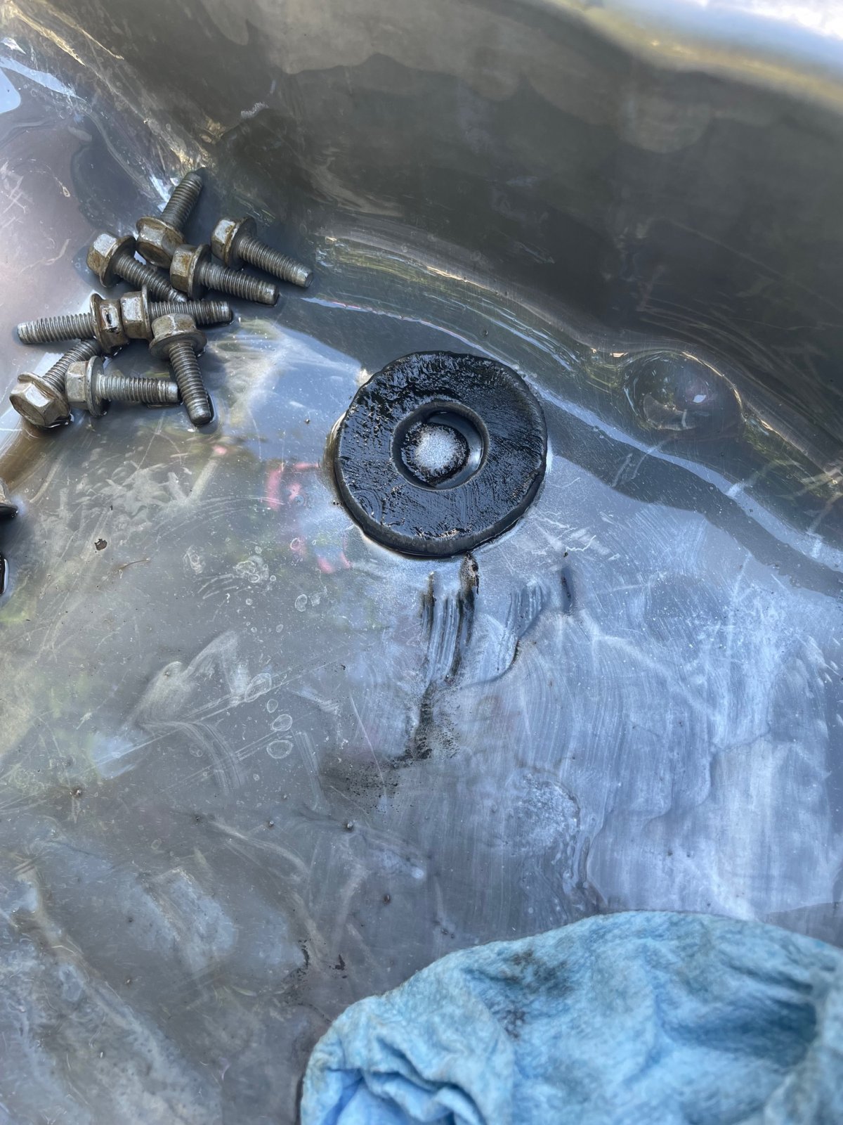

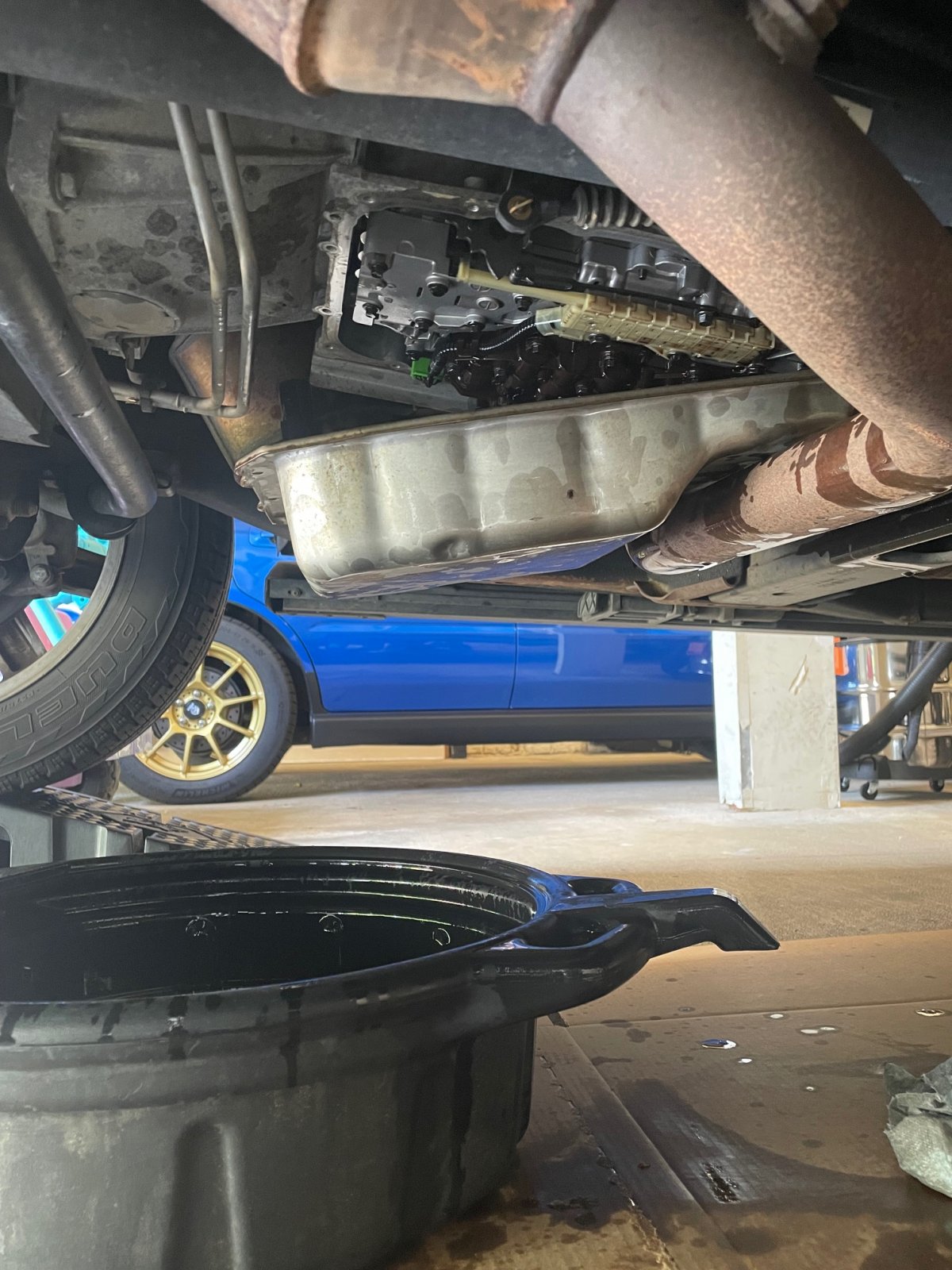

Changed the trans fluid on my '14 over the past ~24 hours. I was fairly clean until it came time to flex the exhaust pipe out the way to get the back end of the pan out LOL. I followed a YouTube video, but will note on my '14 I did not have to remove the shift cable linkage; it was not blocking access to any of the trans pan bolts.
18, 10mm bolts hold the pan on. I removed the gasket prior to fiddling with flexing the exhaust pipe slightly to slide the rear of the pan out.
I elected to not fool with the metal retainer ring that holds on the trans filter. I just pushed up in there my new one. I used the OEM ACDelco filter, fluid, and pan gasket.
Fluid had clearly been changed before by PO, as the magnet was quite clean (pic below) and the bolts + old gasket came off no troubles. Cleaned and painted the pan while off with Rustoleum Enamel spray can (silver).
On re-install, I found it easier to twist the pan up and into position, THEN I slipped the pan gasket through and on. The gasket on initially with pan was too thick to get past the exhaust piping. I got about 5.5 quarts + whatever residual in old filter (so nearly 6?), out of the system by doing this.

I've found it helpful when dropping the pan to use an evacuator or fluids pump with the line ran down through the trans dipstick tube to suck out most of the fluid from the pan first.

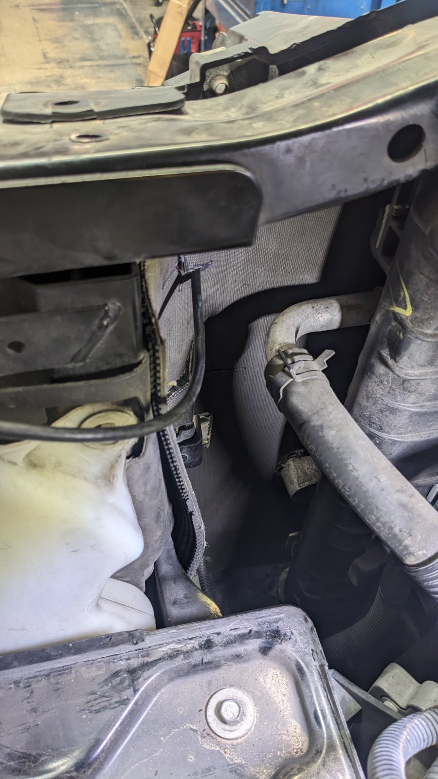

I had. completely forgotten the temp on the havc and dash are a crazy filtered one to avoid the showing the head soak numbers. this morning I checked and it was way different then the intake air Temps before starting it. later I found the ambient temp in the scanner. Will compare another day.
mine also has a 5/8 tranny hard line run 2 inch under it. so that seems silly haha, guess the non hybrids don't have that pipe there.

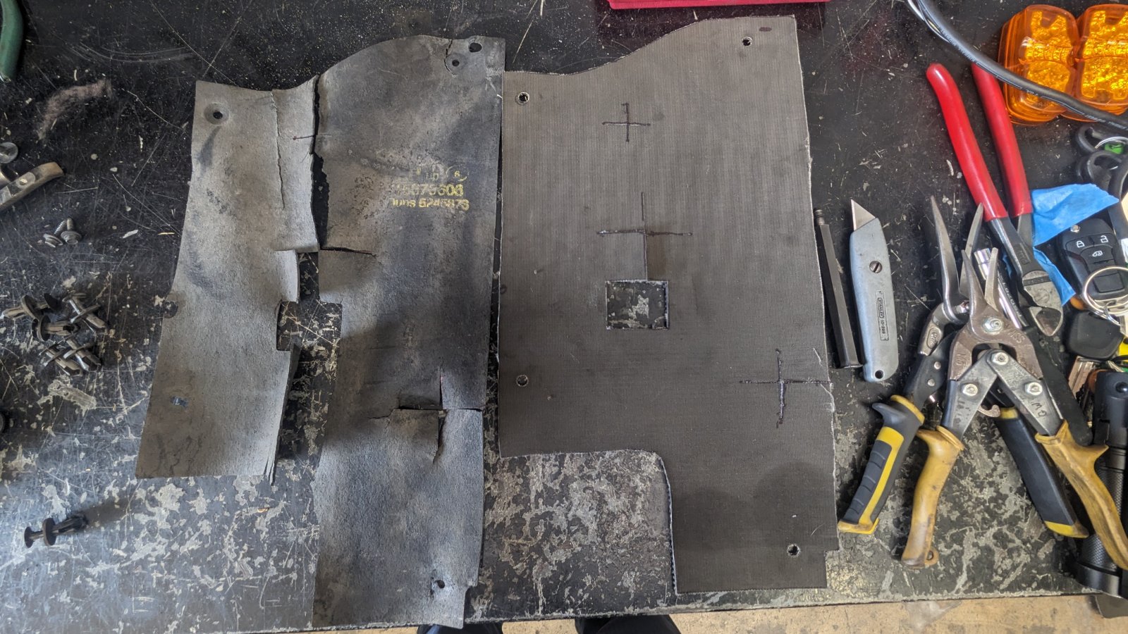

ended up make a new driver side baffle. kinda a hassle, I should have just pulled the headlight and battery first. would have been faster.

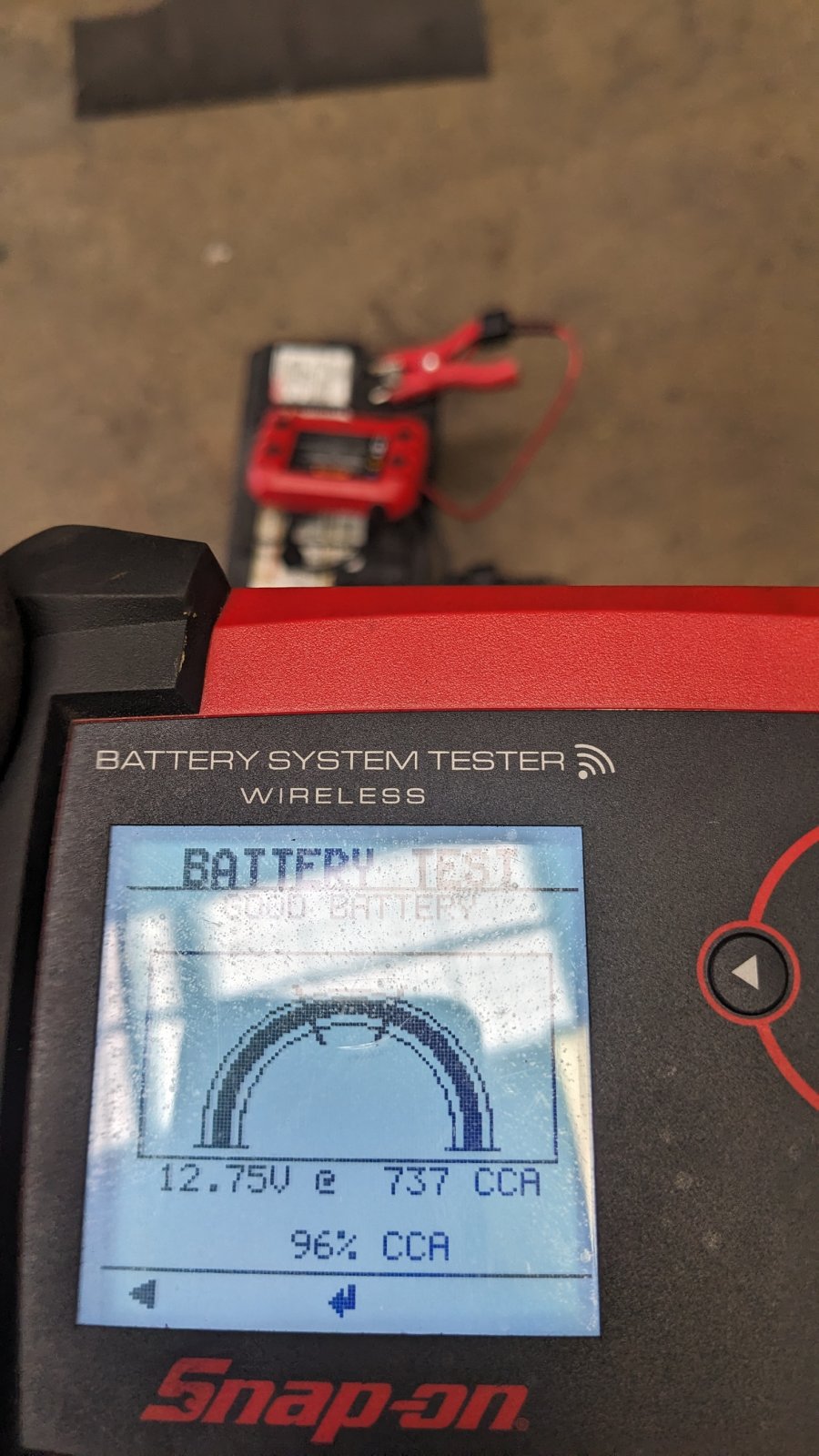

while out I load checked my 2 year old Delco agm 760cca battery, still tested at 737. so I guess it's doing OK with the flooded charge routine. it's only a 36 month battery.

I need to remake my baffles. It never really gets hot enough here to matter, but I'm sure it would be better.

Made mine out of this sh*t. Works good. I think @Sparksalot did too.
