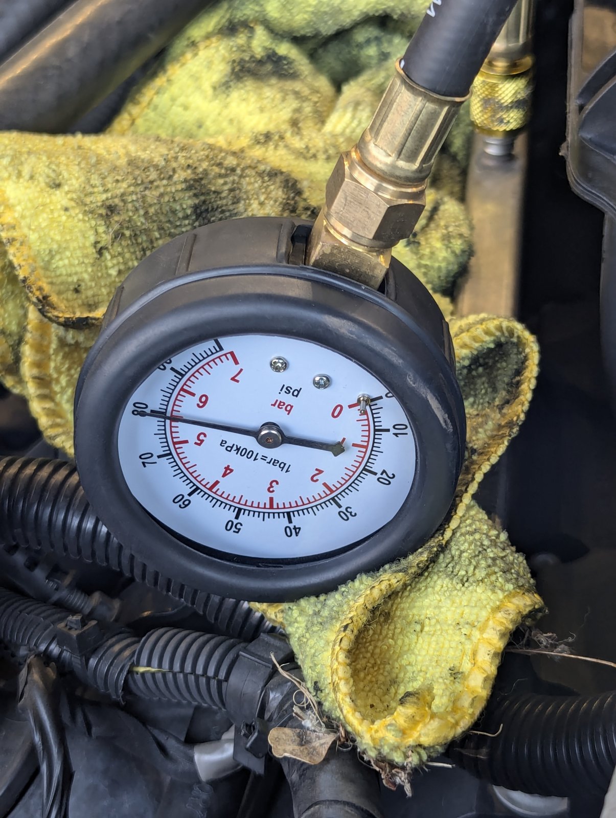

I guess I'll presume the rise is due to heat and being a closed system no restart issues at all anytime
I know its different but I think we have the same fuel pump module? mine the fuel pressure spikes like that any time the truck shuts off. I found it odd too, especially since it stops and starts non stop, you'd think 70+ psi would mess with the starting fuel.
if I remember right you have a tech 2? under fuel can you watch the target fuel pressure and actual psi and compare to your gauge?
since these aren't old school vacuum biased regulators, I honestly don't know what it should do when you Rev it quickly. I would think increase as that's what older return systems do, not decrease but since it's a pwm dead head setup. maybe there's a lag in the pwm before it can ramp up speed to match demand from a big pump shot? Hopefully you can see something useful with the requested fuel pressure.
if you can tape that gauge to the windshield and go for a drive a quick wot pull will tell you of the pump can keep up. I've done that a lot

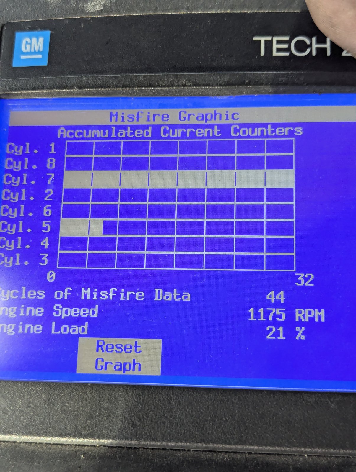

Been doing some testing replaced the rear 02 sensors and swapped in a known good maf, misfires increased???? Did a crank relearn misfires decreased and now I just get a couple on 5 & 7 which is the noisy side, swapped coil 7&1 no change, checked fuel pressure prestart is normal around 55 running it's around 43 but drops and increases 30-50 if I rev it fast. Seems like it should stay pretty stable but not sure.
And what's strange to me is after I shut if off fuel pressure increases (slowly) up to about 82 and after a few minutes it has dropped about 5 psi so it's sitting on around 77 now is that normal?
I'm think I'm looking at bank 1 lifters at minimum going to call the dealer in the morning and see what they would charge me generally they are pretty fair with me since I have been going there for 30 years the service manager has historically been more than fair with me. But if the cam is fkd I don't know. I think it needs a deeper look I reset the ecm, relearned the crank, maf, 02 sensors, swapped coils. I don't have the time to tear it down and with my luck bolts will break and that's a headache I don't want to deal with.
I think that makes sense. Just heat soak.

not deleted has been turned off though, I don't think it is the plugs or wires they have around 50k on them and the misfires that were happening on basically every cyl cleared up to to bank 1 only after the crank relearn. I can hear it making some noise on bank 1 more pronounced at about 1100rpm which is when the misfires start, should have had addressed it 6 months ago but the noise was pretty light and intermittent
at idle there are no misfires and at higher rpm they pretty much go away as well.
i can pull #7 later and take a look but I don't expect to find any plug issue, that would be dumb luck

not sure it would help you diagnosed it but be interesting to put the timing retard pid up to view. the knock sensors pick up mechanical stuff a pretty well, might show you something if you're getting a ton of retarded timing. especially under light load that shouldn't have any real knock.

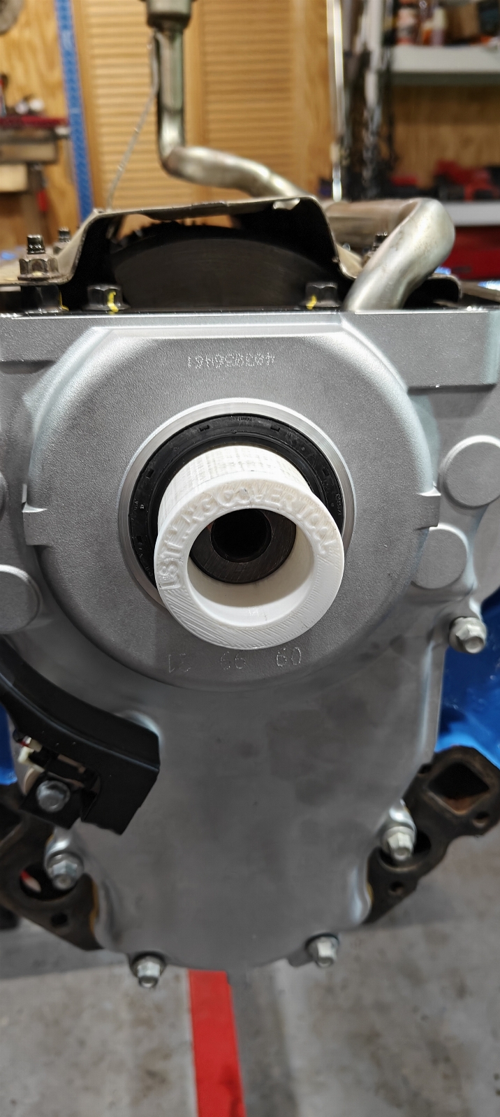

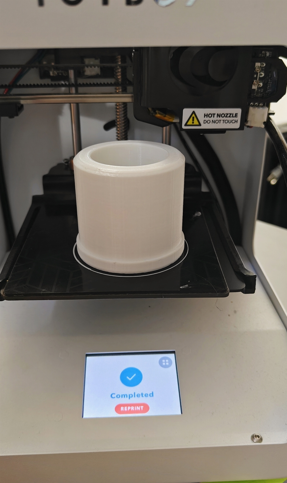

Made a thing to center the front timing cover. The kids don't use their little toy 3D printer, so I fired it up with a ThingVerse .stl, and made the overpriced tool for free.
EDIT: Also, the new harmonic balancer just arrived. Now I'm just waiting on the oil pickup tube clamp to button up the front of the engine.

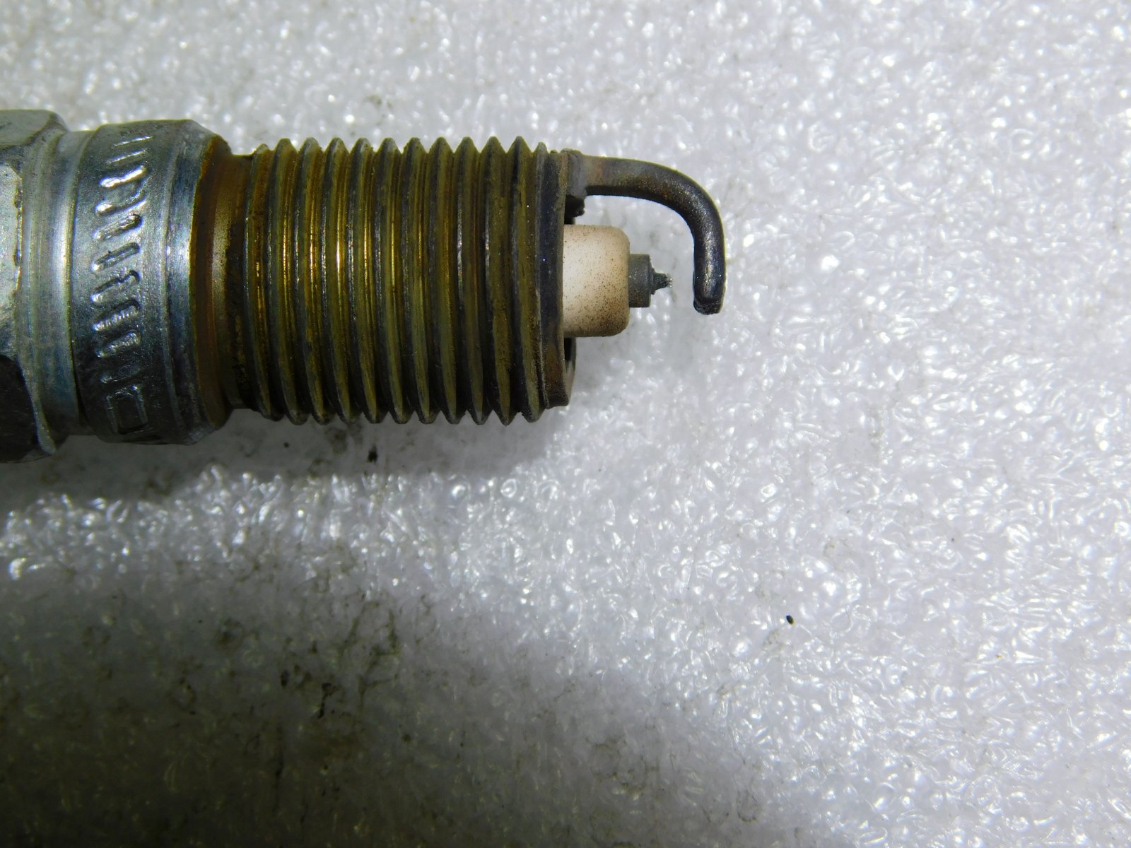

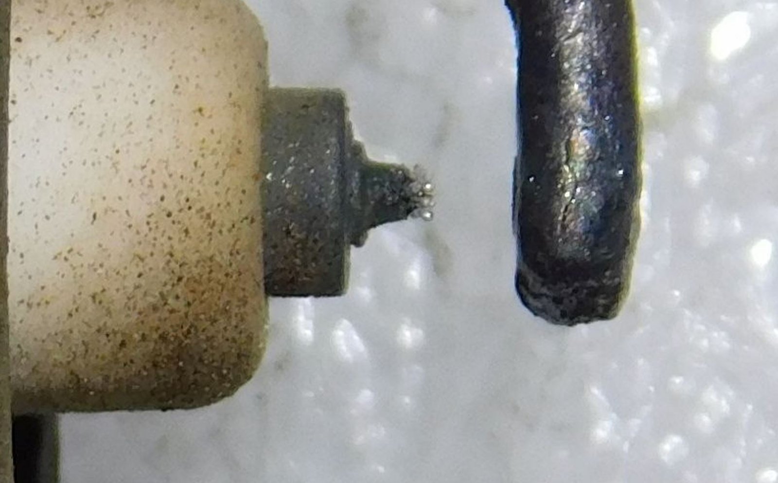

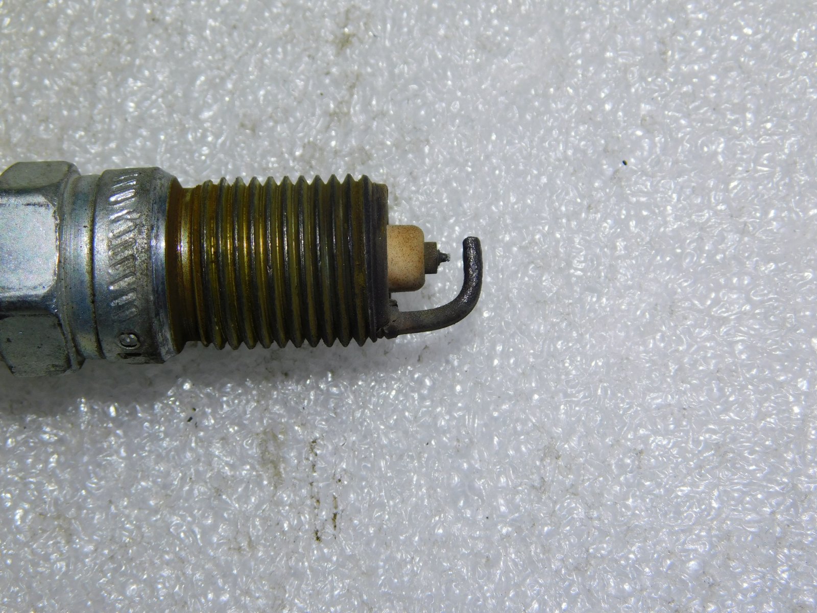

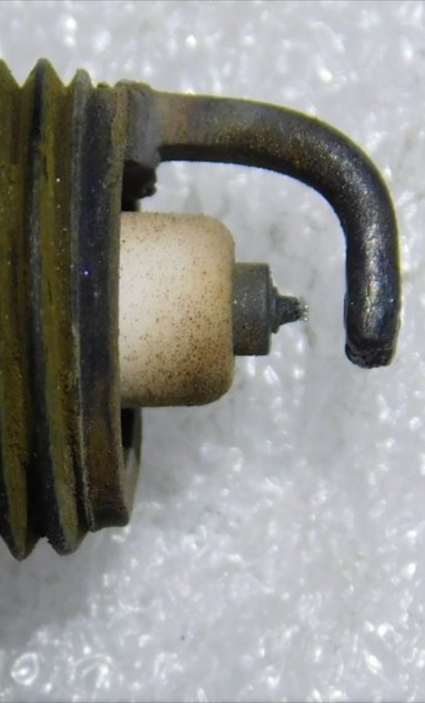

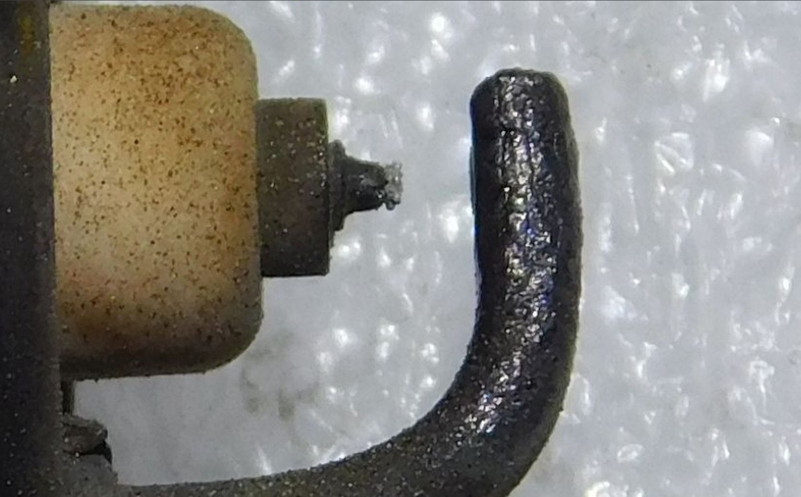

@donjetman I'm sure is way better at reading plugs than me.. there's an art to it.
but all this specking might be a thing and lead to what I believe they call carbon tracking? basically the plug shorts from the deposits on it so it doesn't arc right. I've done it myself but it was a decent amount of pinging that caused mine.
if it was mine, I'd throw a cheap 3$ plug in it from a local auto parts store just incase. probably nothing but maybe. might even try an autolight of all things haha. there was a thread years about about false knock on a diy tuning board. 2 years long and at the end someone random said try an auto light and damned if that didn't cut the knock rate in half for no good reason.
didn't look that close lol, already put it back in
here is a couple more zoomed in
