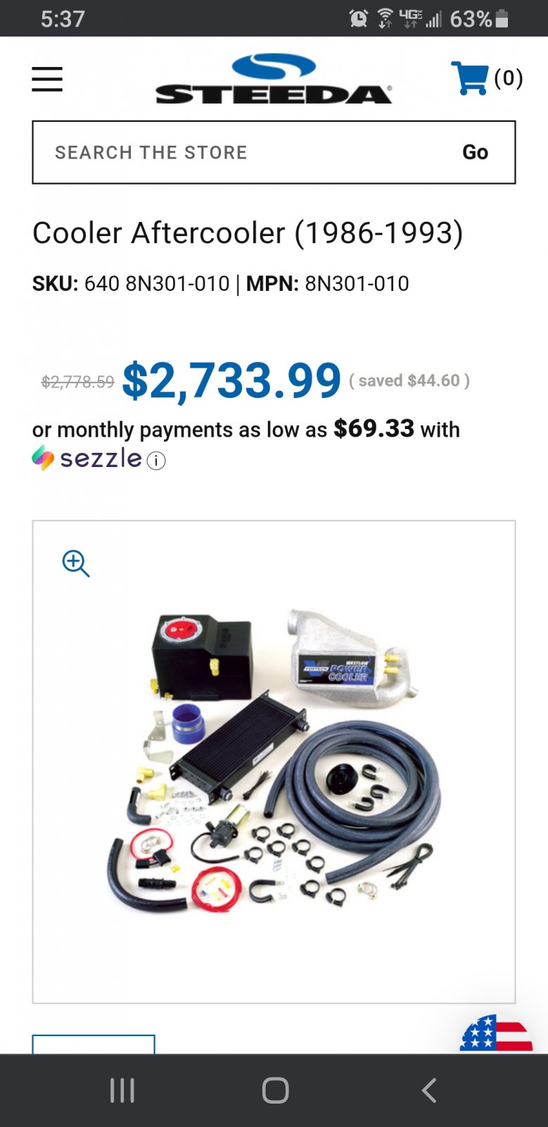

not thst meth isn't better in every way but didn't they sell a air to water cooler for the votech fox body kit years ago. I think they called it an after cooler?
seem to remember it worked pretty well and saved all that front mount routing

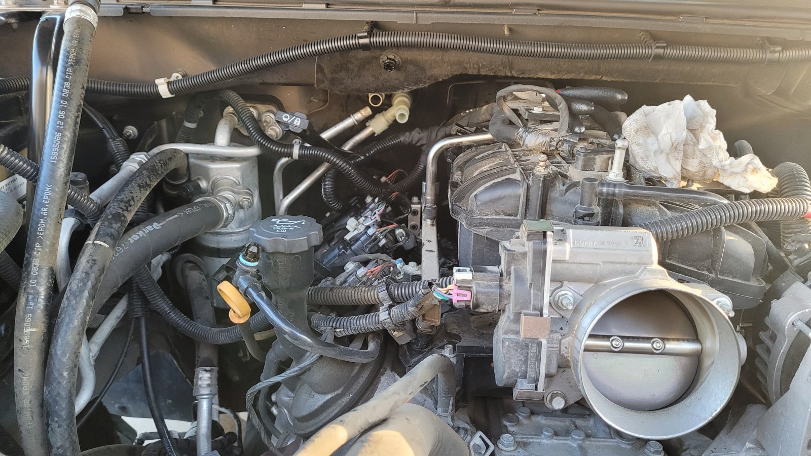

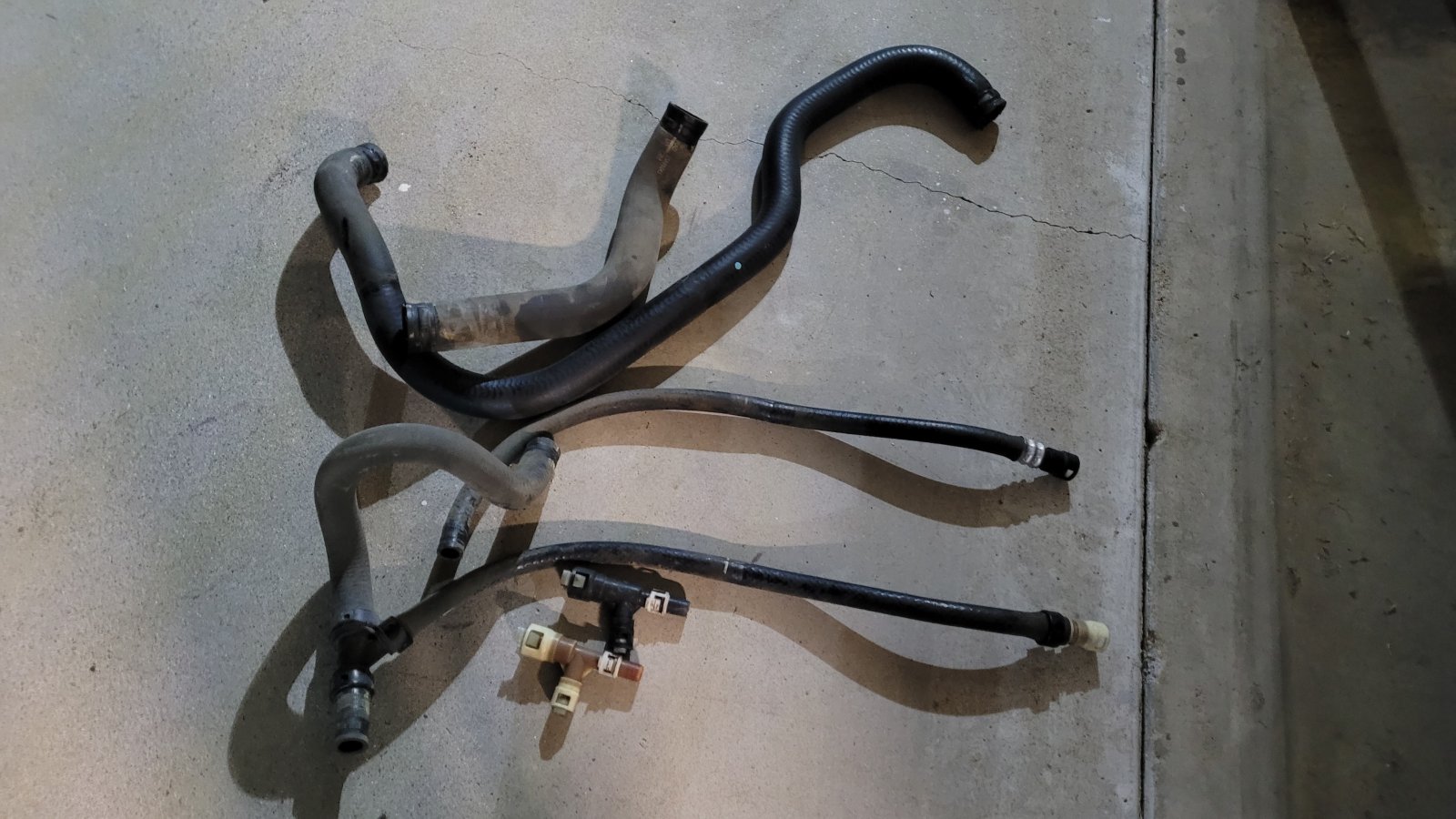

Not today, today, but late yesterday I replaced all of the heater hoses, both upper and lower radiator hoses and the thermostat.

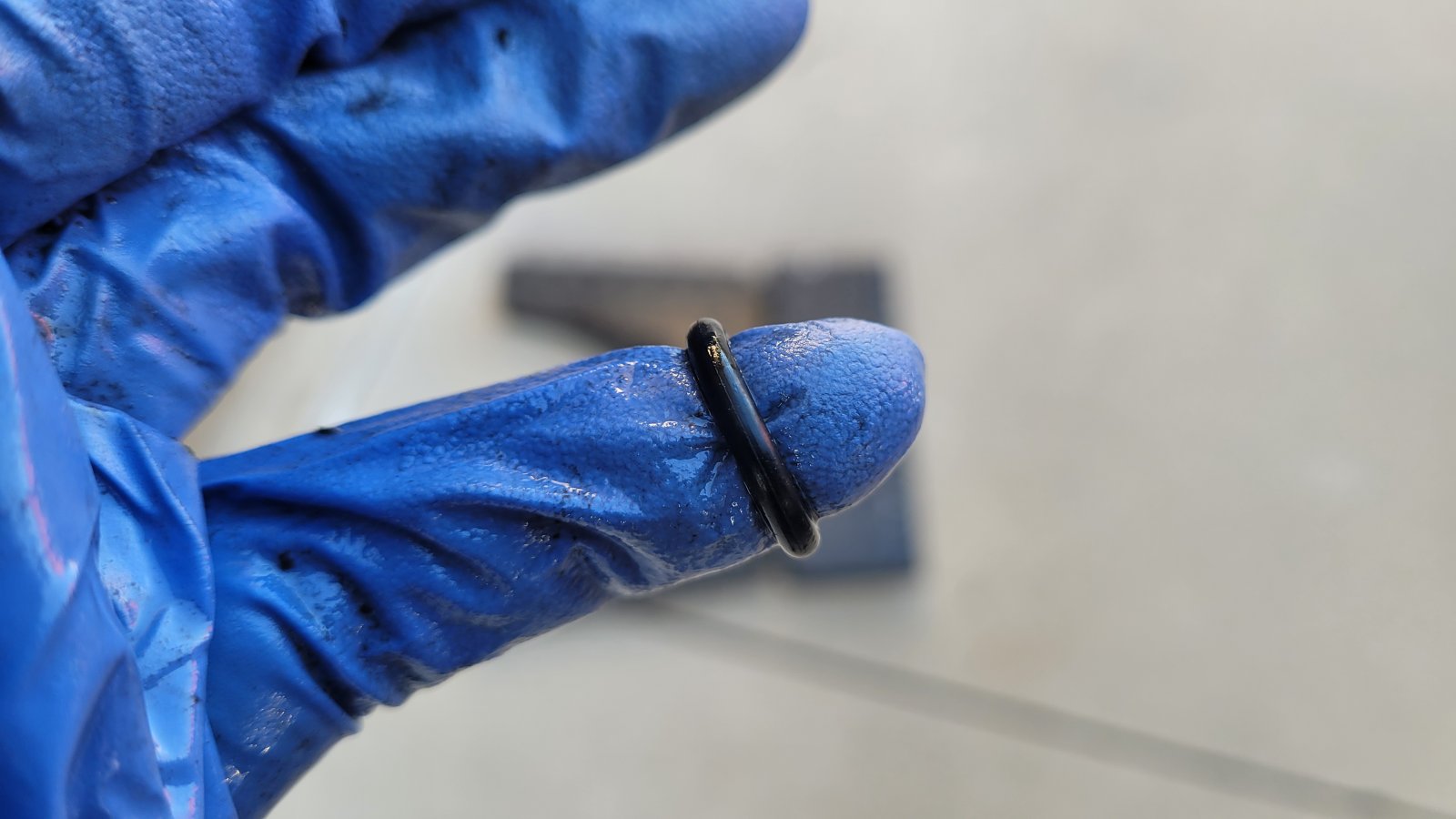

I removed each O ring from the T connectors and sprayed them with silicone so they would slide on easier.
Also, both T's had a slight mold ridge that ran the length of the nipple so I used my jeweler's files and removed the ridges.
As you can tell by the discoloration of the white T connector, it was done and was most likely ready to fail.
I got way more beat up that I had planned but it is done.
Oh yea, I also did a quick clean up on the throttle body since I was staring at it the whole time.
Yes they did/do. Very pricey kit though. My Snow meth kit was only like $200 back around 2007
