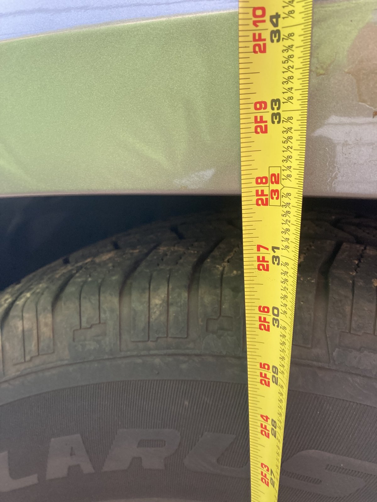

I flipped the struts back under the A arms with the Grade 9 hardware. No spacers. Dropped the front down another 2+". Camber is off but I used my home made toe plates to get her straight on toe. (Best thing I ever made, HUGE difference making fast toe adjustments.)
Test drive was very awesome. Also removed the front CV shafts and bolted the stub shafts back into the hubs. Previous fender measurement was 34" with the 2" drop spindles. Will see how she settles in and will work on the rear drop when time permits. Trying to make baby steps. I did some highway running and full lock turns in a parking lot at work. No rubbing so far. Will be ordering some shorter front sway bar links to bring that bar angle down a bit.

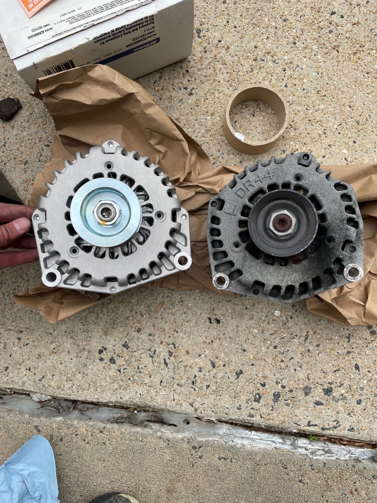

All - Appreciate the insight on the alternator incl. the potential for newer/higher amp rating ones! Ultimately however, given the potential upside should a problem arise during road tripping, I ended up going with the Carquest Premium 160-amp through Advance ($200 after the $10 core charge). Should I have kept my old one for $10? Lol yes, but alas, I did not :/
Installed the new one last weekend + replaced the AC belt (the prior one was starting to fray).
For $10 I would have kept the old if it was still in working order.
Also, is it just the color of the pulleys or does the new one have a larger pulley?

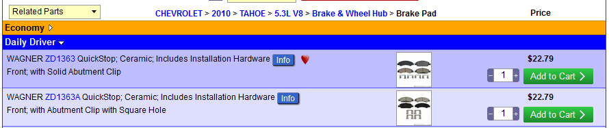

Looking at front brake pads on RA and noticed Wagner has ones that have solid abutment clips and clips with square holes. Why the difference and what years?
from what I recall I thnk someone mentioned there being some difference with the brake pads in 2007-2008, might only be certain models, that had a different caliper with a smaller pad mount (i think)
and that regular pads would not fit.
it's posted on the forum somewhere probably in this thread but it's been a while since it came up
might not be related at all but that's all I remember about brakes being any different, some kind of one off thing
I got a new, 'not reman' alternator. The new pulley is a solid aluminum, so it looks larger. Not steel.
@swathdiver might know
Good question. Came across the same issue while doing some research for the NNBS upgrade on my NBS, and I'm still wondering. Here's what RA shows for a 2010:
EDIT: Most hardware seems to be the solid clip; here's the difference (square hole on bottom pic):
on my previous brake pad change (on the 2012) I had bought some autozone pads, the clips that came with them would not stay on properly, I had to go back and pay another $10 for there generic clips, which fit and worked better, made no sense that they would sell different clips than what comes with the pads. Didn't really pay a lot of attention to the design difference but they worked and I re-used them for the most recent pad change, they were still like the upper picture but fit much better, like they were just slightly better quality.
