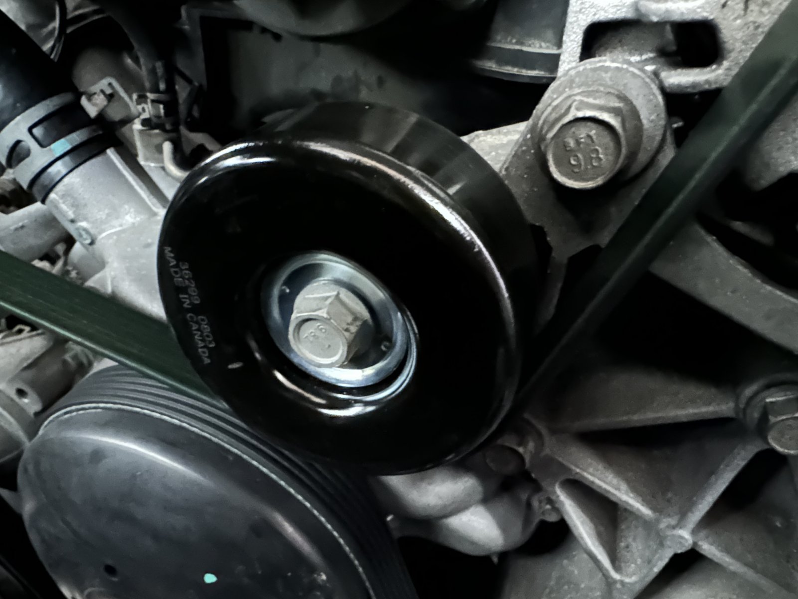

Got the new idler pulley on today and it solved the binding and noise I was hearing. Funny thing is the bearing on the old one felt okay when I was turning it by hand but it was definitely the problem. The new one was made in Canada.
I also installed an ICT Billet oil cooler block off plate on the ‘07. Hopefully that solves my oil leak problem. I drove it for a half hour or so and it seems to no longer be leaking. Time will tell.
Does the '07 not have an oil cooler?
Nope. The factory radiator didn't have the engine oil cooler built in either - only the trans cooler. Apparently it only became standard on later model year Denali's. I installed a new radiator last year that has both coolers, so next time I replace the motor mounts, I'll install engine oil cooler lines, too.

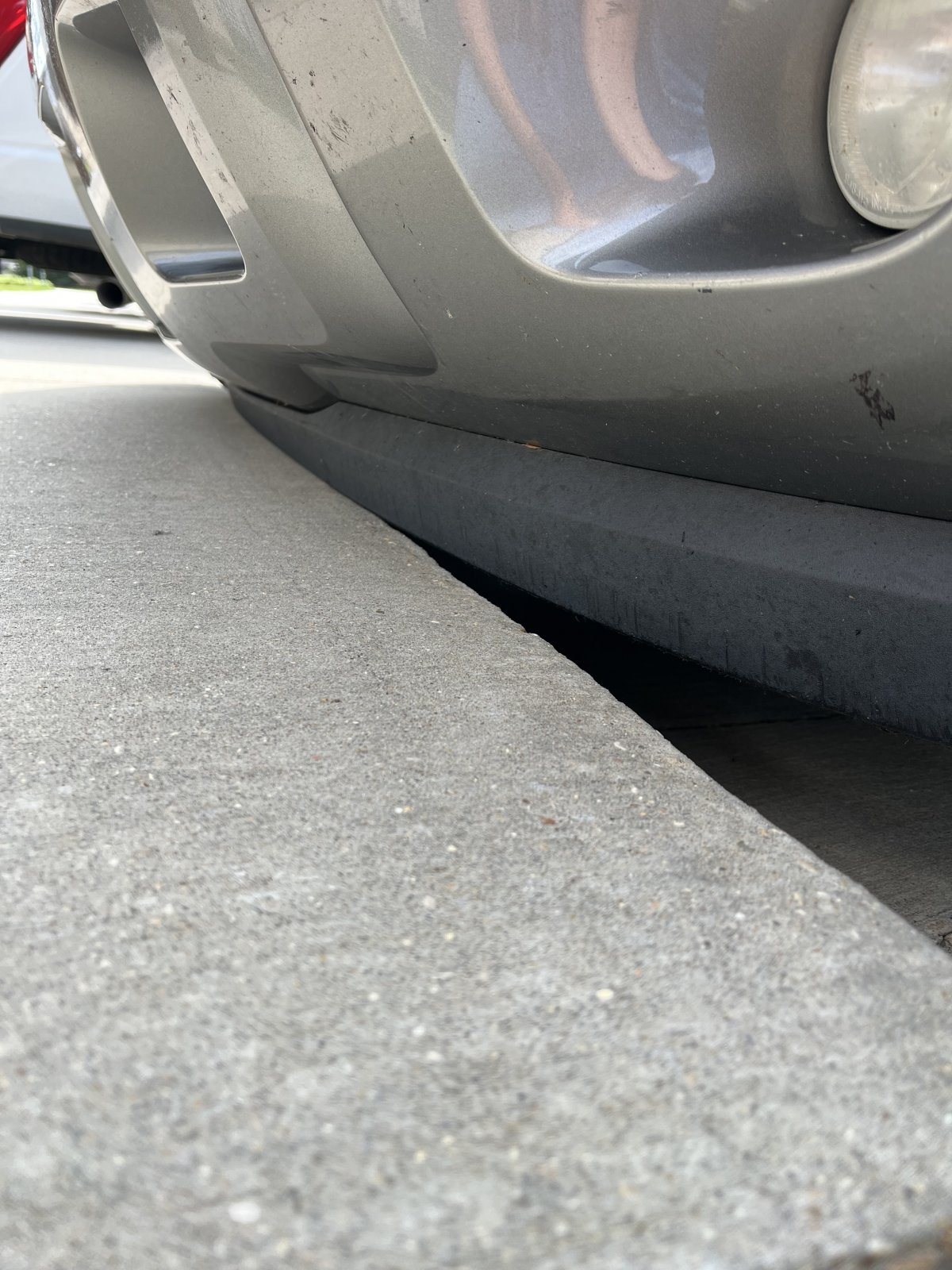

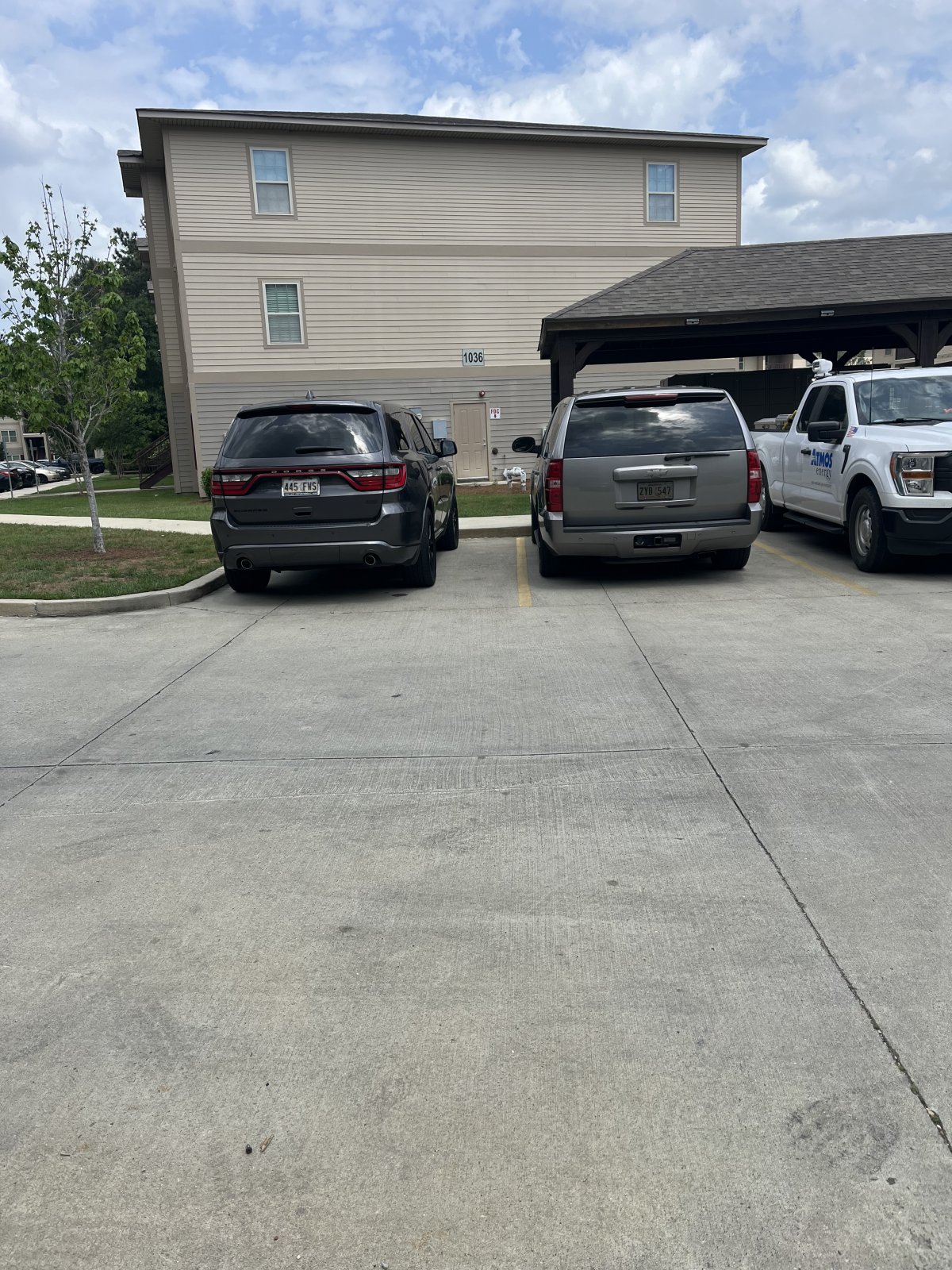

Drove it to my gf's apartment and parked next to her Durango. Durango is supposedly a mid-size but it looks barely any smaller than my Tahoe. Narrower, for sure:
Used it to sweep the dust off the curb:

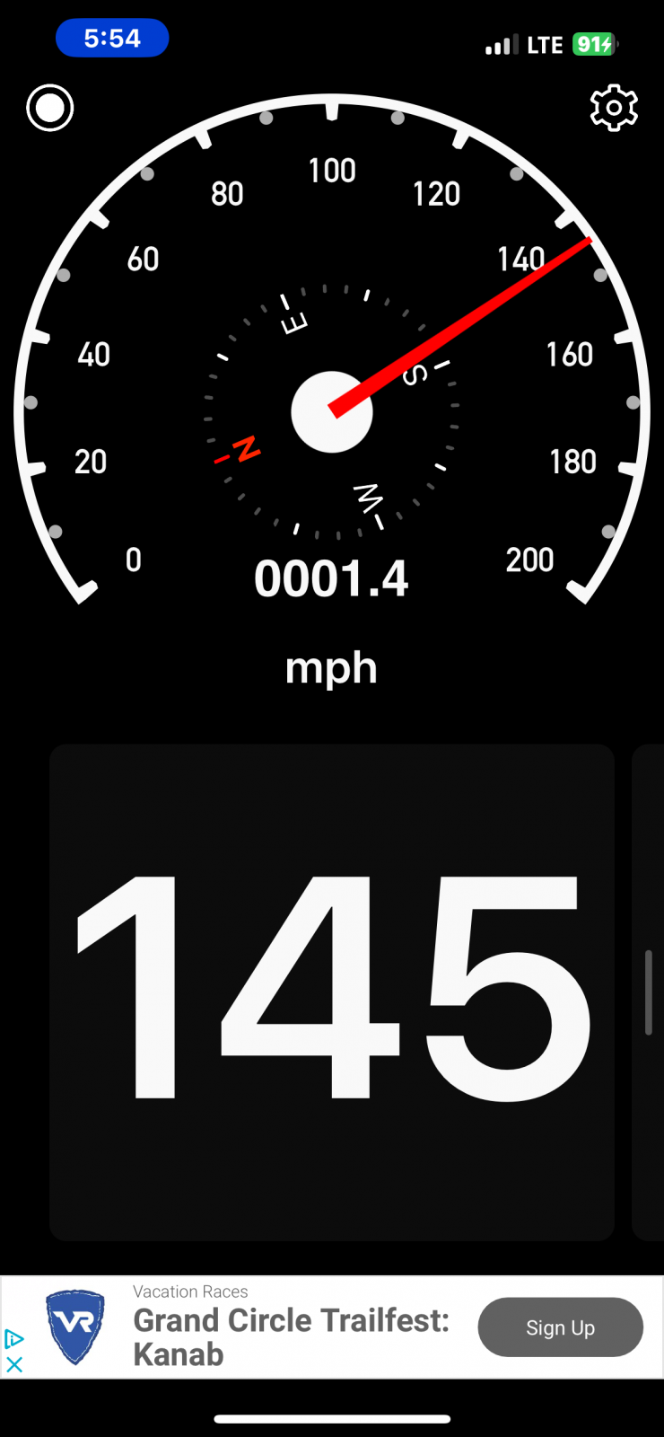

Wednesday evening, I downloaded the Speedometer app since my speedo only goes to 120. Then tested it:
Remember.... Stock tire treads are rated at certain speeds... But not for an extended amount of time. The damage may not show for a while.... factory treads are attached to the casing with heat, so heat will also loosed some of the adhesive.
( On the highway... when you see a tire tread.... most are from factory tires.)
Retreads are attached to the casing with a "cold-bond" adhesive, and fewer separate.
( Sometimes, the retread will separate a bit at the edges from the casing, but mostly limited to that)
Good point. I had to look it up- My Pirellis are rated to a maximum sustained 149MPH.
Interesting about the cold-versus-hot-bonded retreads.
