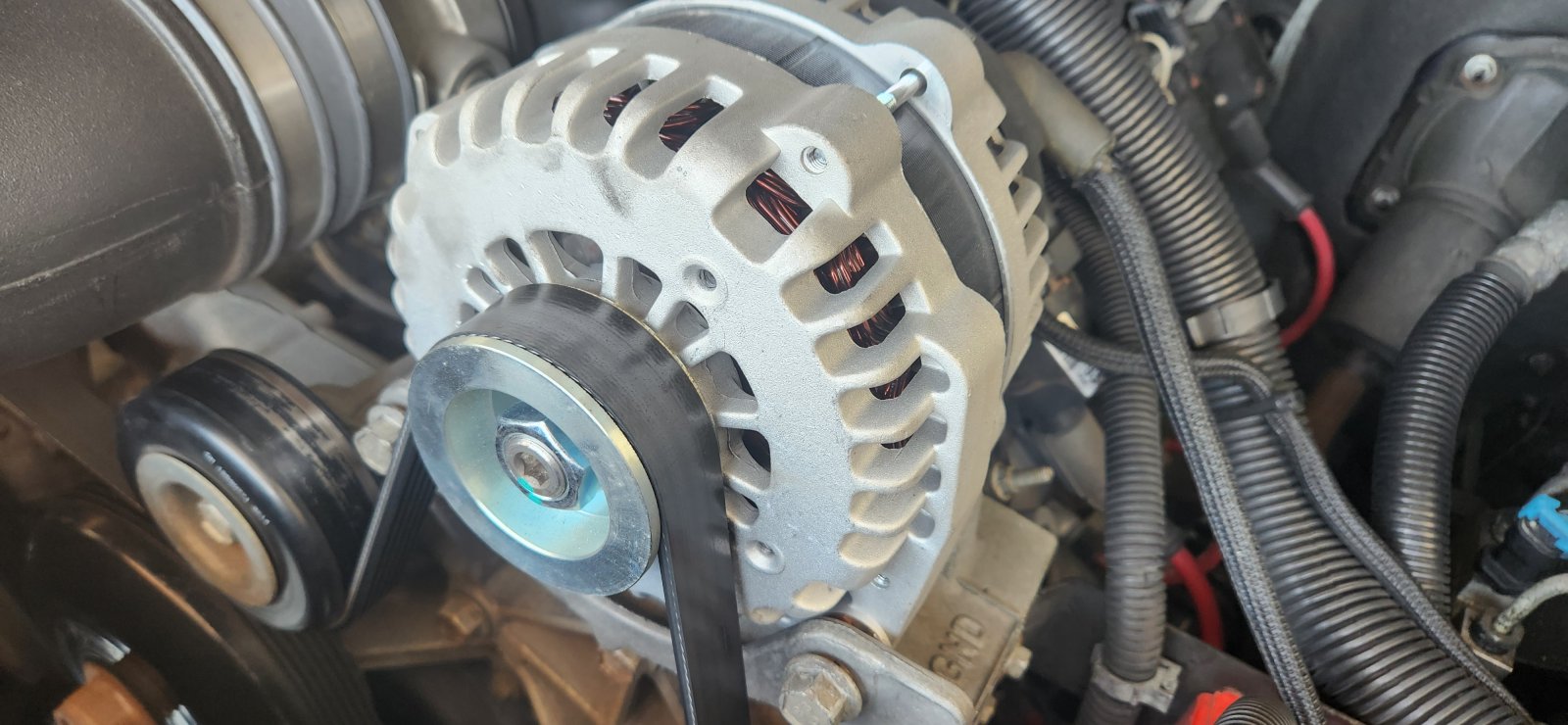

I replaced mine a couple years ago.... 'New- not a reman'..... AutoZone. Buying local is more convenient than online, if there is a glitch, it is replaced for life, in person.

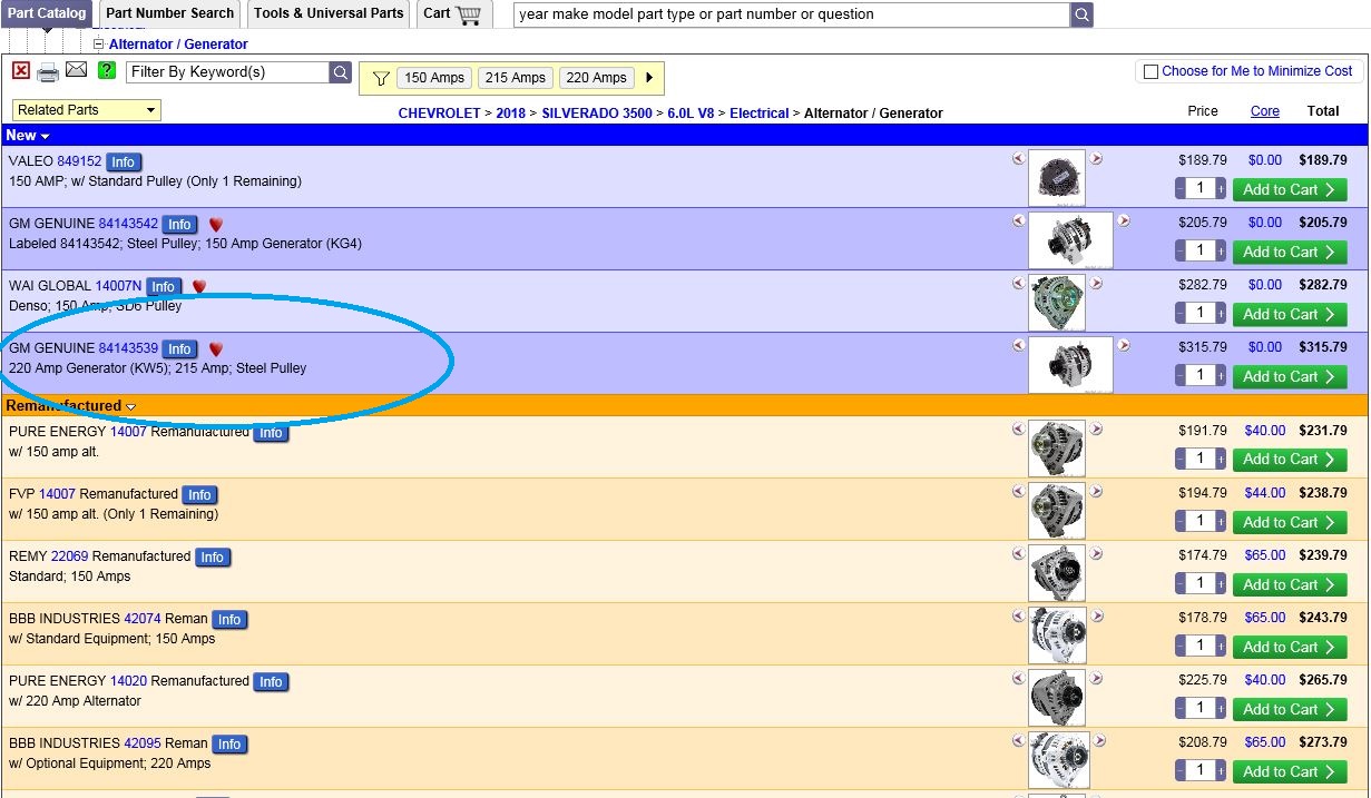

upgrade to the newer 220amp unit. you can get them off low mileage take offs on ebay for under 200$ and a direct bolt on unless you wanna be a bit extra. all the numbers to look for arw on iamdub built thread.
Like from the '21+ current gen? I see the below on RA from a 2021 for $153 (no core charge) wow good price. I'll search for the build thread you mentioned.
I wonder if the 170 amp units from the K2xx trucks would also directly fit on... I hadn't thought to look into either of these things, thanks!

This is a direct bolt on and is the new style with pressed diodes just like the mechan and other higher end alt.
it is oem on the chevy 3500 pickups (gas engine) just be sure it is a KW5 which indicates 220a
you can find them used on ebay reasonable, just have to shop around
