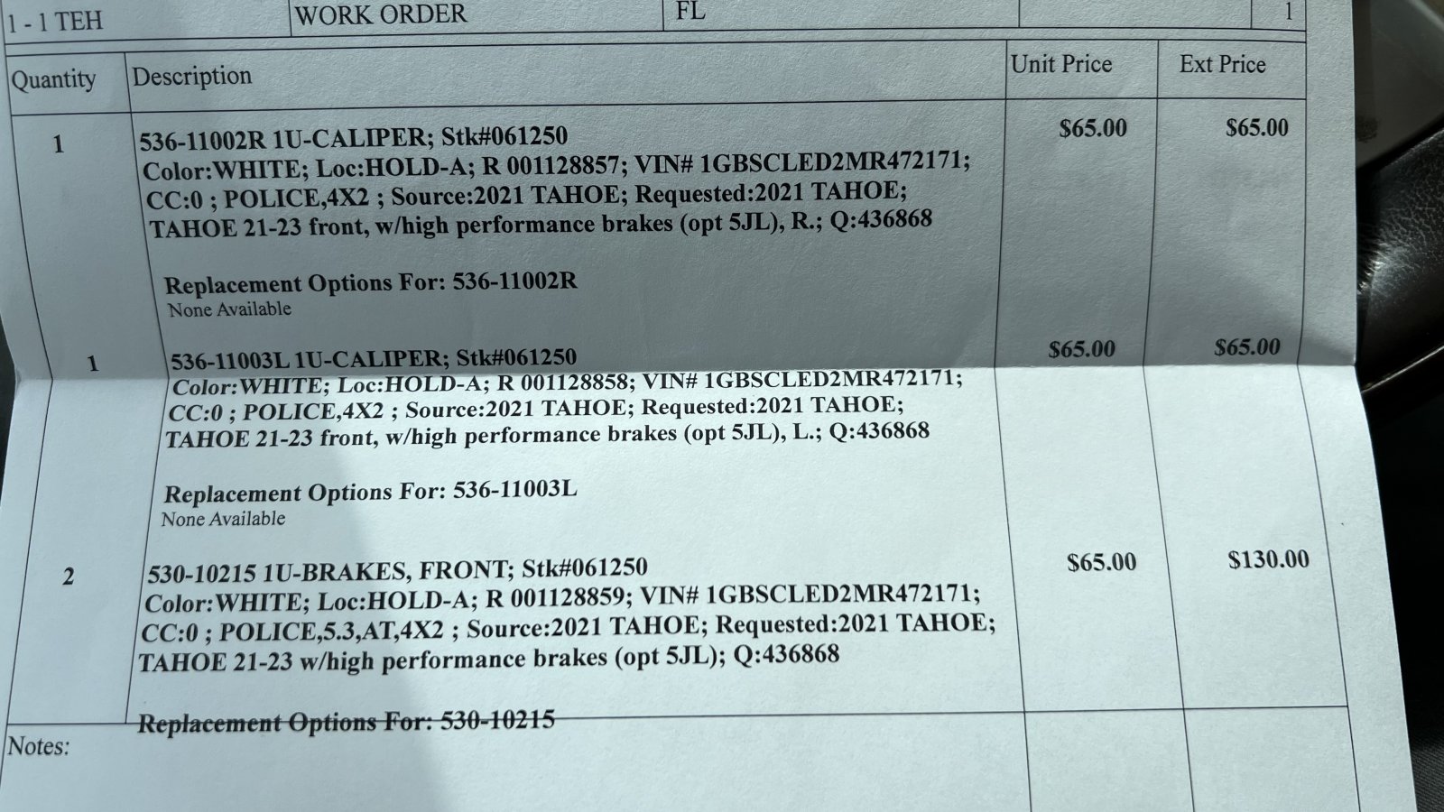

Welp boys I finally hit the jackpot after 3 years of searching. 6 piston PPV brakes at the junkyard. $278 total after tax for loaded calipers and rotors. They’ll have them pulled at some point next week

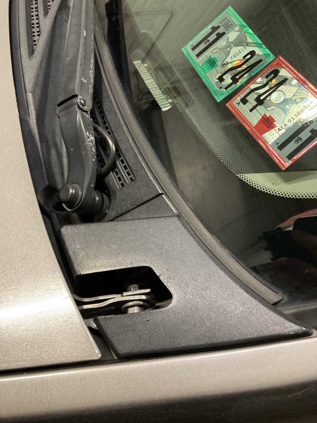

What if it is printed as one piece? Without the flappy part?
Sorry I wasn't clear. While multi-material 3D printing is possible, I was thinking of a single non-flexible part that replaces the OEM one. It would have a narrower slot in it than the rigid portion of the OEM part, but wider than the rubber part, to conform to the hinge without the need for the rubber bit. It would probably have to be sanded and painted if it were done with conventional FDM printing (what 99% of consumer/prosumer grade printers use). I don't know anyone with an SLS printer, or other technologies. Another alternative would be to use a 3rd-party, like Xometry, who has access to lots of high-end printing technologies that generate class A surfaces right out of the printer. When I get time (don't hold your breath), I might pop one out and reverse engineer something I could send to them for quotation. I'd bet an hour's pay they'd be cheaper than $70 each.
I follow you.

there's a guy that prints different car parts, mostly for older 3rd gens and stuff that's and discontinued, he somehow stumbled onto a setting that leaves a oem finish. that would. or. perfect for these.
like you said, the rubber isn't doing much. just a nice plastic part that fills the gap to look nicer.

@Fast_AT4 this something you may be capable of doing?
...what are we talking about here....looked back 2 pages and (glanced over them to be honest)....and didnt note anything. #ImBlindMaybe
good question I don't recall if it even ever touches anything, but I would guess it has to do with heat, all plastic might deform like a vinyl record in the sun
I 3d printed a fender badge for my F250 in PLA+ and had it in the Florida sun for 3 years w/o any deforming.

If I find my old one's I will send them to you to scan or whatever but I might have tossed them
and they are end caps for the hood hinges where the wiper motor shroud is on the gmt900's

Deez things.
