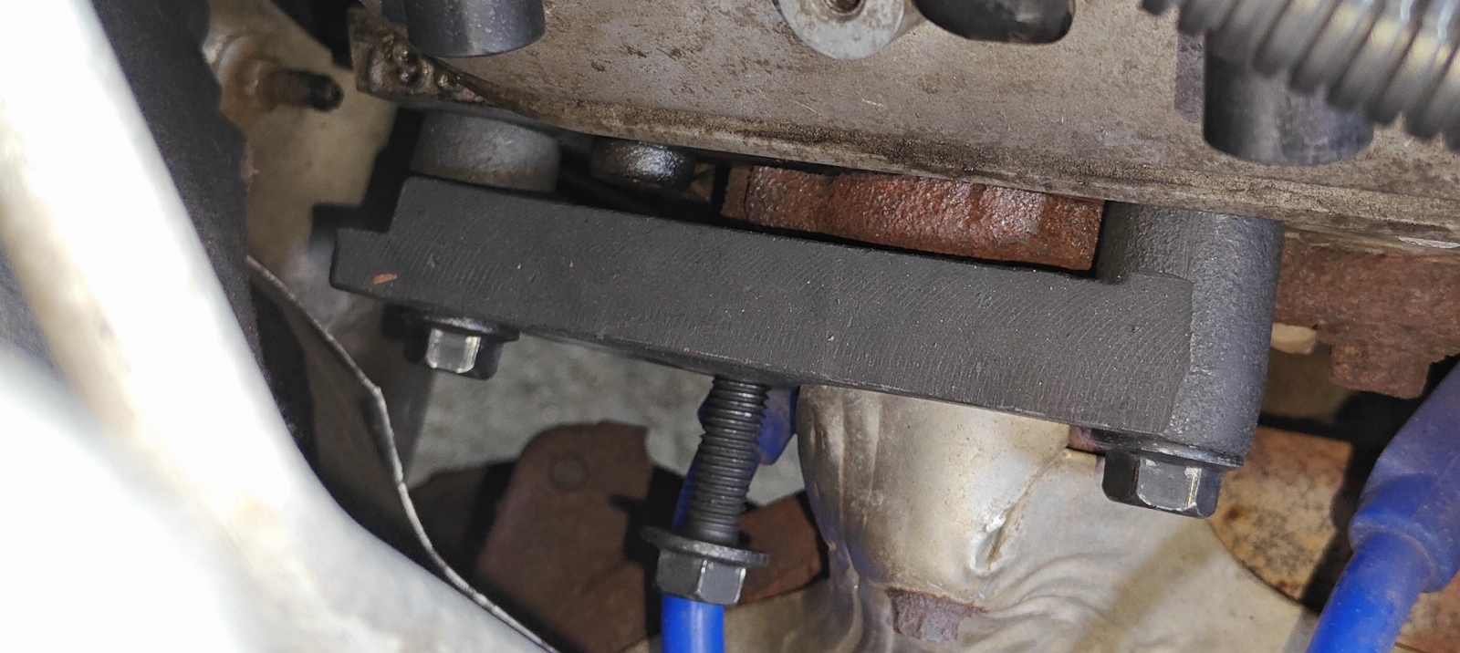

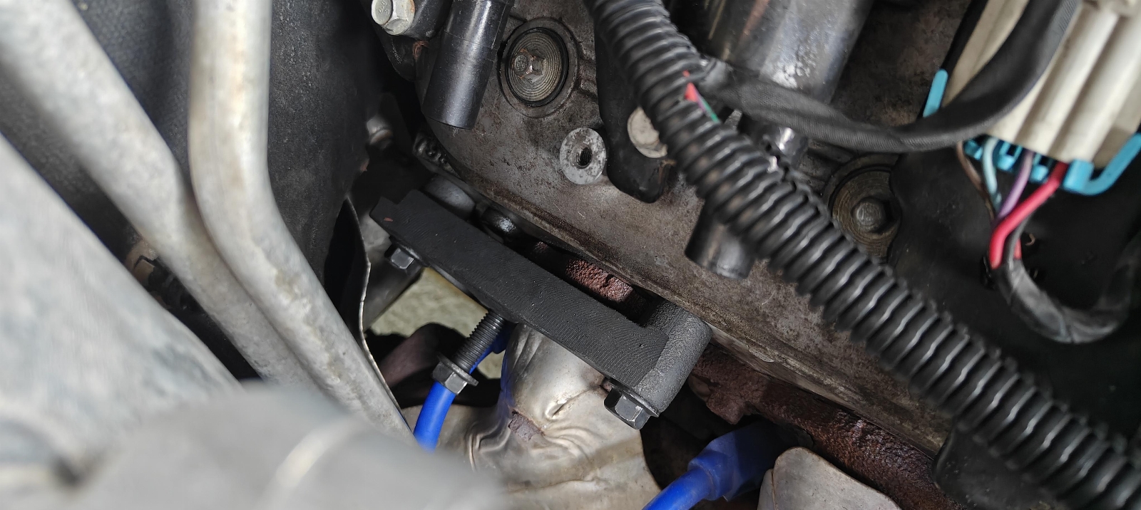

Installed the Dorman manifold clamp, due to broken stud on the end. A little tight, but no dramas.
The other side will be my nemesis, up there with those stupid ATF cooler lines.

I wish someone made a bolt on fixture that centered a short reverse drill bit. with some good penetrating oil I bet 90% of these would screw right out.
or like one of those body shop stud welders that tacks the nail looking thing onto body panels and then a slide hammer is used to pull the metal but to the bolt and then they twist out.
Just have to be able to access the studs straight on. I have so many head-shields and sound deadening that it almost seems like you'd have to pull the engine to get proper access.
Apr 11, 2018
7,124
14,375
St. Louis
Weld the inside of a nut to the broken stud.
If the stud is recessed too far below the surface of the manifold flange, use a piece of copper tubing to keep the weld from sticking to the sides of the hole in the manifold flange. Weld won't stick to copper, and build up the bolt with weld metal, then weld the nut over the top.
Or just unbolt the manifold from the head.

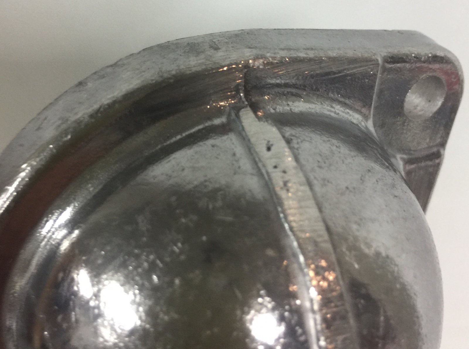

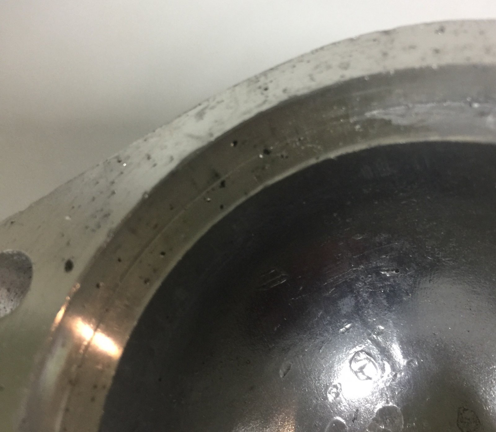

received Melling water pump. Pump looks ok so far as i can tell, no weep hole visible (maybe its hidden by pulley?)
thermostat neck looks a little porous. Hoping stock one will look good and I wont have to use this new one. Also included a motorad thermostat. Are they good to go?

receive Melling water pump. Pump looks ok so far as i can tell, no weep hole visible (maybe its hidden by pulley?)
Yup. Always had good luck with melling and motorad stuff.
