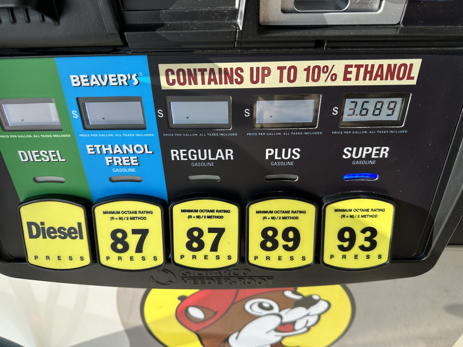

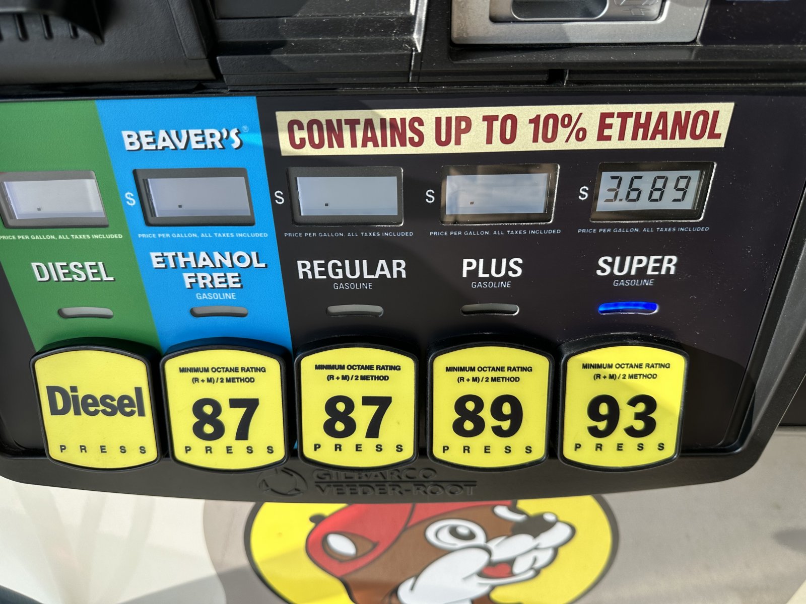

Thanks man, fo-sho. Buc-ee’s didn’t disappoint with breakfast food or merch. But the ethanol-free was 87. No bueno for the Denali.

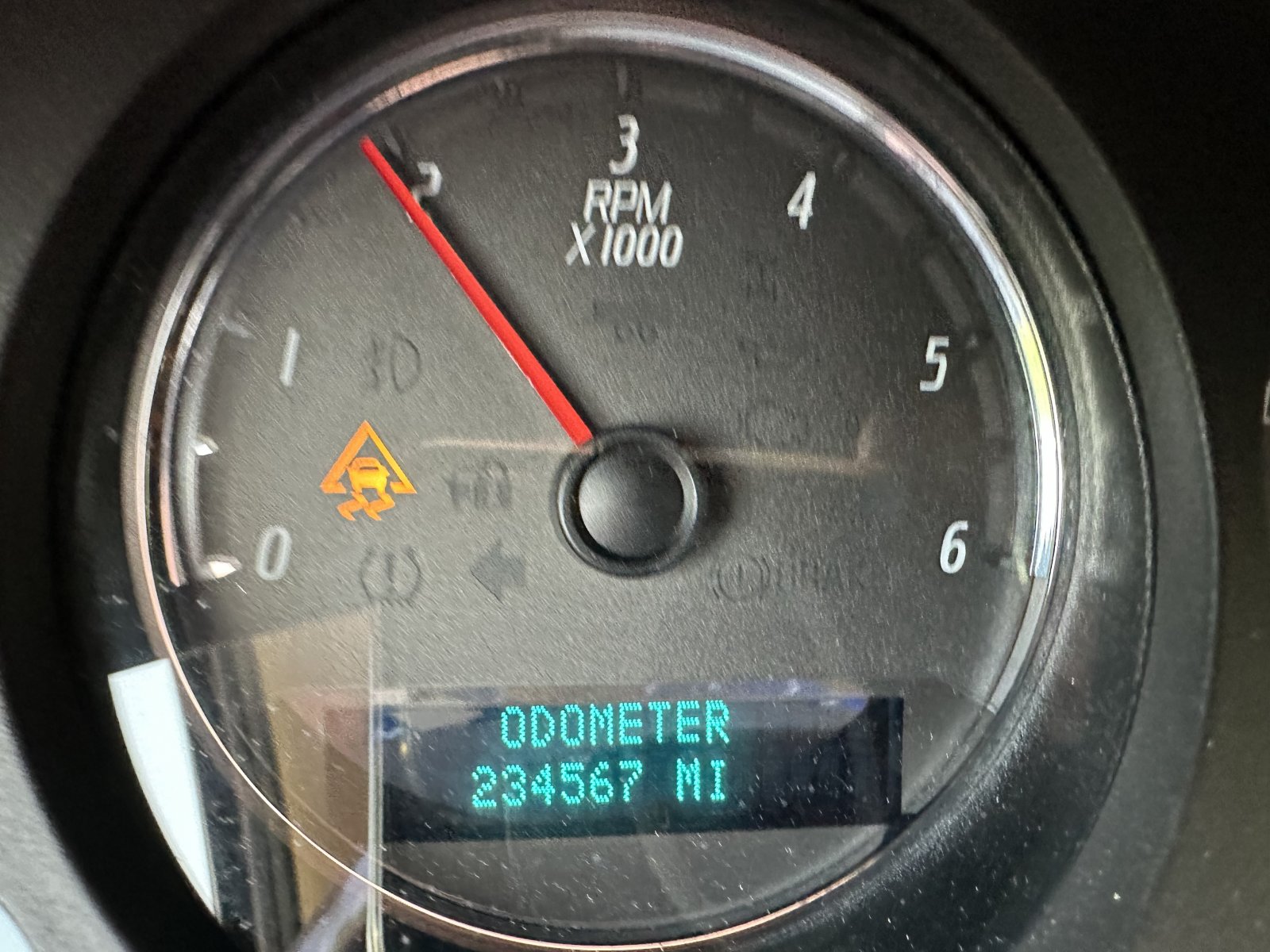

Crossed a nice milestone on I-64 on the way home.

You have to go to the next pump up (forward) to get the 90. They stopped doing the 93. Bastards. I have to put 93 in the avalanche and the Denali. Back to e10 for me after they switched
