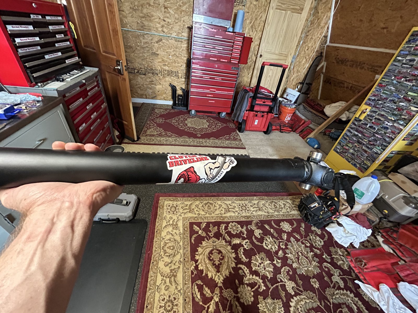

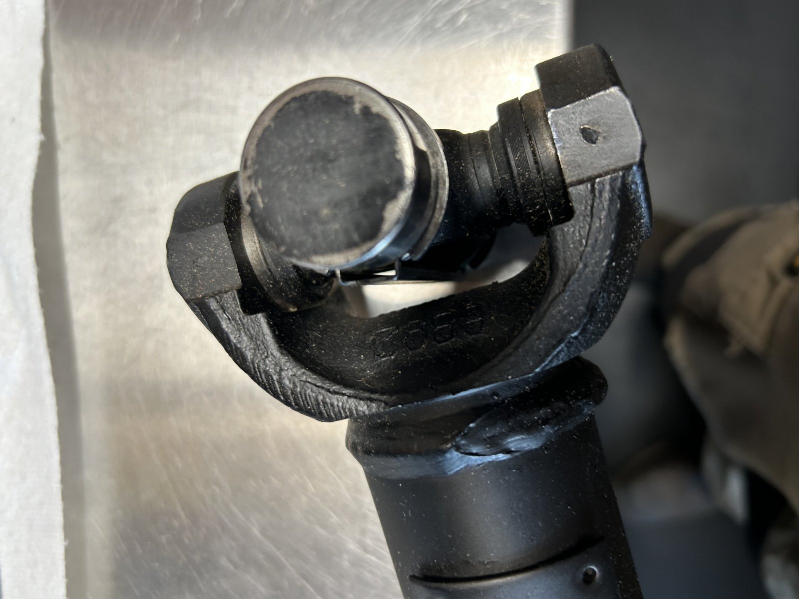

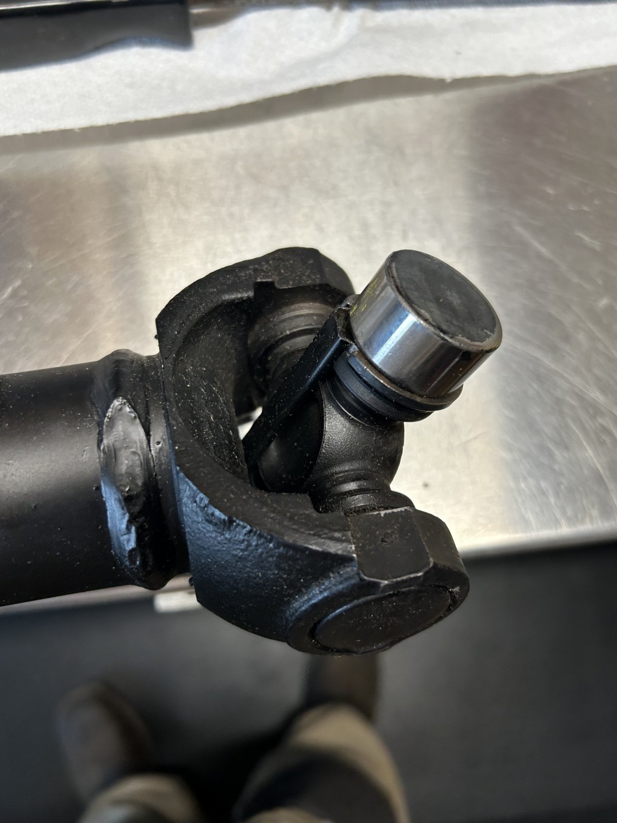

Front Driveshaft arrived this morning. Even had this fancy clip to keep the caps together during transit. IMG_2675.jpegIMG_2676.jpegIMG_2674.jpeg

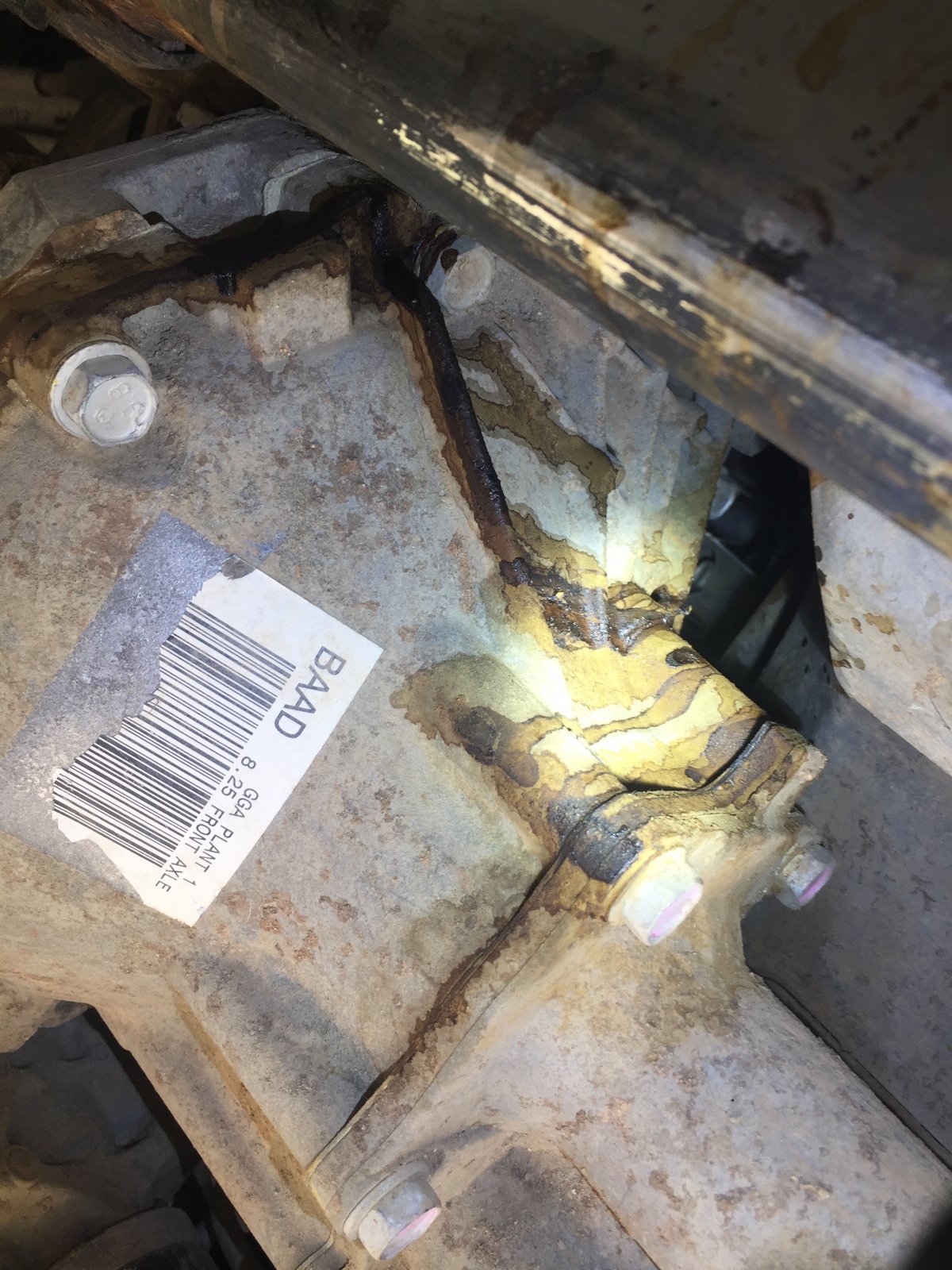

hope it isnt the heater core, seems like i only smell it inside, but some drip stains look like it maybe radiator. didnt see any evidence by heater t's, dont smell it in engine compartment, will crawl under and check soon.

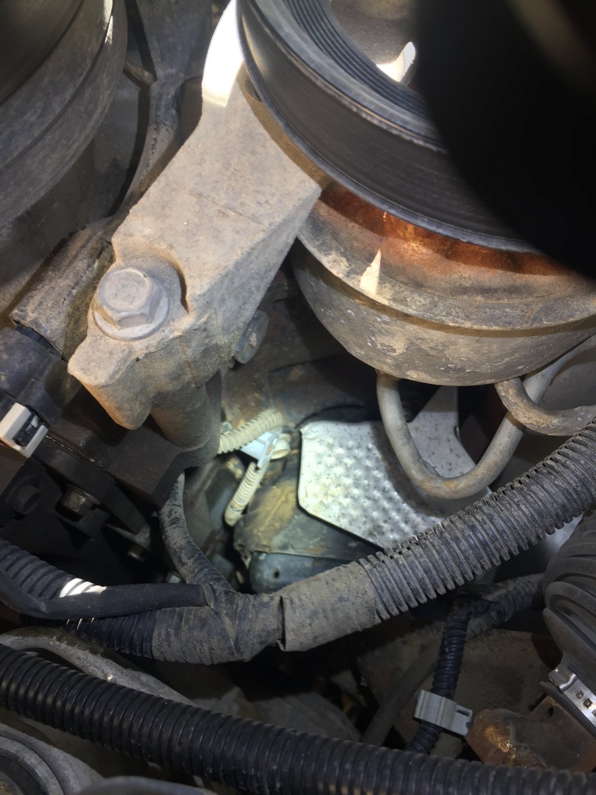

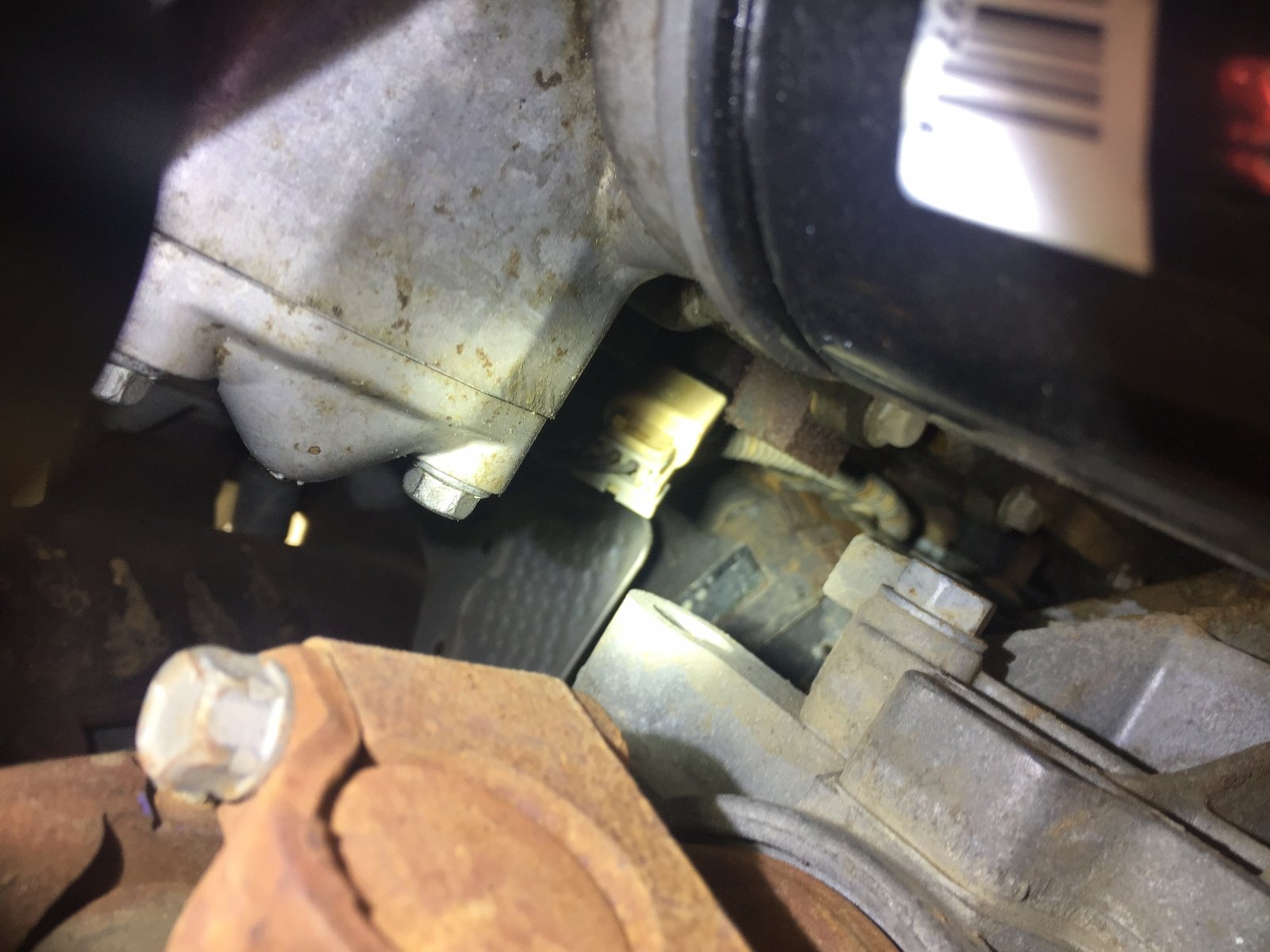

cant find the leak! see one, it looks like it maybe motor mount? heater tees look dry, radiator, hoses, rear heater lines all look dry.. didnt smell any coolant underneath. only when my nose was by the coolant tank. turned heater on, didnt smell coolant. wonder if its leaking headgasket. i thought my coolant level was right on the cold full line, looks about .5" low.. unless there is a freeze plug right above driver side motor mount..
that's definetly a blown out motor mount, the fix is to use the hummer mount.

Thanks! Right on, good knowing the leak is motor mount. Will check the spots you mentioned closer. really dont smell it outside which has me worried. Seem to smell it in the morning on or before first startup.

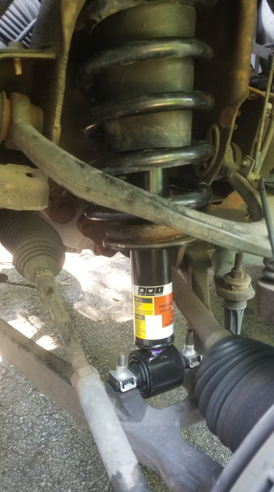

What part number and suspension code?
Front GM# is 19420494.
Rear Arnott is 2708, my gut tells me that even though the 2708 is a factory replacement, that the OE BDI might be just a tad softer....not sure though.
My RPO codes are Z55, 6XA, 7XA

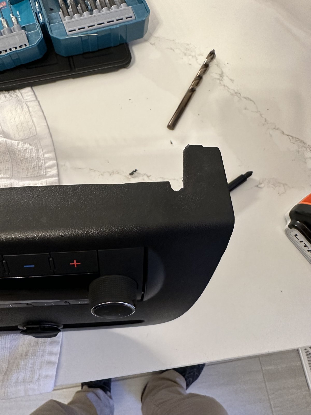

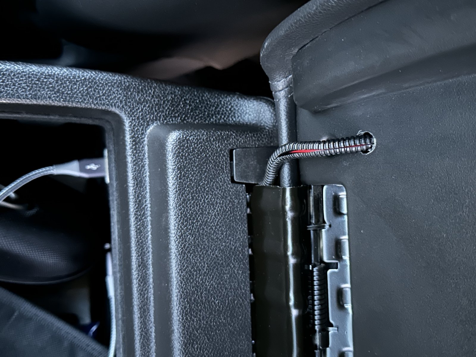

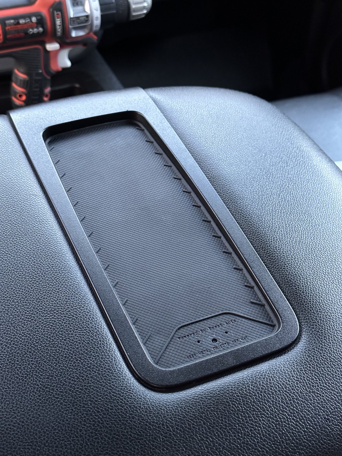

Added wireless charging to the 2500 today; install was very straightforward and I only made one modification.

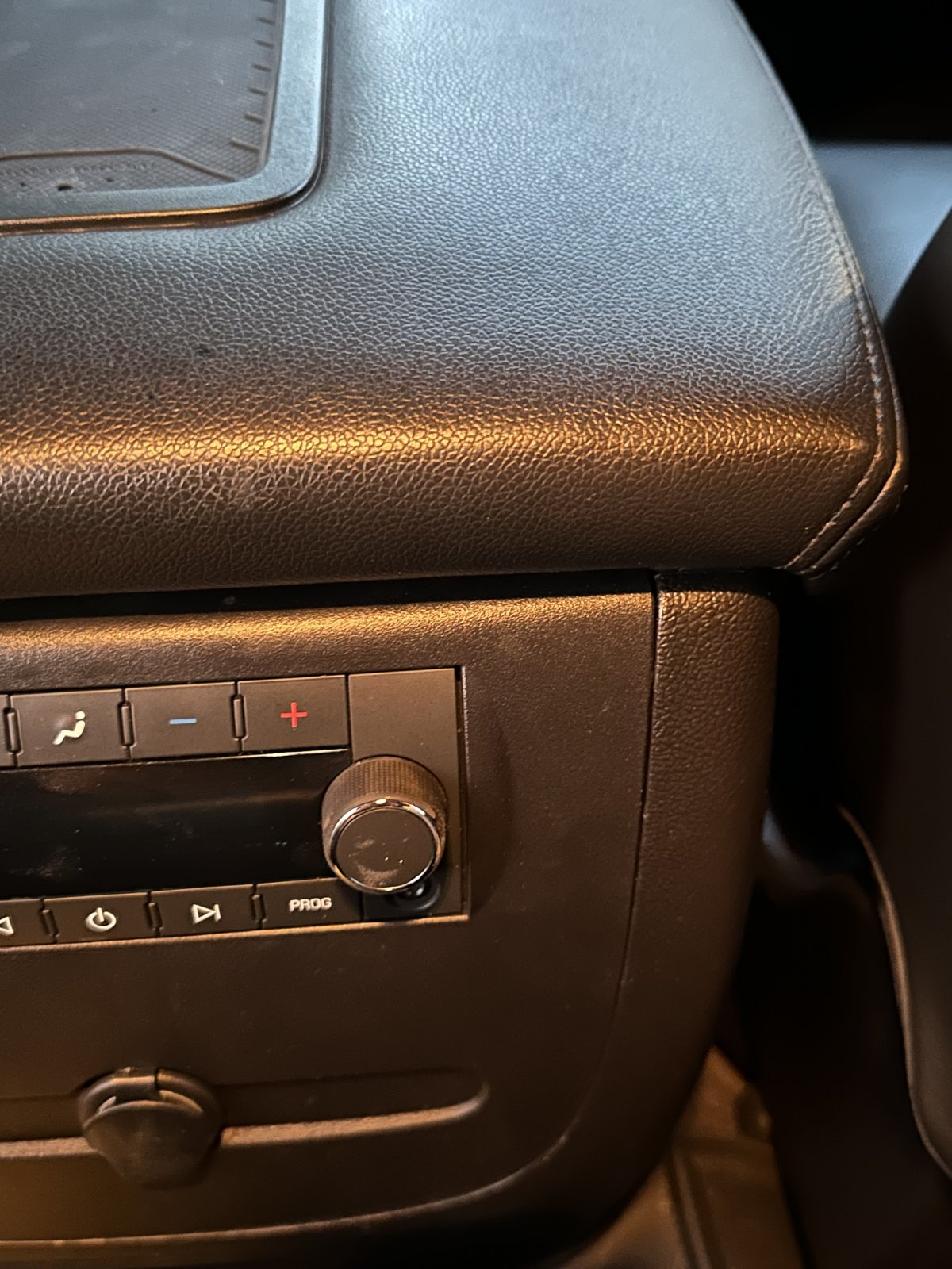

In the second picture I cut out a small indent for the wiring to pass forward, otherwise the trim panel which holds the HVAC for the rear will not seat like it did prior. It will seat enough to not really notice but my OCD self can definitely tell that it's not OEM as there is a small break where the rear trim panel connects to the center console as seen in the fourth picture.
