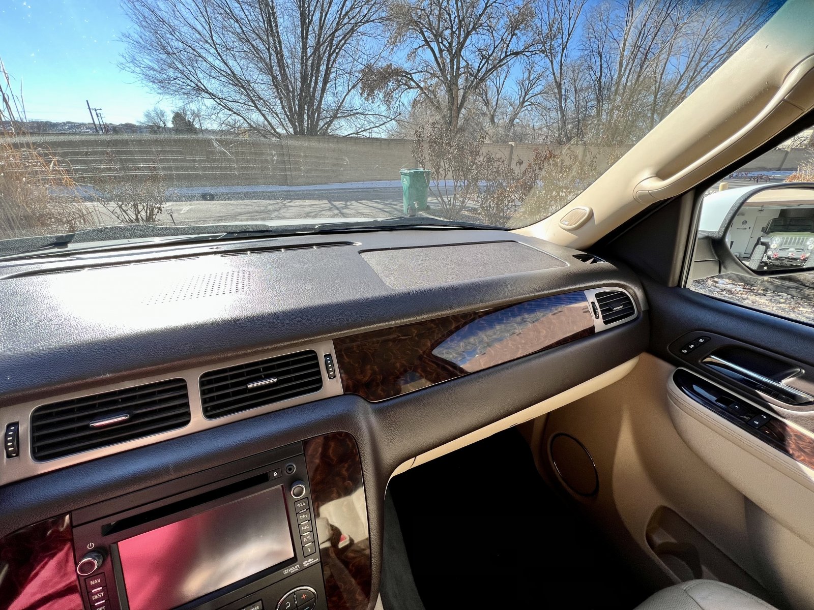

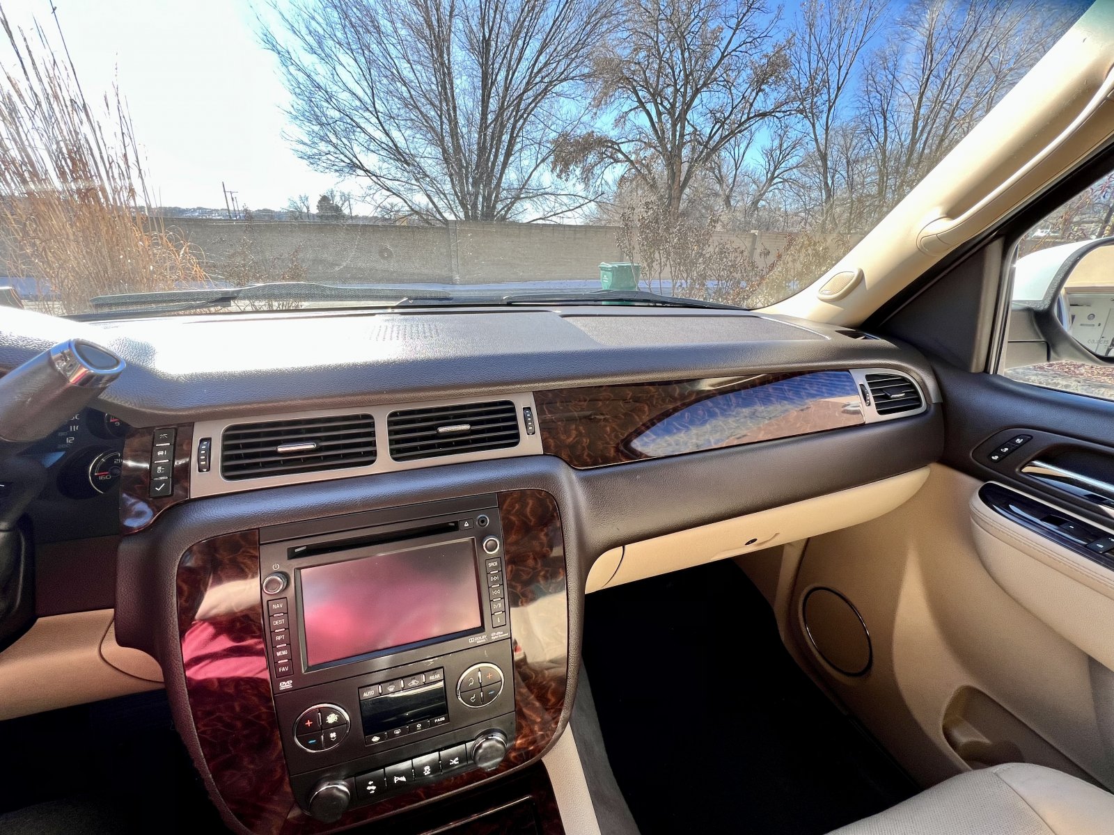

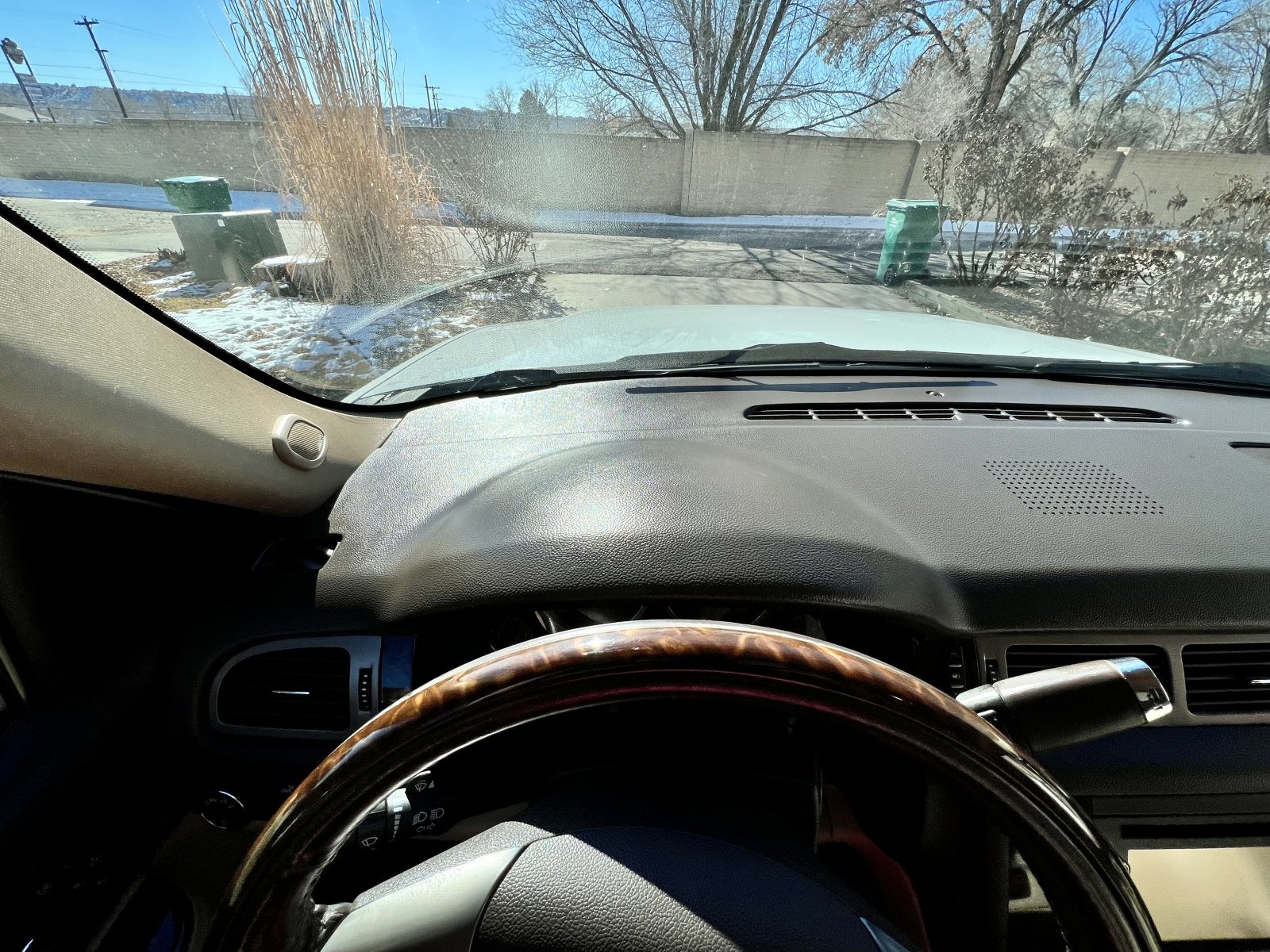

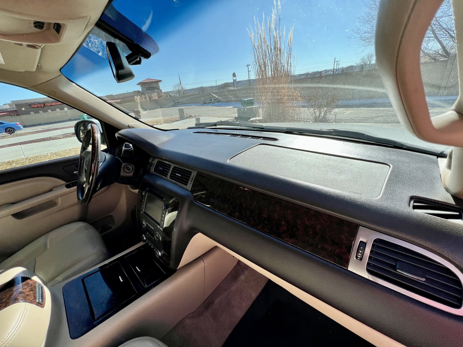

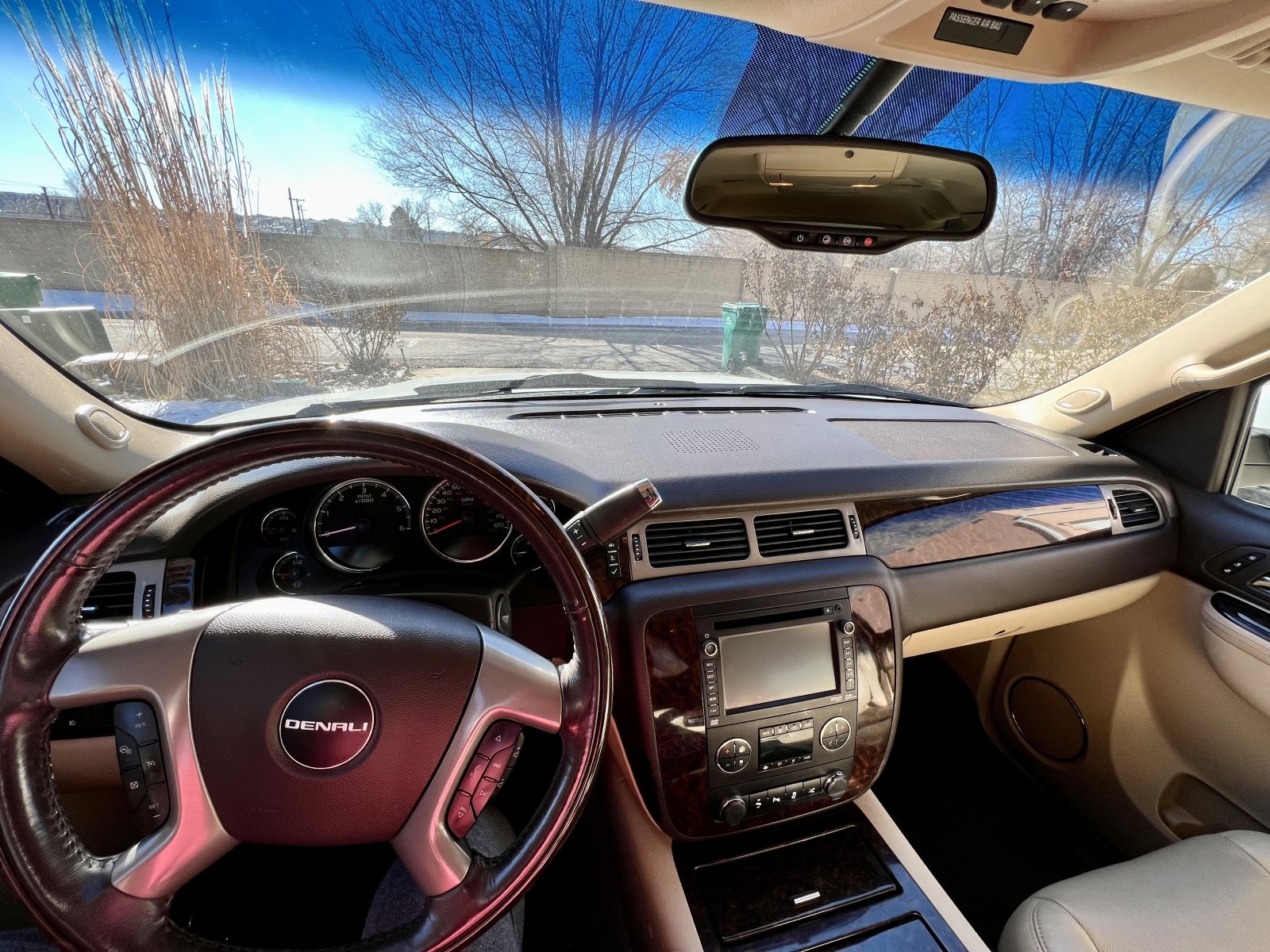

Installed a dash skin yesterday. Turned out very good. Much Better than the huge cracks.
