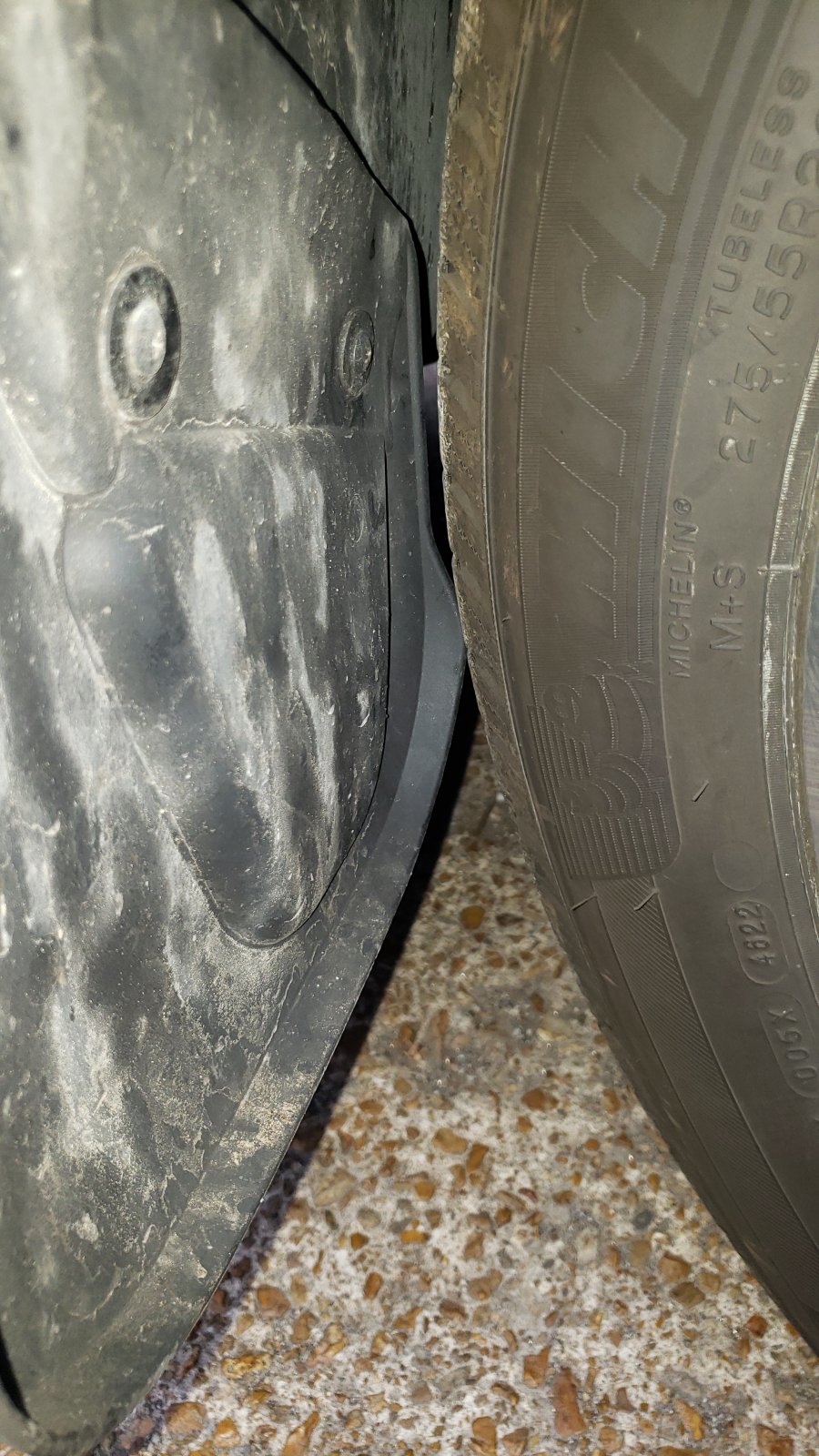

Since I got the new wheels and tires installed I've noticed two to three times when I am backing out of a spot at work and start to pull forward there would be a pop on the right side. I chalked it up to some of them black walnut shells around on the ground near where I park. It finally happened when I was backing out of a space other than work so I was hoping it wasn't the new ball joint going bad. Realized yesterday that the tire tread comes really close to the mudflap when turned all the way to the right. The Husky mudflap isn't flat and has a curve to it and the edge has a small lip sticking towards the tire. The mudflap hangs down and the mounting screws are higher up, so I may have to try heating it up with a heat gun and try to get it to not curve forward as much.
EDIT: after looking at it, I could probably just trim a bit of that lip at the inside bottom

I cut the corners of my Husky mudflaps. Way easier than trying to heat/massage them into a new shape.

are those 22's or 20's ? i have the same flaps on mine with the same size in 20" no rub, popping noise is often the front sway bar needing the bushings lubed, I have to lube mine about every 6 months or when the weather/seasons change
I have 33" tires and my Huskys would be rubbed by my tires, giving that popping sound as the tread block grabbed the corners.

20's. The wheels have the same offset as stock (31mm) but are 9" wide vs stock 8.5". Tires are stock size, 275/55/20 Michelin Defender.
As my pic showed, that inside edge of the mudflap is curved into the wheel opening a bit and the corner of the tire tread does hit it at full lock. The other side doesn't. The mudflap is just out of shape and a bit curved inward too much on passenger side.
