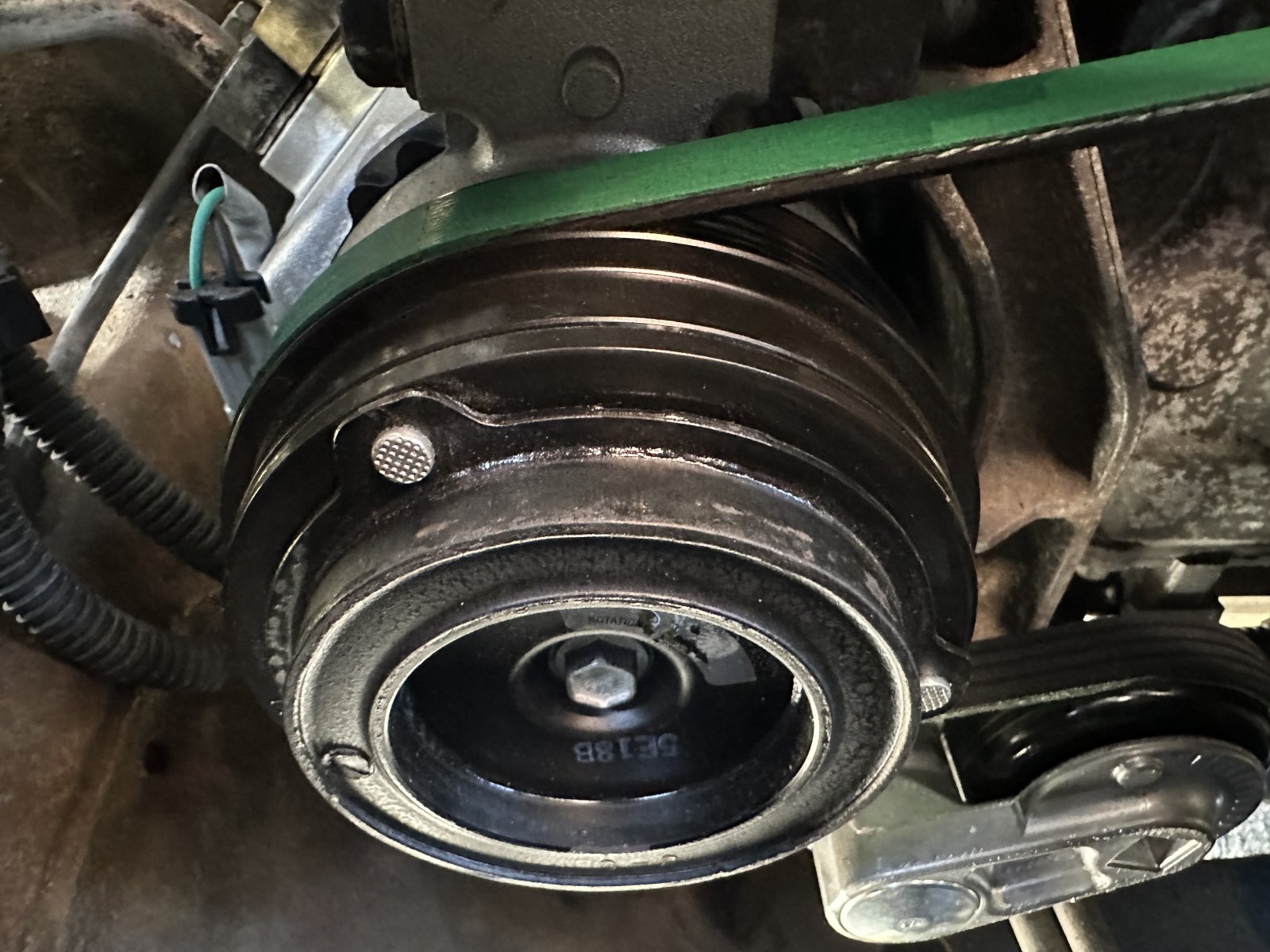

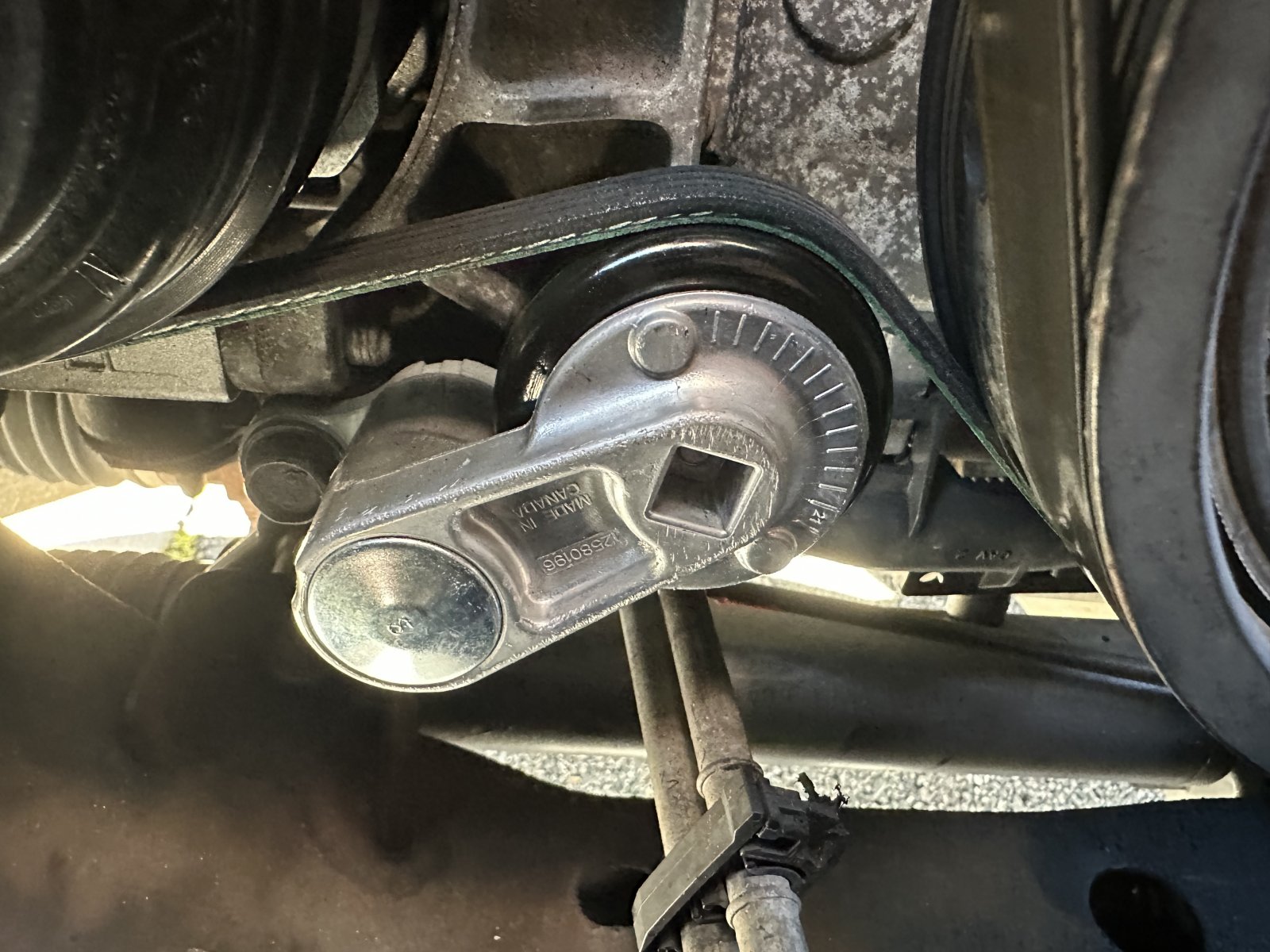

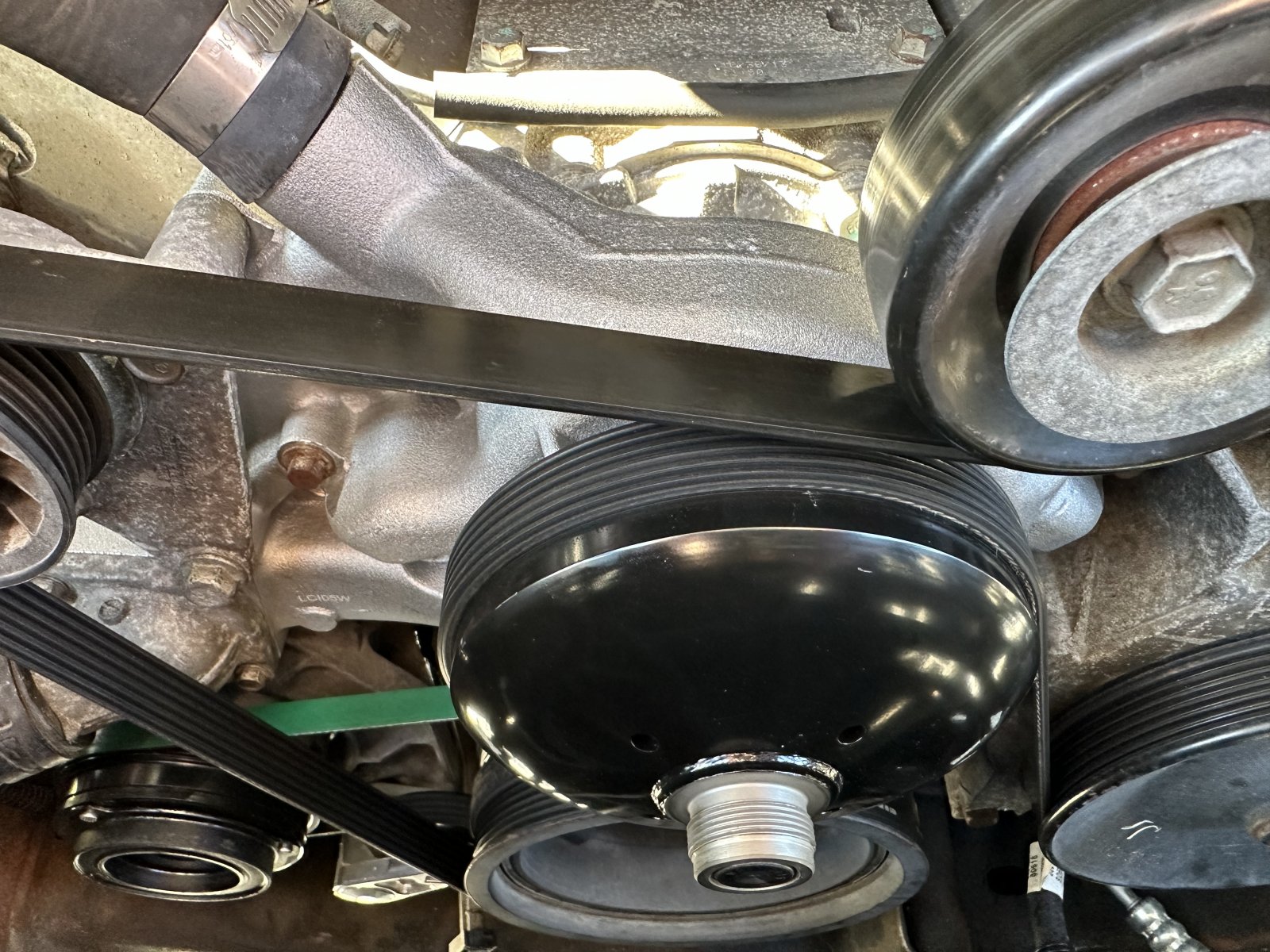

I never posted pics of the water pump and AC compressor work I did on the 2007 so I can understand if y’all thought I was talking smack. Here ya go!
