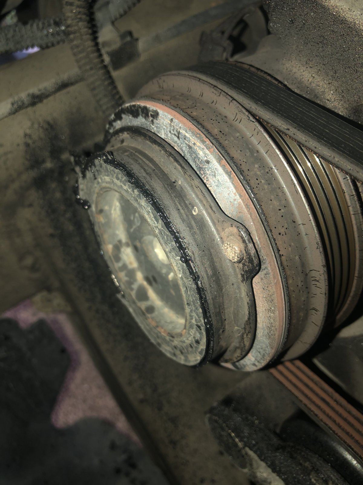

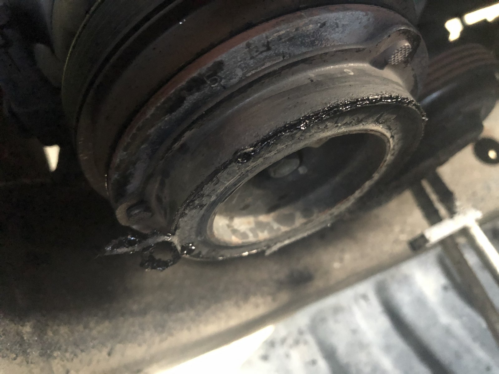

Lost my AC today. Anyone know what happened here...thinking the clutch exploded? Hoping this isn’t going to suck to fix
lowh07
Dec 1, 2017
445
1,772
If it’s just the clutch, shouldn’t be too hard to swap with a new one.
Kinda looks like the clutch to me
Not the easiest thing to remove, especially on the vehicle...
I’m going to pull the ac belt so that I don’t do any extra damage in the meantime. It also sounds pretty bad right now so hoping that goes away when the belt’s off. Of course this happens when it’s starting to get hot......

Iirc its two clips to get that assy off.
First one is easy to get to, second one is way down in there.
I have my old compressor mocked up if you need pictures.
(It's going to be used to align the balancer).
And this is why i bit the bullet and got a new compressor while i have the engine out. ;)
And my clutch was nearly gone.
I don't think it had much time left

Thanks, that might be helpful if you don’t mind. I’m looking at the one on the 6.0 but it looks like a different style

If you didn’t snap the belt it’s just the clutch. If the belt snaps it’s the compressor seized.
Didn’t snap the belt. My brother thinks the pump is locked up, and when the clutch engaged it just lunched the rubber coupler. I hope you’re right...

When you get the clutch off spin the shaft to see if it’s seized before buying clutch. Never seen that happen if it’s seized I’ve seen the belts snap or at the very least chatter the tensioner of the pump is starting to seize.
