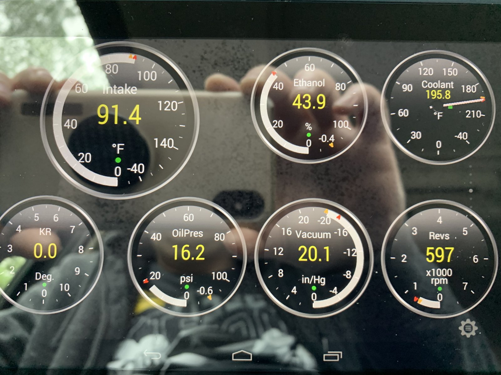

Oil pressure at idle with torque pro.
08z71bgm
Jul 2, 2020
758
1,108
Long Island, NY
That seems low. My hot idle pressure is mid 20s, usually 25 or 26
Sent from my SM-G930V using Tapatalk
That’s what I was thinking. I’m due for an oil change soon and I disabled AFM with hptuners.
Googled some things and found that the screen and sensor could be clogged or malfunctioning. Which I don’t think the sensor is bad as it matches what’s on the dash. The other thing was the VLOM needs to be replaced but that was hit or miss sometimes it would fix someone’s problem other times it wouldn’t.
Open to ideas....

So curious question...
Whats idle and cruising oil pressure gauge look like?
Mine seems a bit low and if it’s going I would like to be ahead of it and find a replacement and pull this one.
I wish i knew the history of my old 5.3, but 40psi hot idle seems to be normal.
my engine @28psi hot idle was eating cam bearings.
now it's possible there was some botched work done on my engine in the past, like the original lifters were in fantastic condition, and the cam looked pretty fresh.
So someone might have nicked a cam bearing resulting in the sparkles....
that said, nip it in the bud early is my thought.
Oh and on mine, i found my oil pressure regulator in the pump was sticking.
I did loosen a bunch of sludge before everything went south...
My oil pressure had a very slow rise, changing the sensor did nothing.
The screen was clean but i changed it anyways.
Mine also failed to get the 10psi per 1k mark.
so at 5krpm +, it would sit under 50psi.
