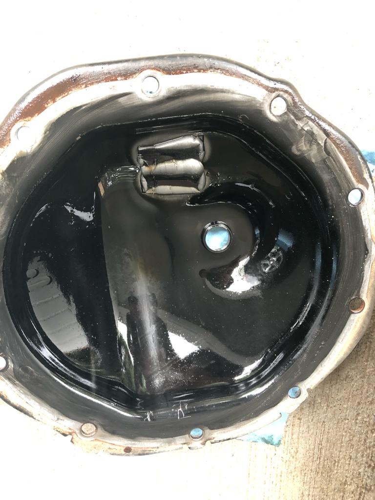

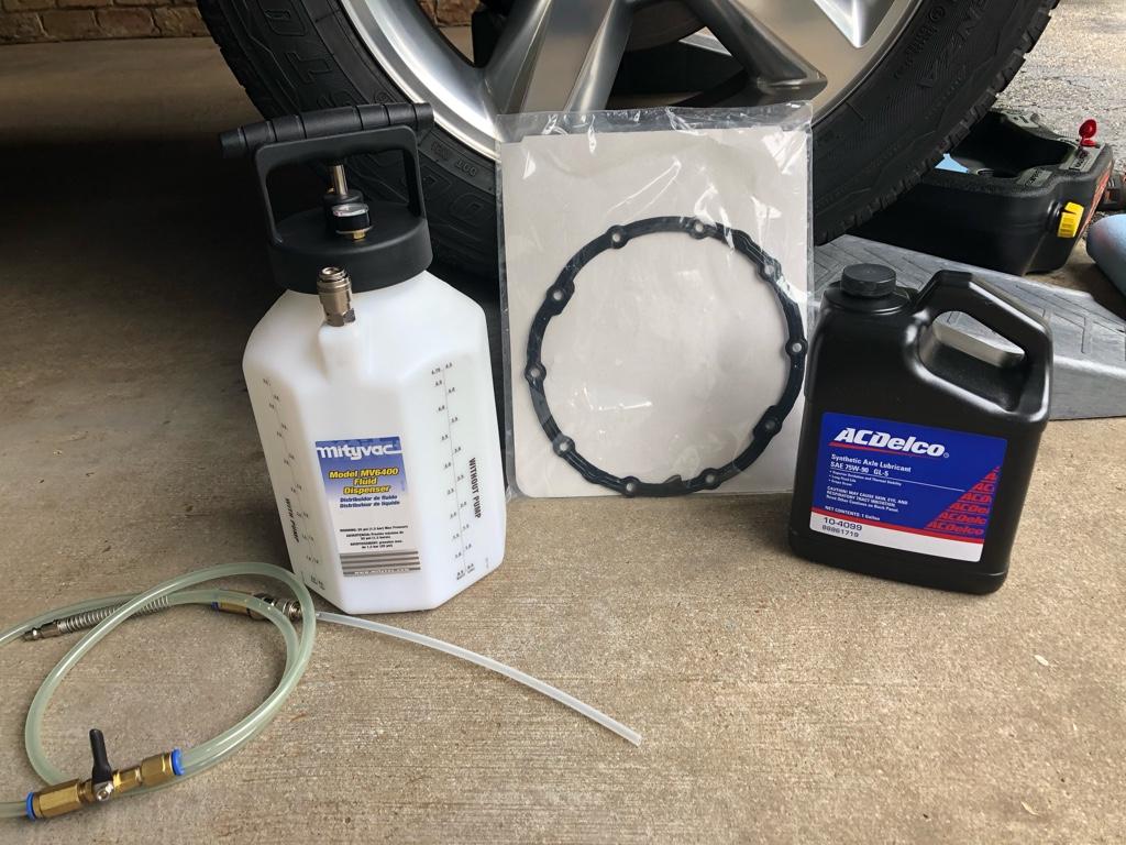

On Sat, I swapped out the front & rear differential fluids on the Suburban at 135k miles. The Mityvac fluid dispenser made it very easy.
It doesn’t look like it had been changed by the previous owner.
Did you use any gasket sealer on the cover with that rubber gasket?
