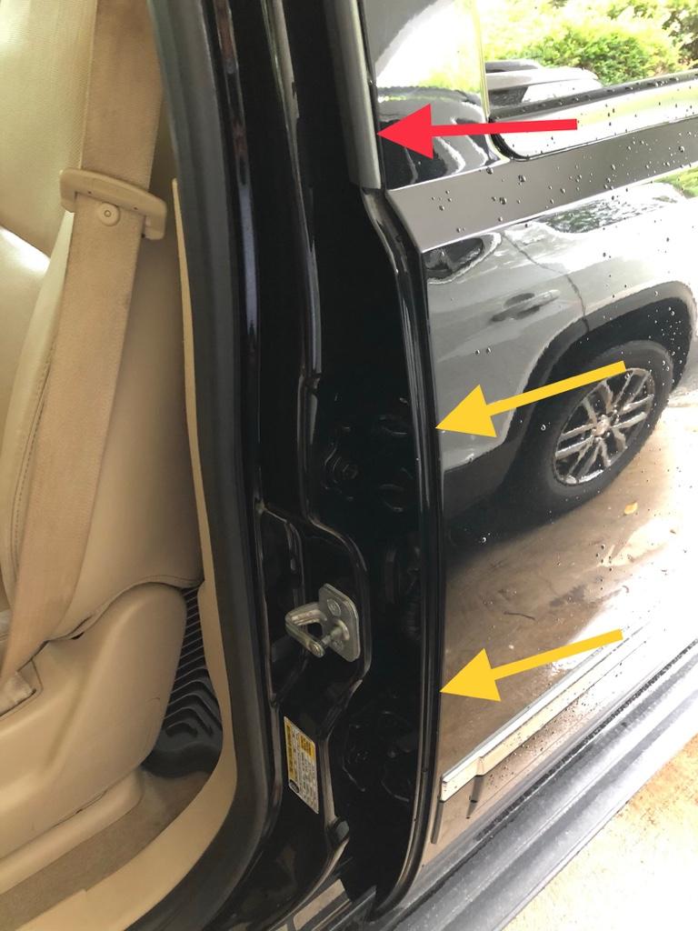

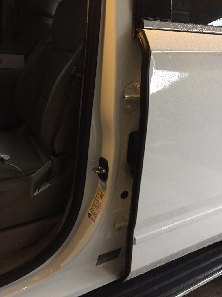

Thinking about the wind noise difference I’m noticing on my 2012 vs. that of the 2015.
The 2015-2020 Escalades have an additional seal that goes all the way down the front of the rear door edge which seals the door gap. It was a noticeable improvement when input it on my 2015 Yukon.
I haven’t seen it on the GMT900 Escalades I’ve looked at. Looking at my 2012 Suburban, it seems like the upper seal (red arrow) could be extended all the way down (yellow arrows) for the same effect.
The seal is just press fit on the seam. Anybody know where to get longer lengths?

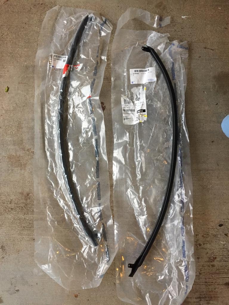

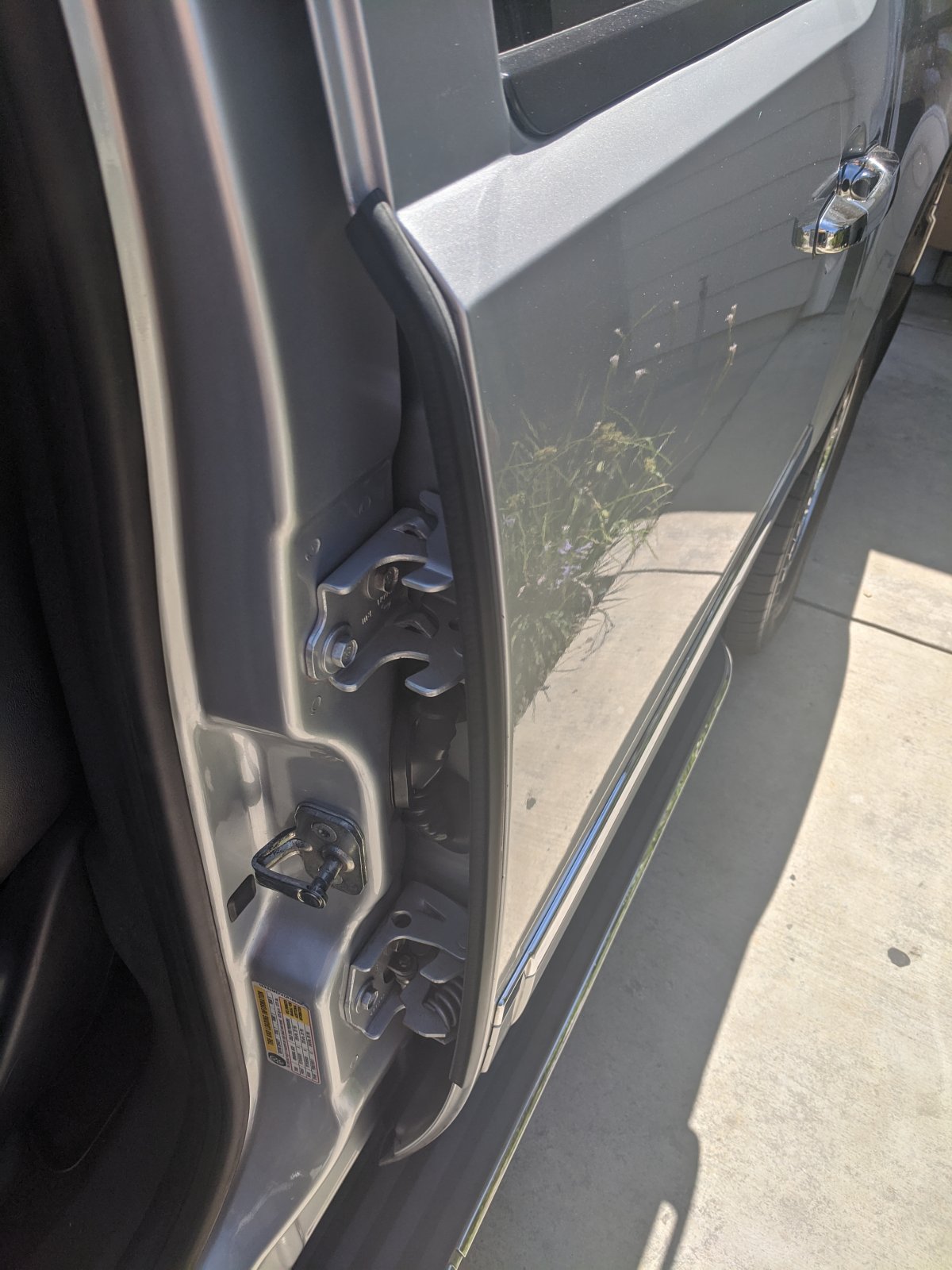

I’m back in the office now, but will measure later today to see if it would go all the way down.
For reference, here’s the K2XX ones.
23496503
23496502
23496503
23496502
