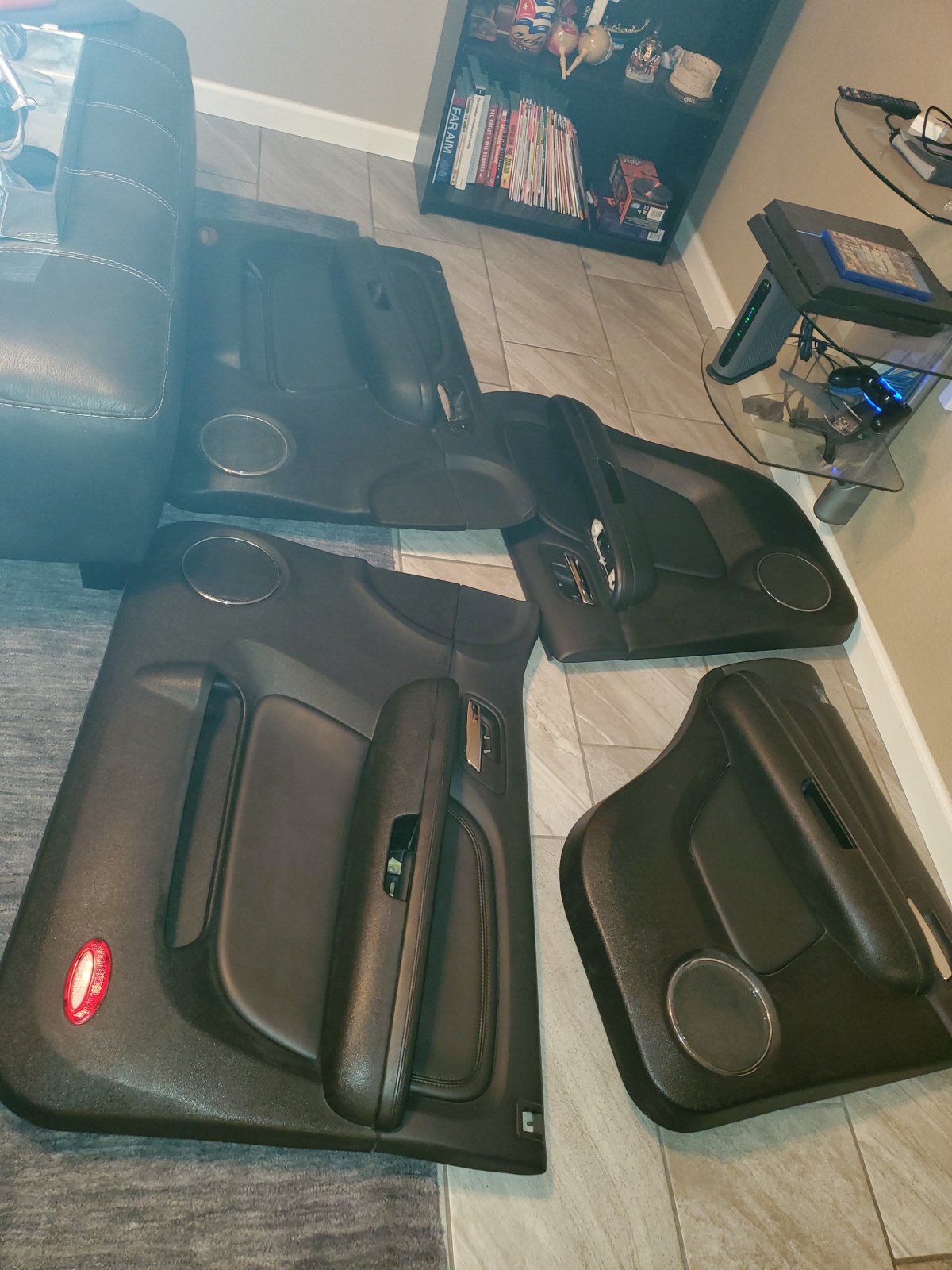

Very productive day, order new springs, rear shocks, swaybars and coilovers. Also picked up these from the junkyard for about 240 bucks. Door panels from an 08 escalade. Gonna put em in next week.
