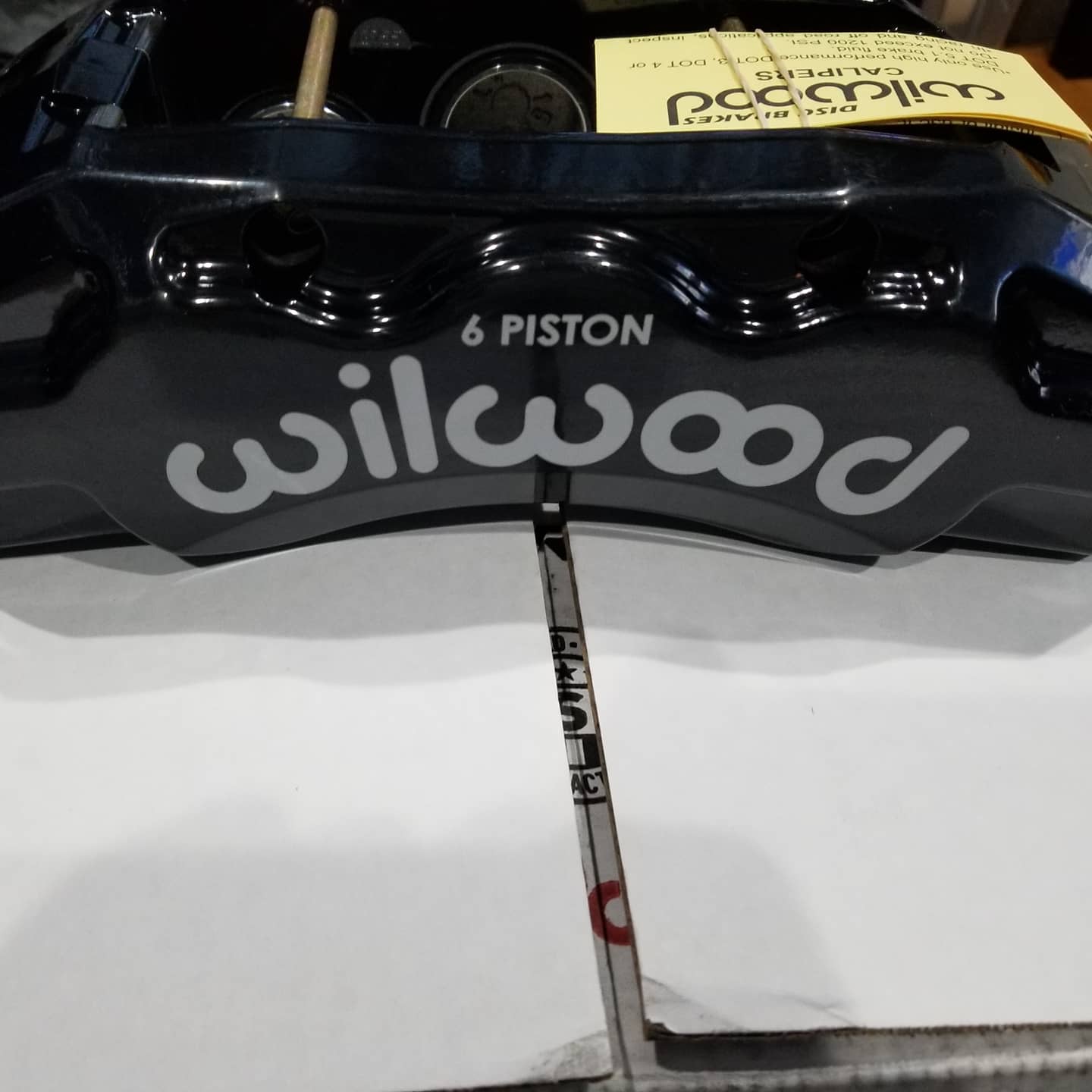

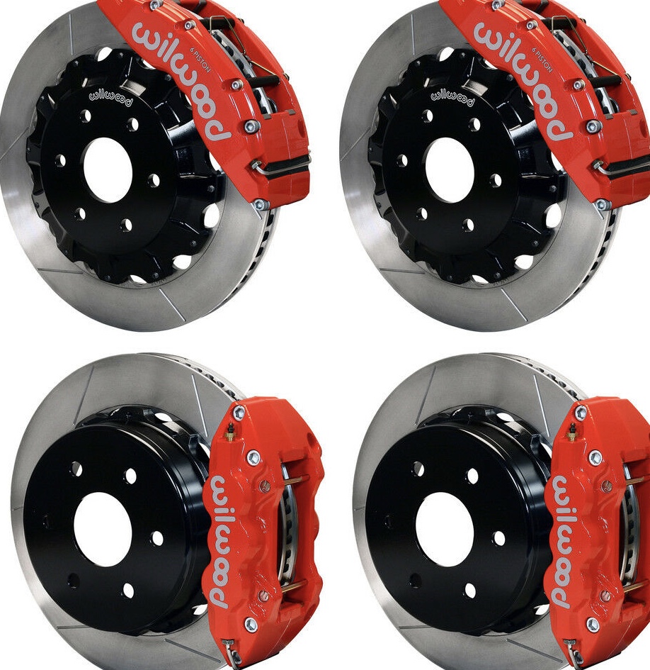

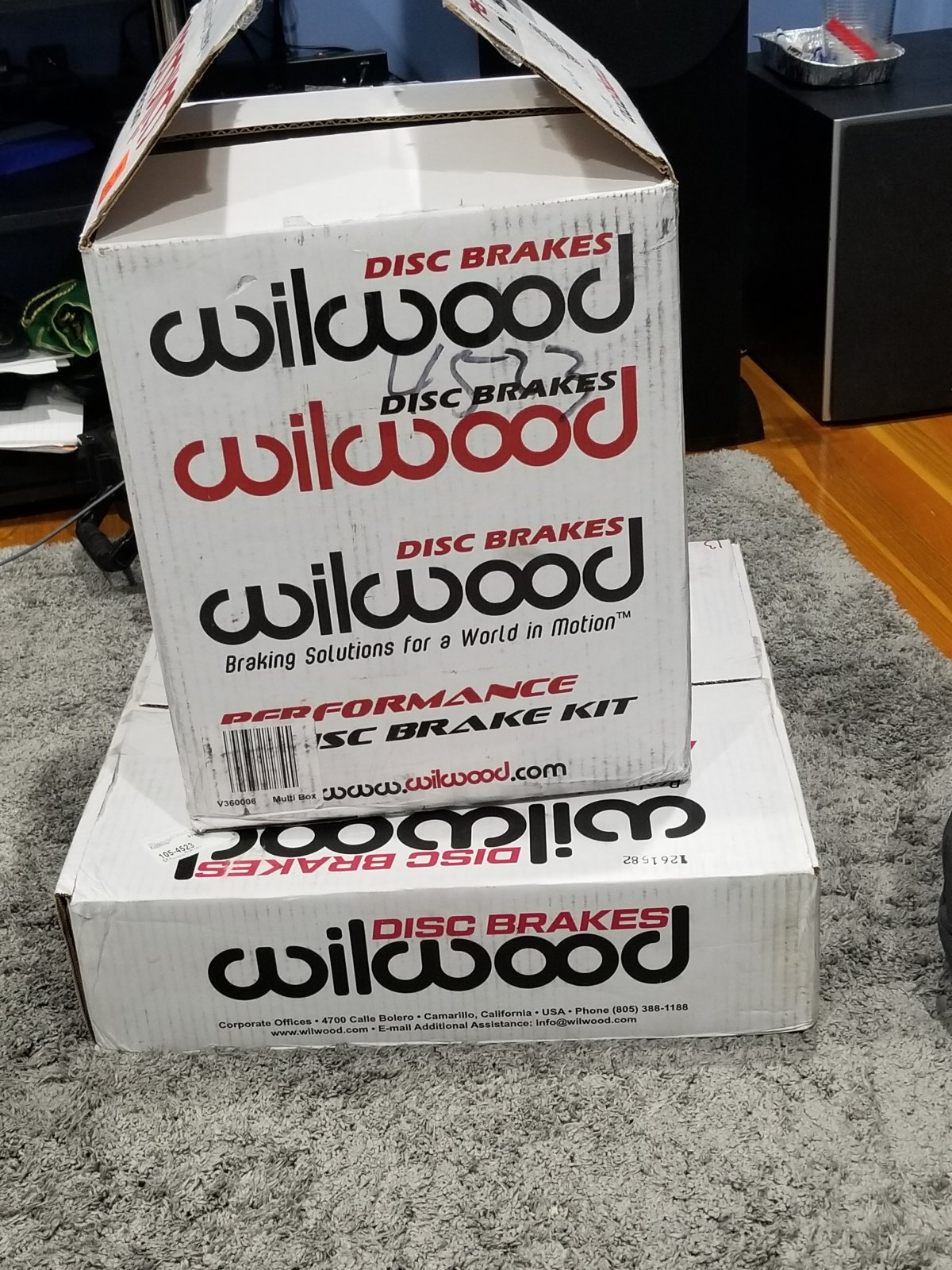

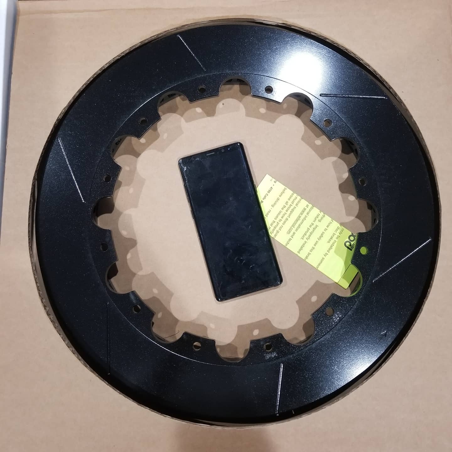

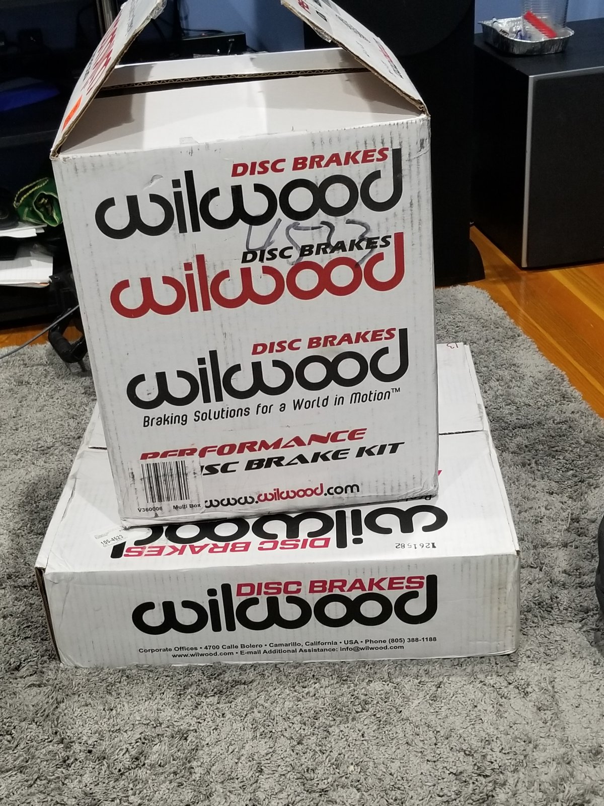

I just pulled the trigger on a Wilwood 16”/ 14.25” BBK for the Silverado. I’m doing my part to to stimulate the economy.

I'm just waiting on the braided lines now, they should be in tomorrow.
I ordered mine as a complete kit with everything included for all 4 wheels since you need their lines. Did you get rears too or just fronts?
