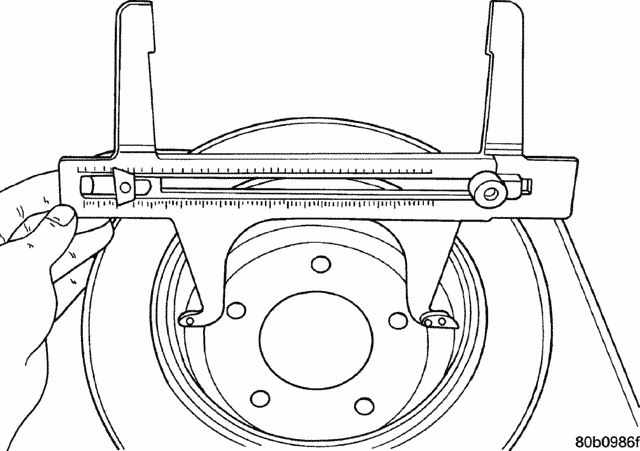

Wes needs one of these next time!
RIGHT? knowledge is power, o'well I might not have noticed a leaky caliper for a while though I was just looking under there like 2-3 days ago for my monthly visual inspection didn't see anything and I am getting ready for a nice long road trip so it all worked out ok this time.
