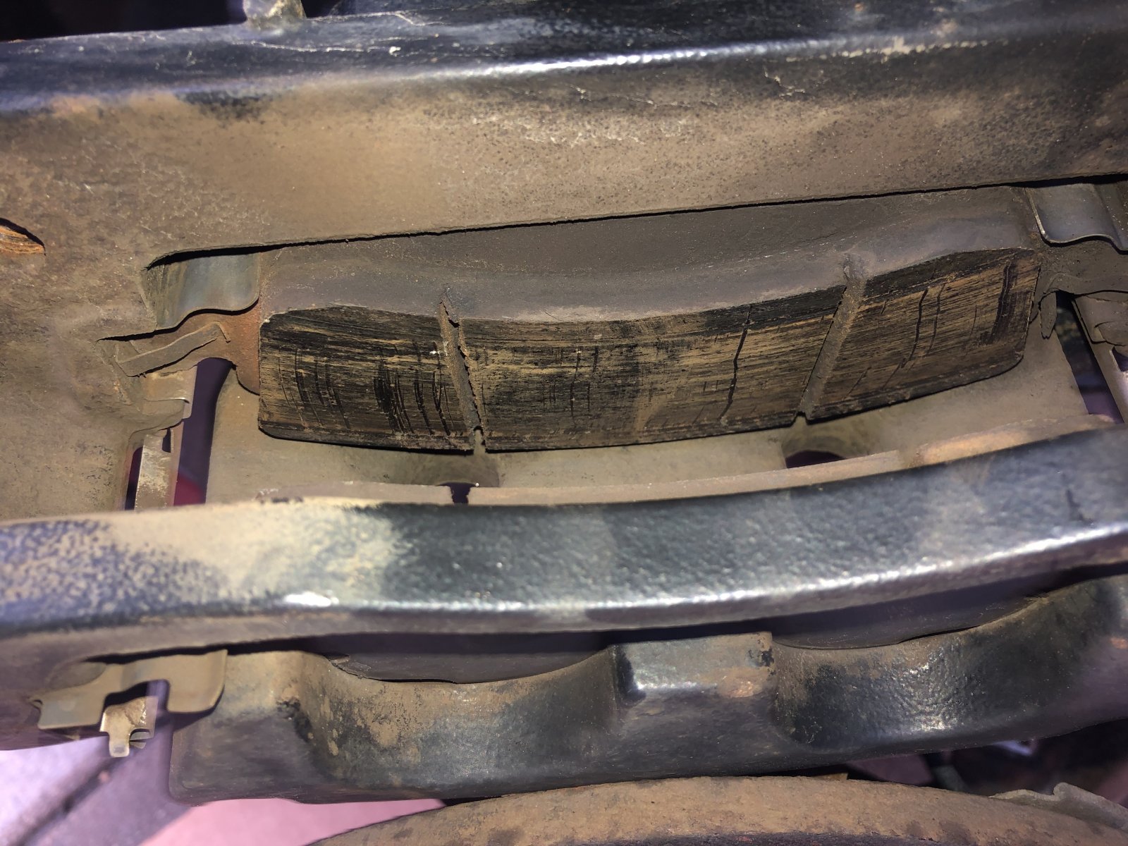

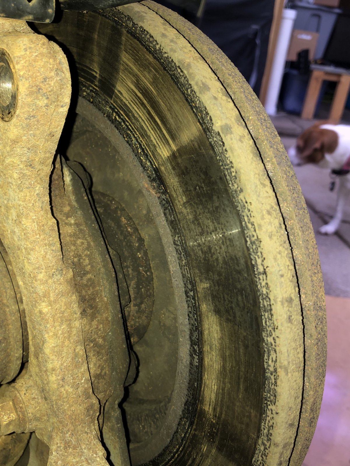

That is the plan. This got me out of critical condition. Next will be replacing the other side as well as pads and rotors. I noticed some odd wear pattern on the inside of the rotor I took off. Looks like someone replaced the pads without turning/replacing the rotor so now the pads, which looks almost new, based on thickness, has a strange wear pattern. The outer 1/4”-3/8” on both the OD and ID edges of the inside pad is worn down more than the center field of the pad. I’ve seen them wear more on the outer edge than the inner edge due to bad wheel bearing, but nothing like this. Note, the radial marks are from pulling the caliper off and the thicker center portion of the pad scrapped along the outer ridge of the rotor.

looks like a little bit of rotor warp, rub your finger across it if it's not smooth then yep

I would definitely replace the rotate along with the pads. Rotors are so inexpensive nowadays it makes sense to do that. Of course those can probably be turned since they’re not drilled and don’t look like they’ve already had that done.
45,012
I checked at a few local auto parts stores to get my stock rotors turned and they all had quit doing it. Two of the stores told me that they're making the rotors a hair thinner and cheaper now so they're not thick enough to be resurfaced. They are now "one-time-use/disposable". My OEM ones were plenty thick so I had a mechanic shop turn them. Had all four done. So far, they're still smooth as can be.
