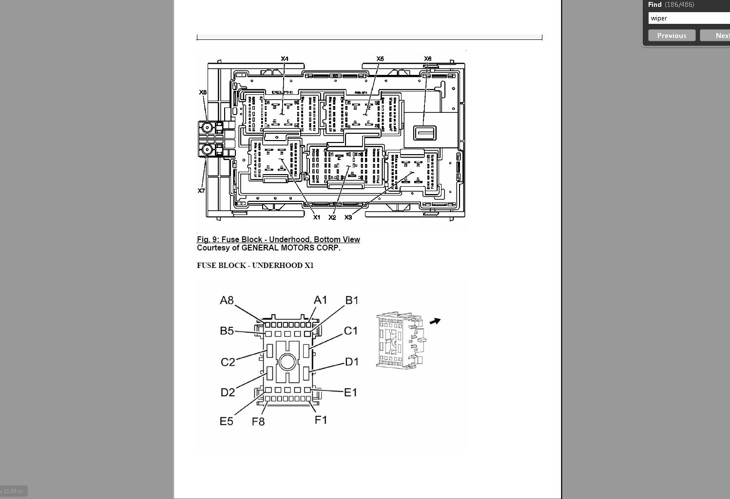

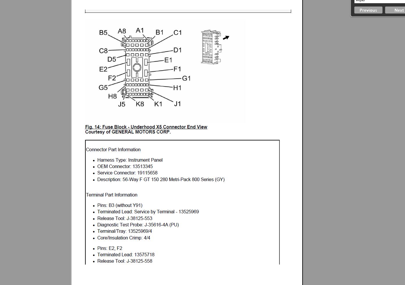

Welp. Dealer told me i need a $650 underhood fuse block and didnt charge me for diag. Tech forgot his electrical tape in my engine bay. I drove it home. Now i’m trying to figure out how to pull the fuse block out so I can take it apart and figure out how to make the wipers work.
I was going to say, take it apart probably just some burnt contacts, there just going by the shop manual like I said earlier bcm or fuse block
looks like connector x5
then pins j1, k1, k3 are what you want to check

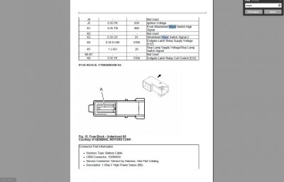

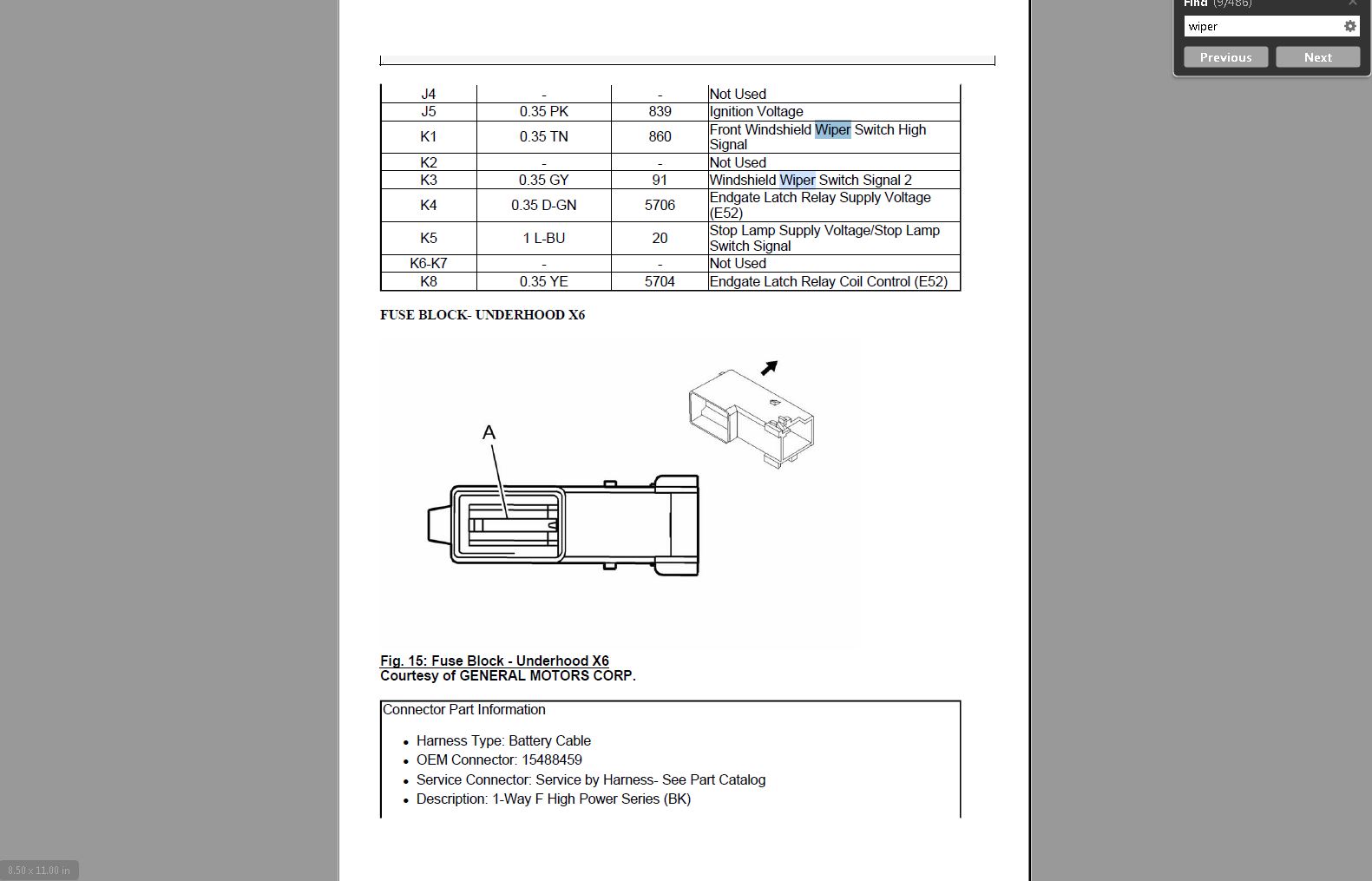

@Doubeleive so it sounds like pins K1 and K3 go high when wipers are on depending on the setting, and then those go thru the fuse for the wipers, and then in turn, make J1 go high when the wipers wipe correct? so... a T tap on K3 with a fuse that then goes into a T tap on J1 would "work" right?
30,566
48,044
30,566
48,044
that's what it says the connectors are in the service manual yes

Does it list which wire actually goes to the wiper transmission?
I don't see anything it might be because of the high speed lan (serial bus) that they use, you might try looking at the upfitter guide they usually have some good wiring diagrams

you might be able to get them working temporarily using the tp92/95 that I posted earlier I just looked in my fuse box I would imagine either one of those pins would either take 12v or a ground, you would need to check the pin to see if it it's hot or not, then hook up a toggle switch, janky but it would give you wipers (i think)
