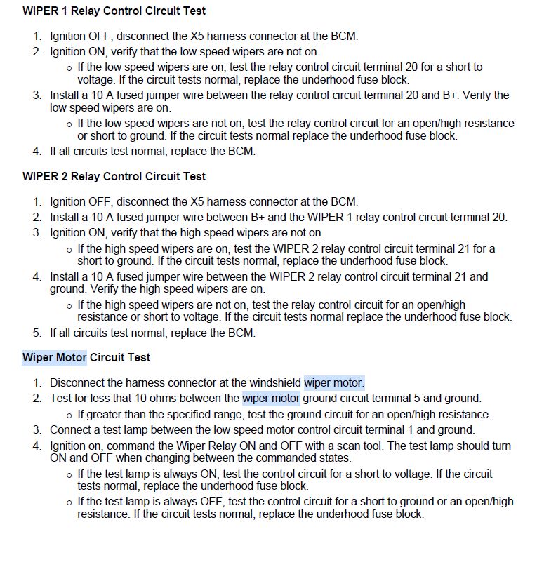

Part number on old block is 15092625 and part number on the one i pulled from yard is 25815387. The lady at another yard I went to said 07-09 interchange, and the 5.3 vs the 6.2 also interchange but who knows if shes correct or not.
This listing makes me think they do interchange? https://www.justparts.com/Auto_Parts/GM-OEM-Fuse-Relay-Junction-Block-19210438/26210732

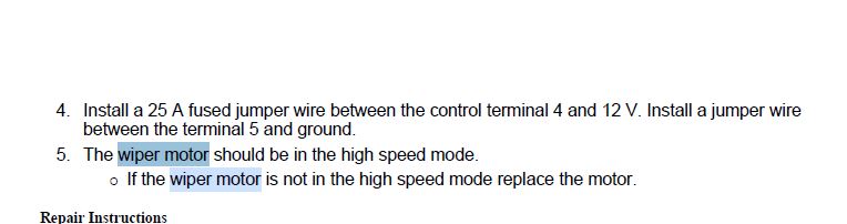

It was blowing fuses because I only had like 1/16 of an inch exposed on the purple wire and no way to maintain a solid connection.
An intermittent connection won’t blow a fuse and there’s no way in hell a wiper circuit should be drawing over 25 amps.

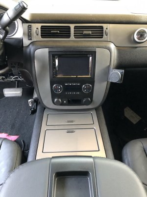

I modded my new console in the Silverado to accommodate my new most expensive cup holder i could find.

Thank u. I might pull it back in the garage. Need to find where the hell my multimeter went. I also dont seem to have a connector on that section of wire? Or am I supposed to test it with the fuse block removed on the connector below it?
Just a thought... you could try unplugging the wiper motor's harness and reinstall a good fuse and see if it still blows the fuse... if it does you know the problem is not in the wiper motor and if it doesn't then it most likely is in the wiper motor.
Fantastic thought! I will have to see where the connector for the motor is
I think that type cup holder and storarge/sunglass holder is almost absolutely useless to hold anything. It does give a clean look when closed and not used though. I switch the one out in my Denali with a standard one. It's sitting in a box on a shelf in my garage.

Fits my coffee cup fine. But this is not a DD by any means anyway. And I don’t wear sunglasses lol.

There’s not much space there anyway. The console itself is cavernous though in the main compartment, and I added the organizer for the top half of it. And then there’s the glovebox. Plenty of places to put stuff. I don’t use the one in my Denali for anything except my coffee cup. It’s really all I need. What kind of stuff do you put in yours?

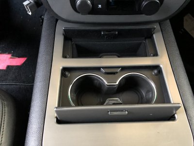

Big QT cups or 32oz insulated tumbler in the cup holders and my wife will usually lay her phone in the area in front of them. On trips the area in the front gets used for various things, like a place to put snacks, trash, etc. When going through a drive thru and getting a drink carrier I'll pull the cup holder part out and put it in the console and have the whole big recessed area to place the drink carrier. Thought about buying another dual cupholder block and popping it in the forward position so I'll have 4 cupholders there and use one for my phone or when my kids in the middle row have drinks that don't fit well in the flip down cup holder on the back of the center console.
