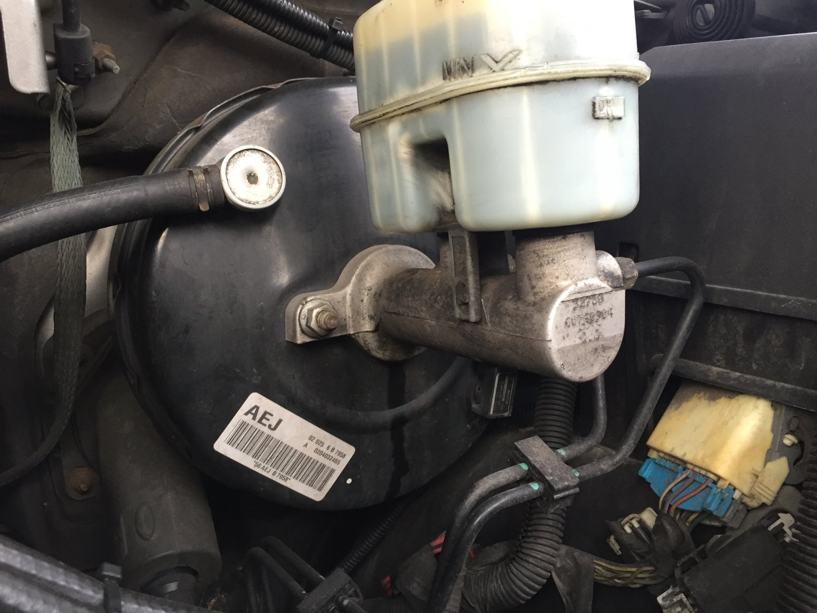

My battery is starting to take a shit, it's only 2 years old. :(
And when I was under there checking things out I saw this too. o_O:confused::(:(
50,943
19,372
It's an expensive little bastard aint it?!!o_Oo_O:confused:
Pep Boys $135(On sale at 25% off normally $174.99)
Autozone $217.99 HOLY FAK

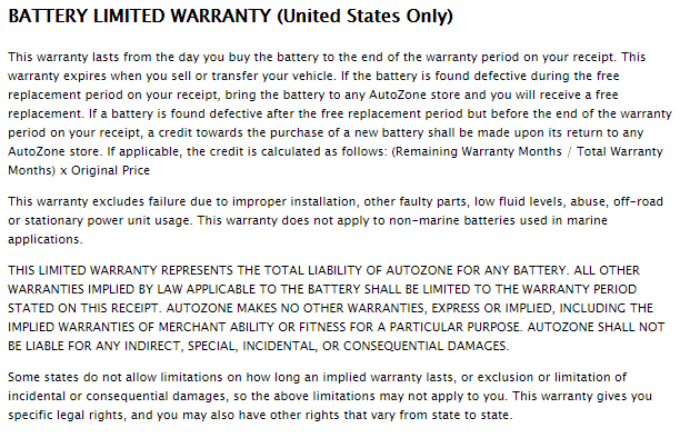

I like that 5 year warranty. does AZ have their warranty where it's a full replacement for that entire 5 years or do they do that Prorated warranty bs?
It's 3 years full replacement and additional 2 years after that pro rated. The one I have going bad is a $100 special from Pep Boys that only had a 36 month warranty so I guess I shouldn't complain about that.
Autozone has a two phase warranty. They give you a period where they will replace for free then they go into a period where it is prorated.
