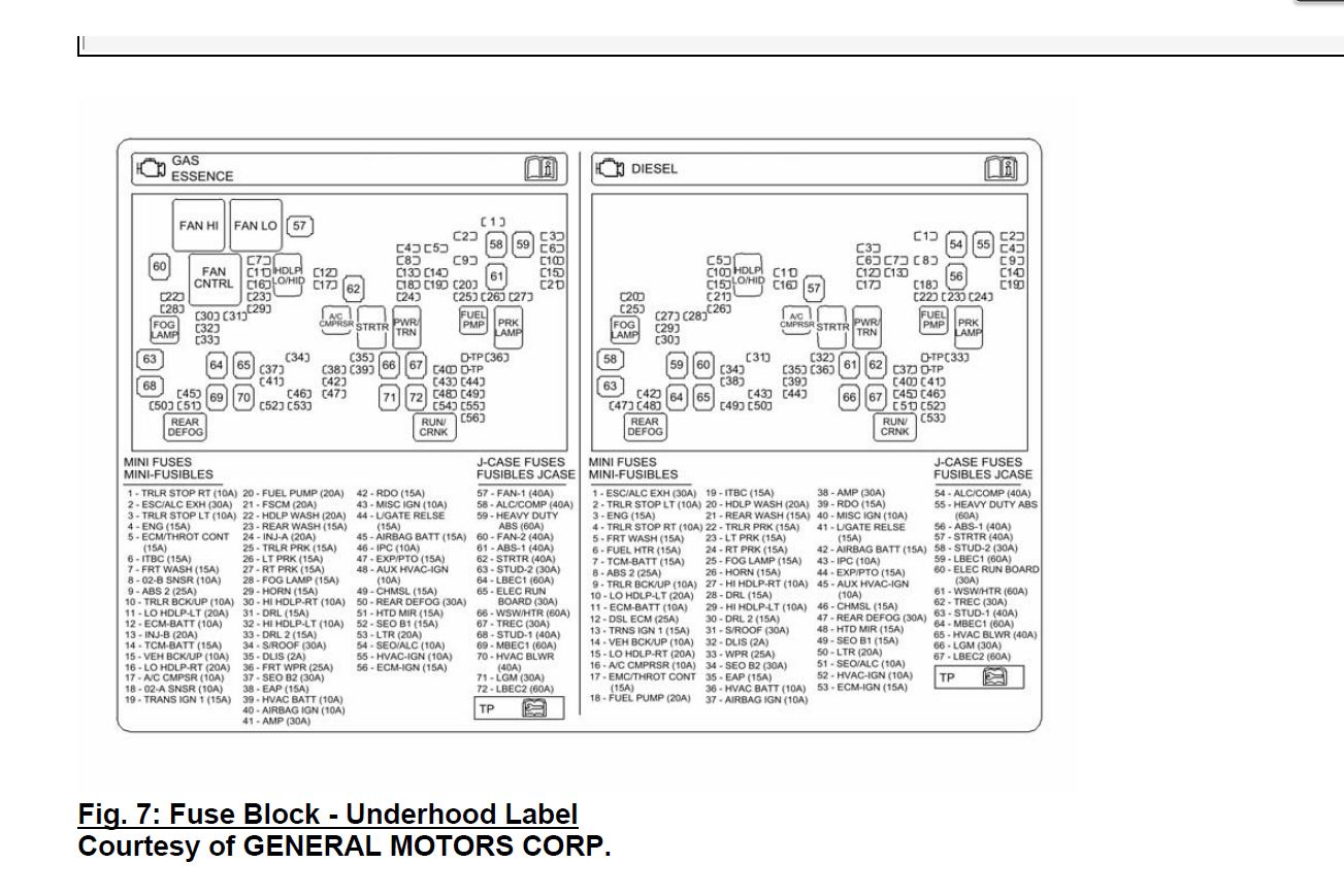

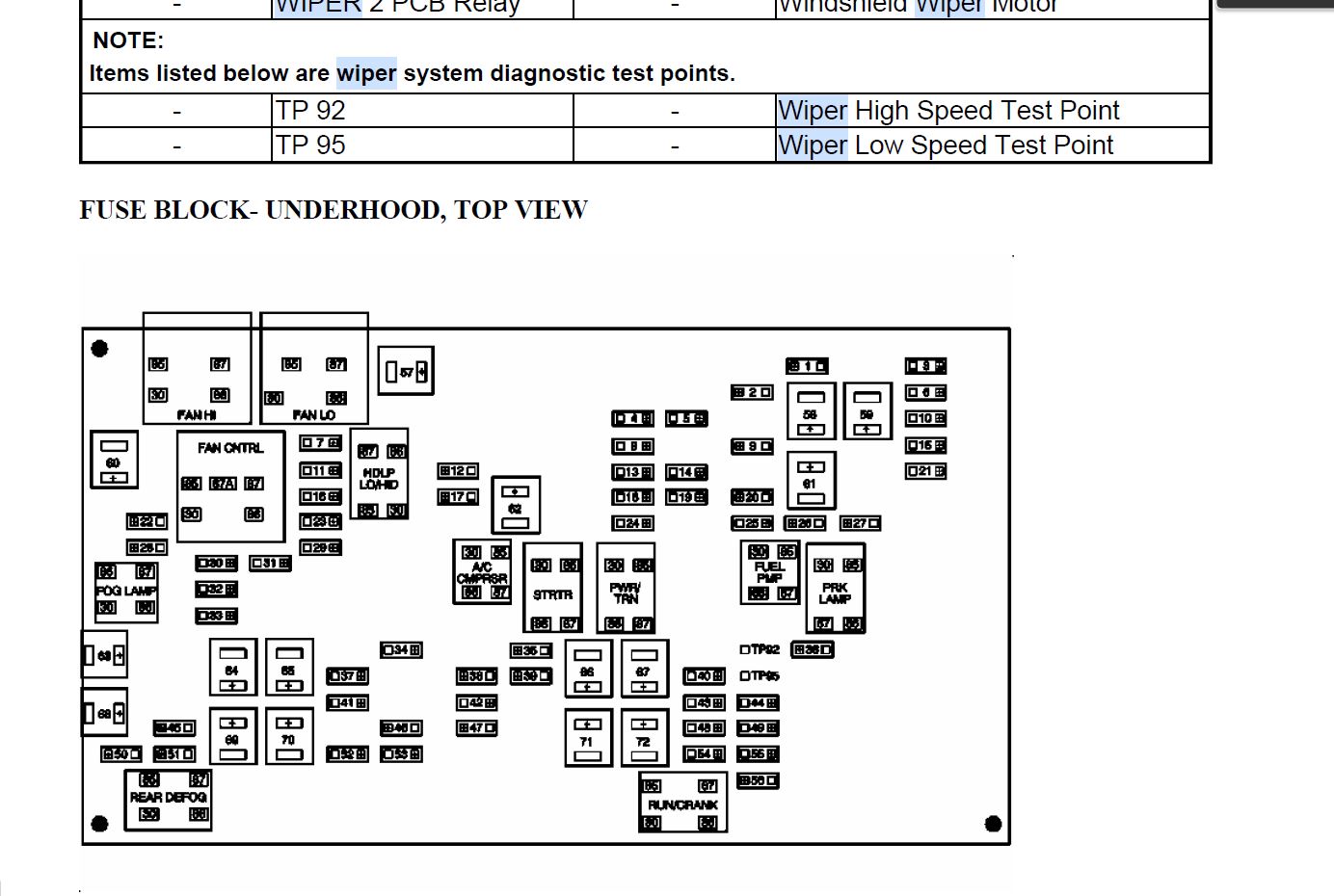

On the way to work today my windshield wipers quit. Doesnt matter what I do, the wipers don’t move. I turned key off, opened door, turned key on, nothing. Also unplugged the rain sensor, didn’t help. Manually activating them doesn’t change anything. I still have turn signals, washer fluid spray, high beams, just no wiper activity. Had to drive the rest of the way to work without wipers. Glad I took back roads and not the interstate this morning. Any ideas of what I could check before I leave tonight?

i will check the fuseFuse..?
They were working just fine before they stopped. They are in normal park positionDid they not work at all or quit working while they were in use? Are they in the normal park position or clocked at a funny angle?

bust out the tech2 and see if it will command them on, if not then probably the wiper control boardOn the way to work today my windshield wipers quit. Doesnt matter what I do, the wipers don’t move. I turned key off, opened door, turned key on, nothing. Also unplugged the rain sensor, didn’t help. Manually activating them doesn’t change anything. I still have turn signals, washer fluid spray, high beams, just no wiper activity. Had to drive the rest of the way to work without wipers. Glad I took back roads and not the interstate this morning. Any ideas of what I could check before I leave tonight?

O.Oi'm reading over the service manual, there talking about replacing a fuse block or the bcm if the wipers won't go, ugh hopefully you just blew a fuse

Hoping they won't rob you blind!Welp. I checked the fuse before leaving work, it was still good. Currently at the dealership on the way home. Got here 90 min before close so they were able to get it in for diag. Will see what they come up with
