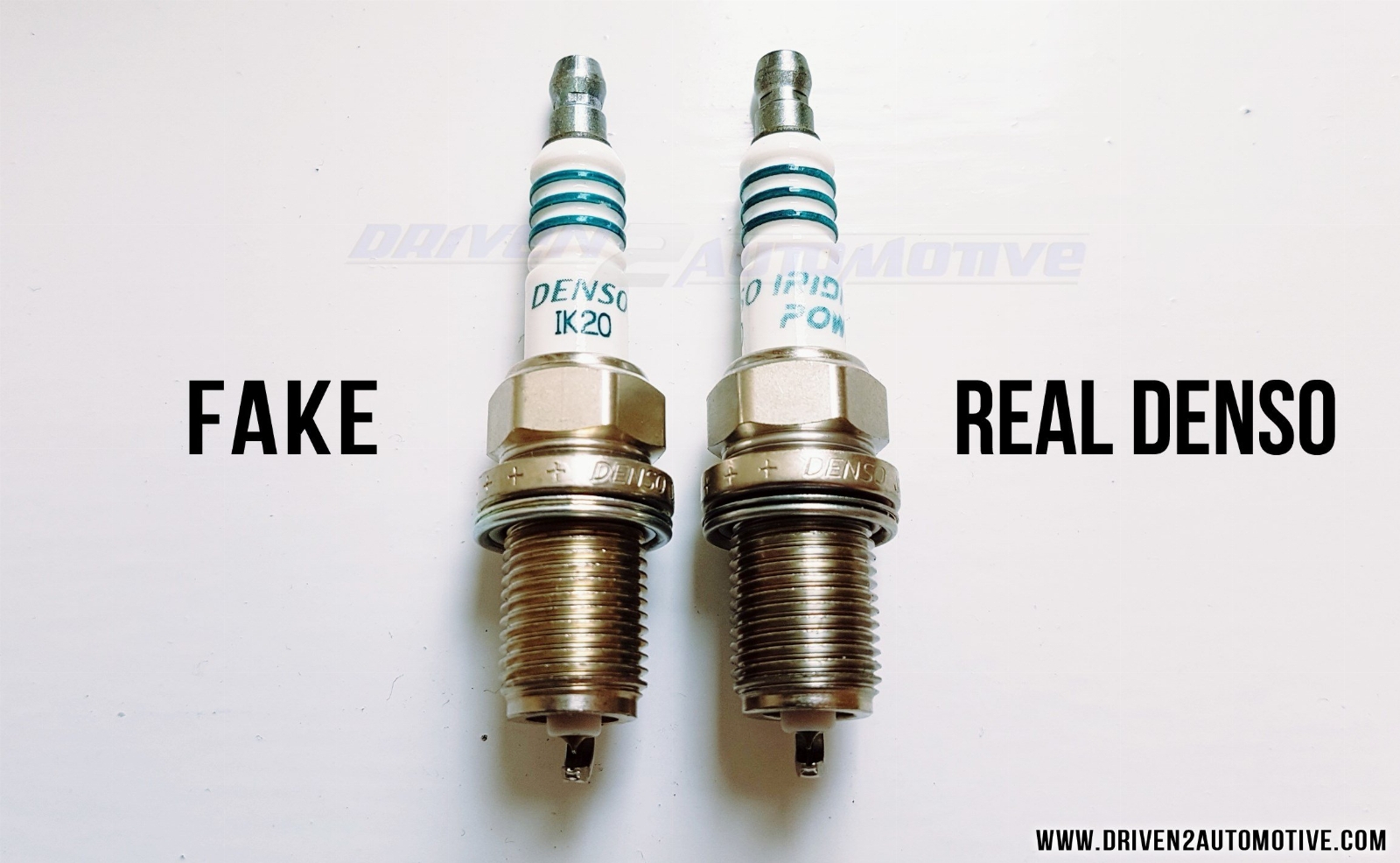

The not-silky-smooth idle is likely just the normal behavior of these things. I'd also question the new plugs- did you get them for a really good price, like around half of what they are elsewhere? Do you happen to still have the packaging? I ask because low-quality knock-offs are in abundance and you have to really know what you're looking at to spot the imposters. You may have swapped old good plugs for new bad plugs.
The plugs look original AC DELCO they came in their original packaging and looked brand new.
I must say though I did not change the gap as advised by the salesman.

If you got them in-person from a salesman, then they're likely legit. The half-priced ebay and Amazon specials are the ones you gotta watch out for.

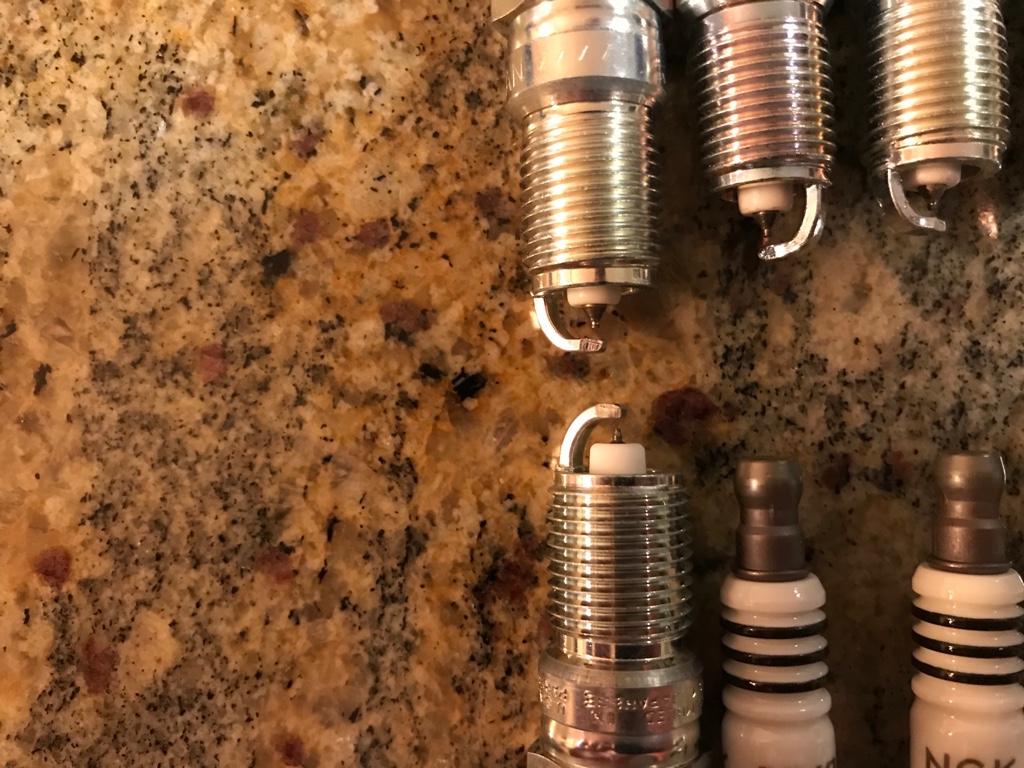

When I changed the 41-110 spark plugs on the 6.2 engine I was told that the plugs are gaped correctly. Upon checking the gap the new 41-110 plugs were all gaped at a tight .030 verified with 2 tools. They should be gaped at .040 , so much for being gaped properly. Long story but I would check the gap on yours. A tight gap will give you the same problems the OP is expressing.

What is the advertised gap, on the box?
Did you check the gaps before installing them?
Thanks for the comment.
I just checked the original box they came in, doesn’t say the gap anywhere. Maybe it’s worth checking out spark plug in cylinder 1 which is easy to get to... I don’t have a gap tool so I’ll probably have to show it to a tech somewhere.
The box didn’t state the gap, I double checked. Also I don’t have a gap tool so I took the guy’s word for it being gapped properly.

Iridium plugs are supposed to come with the gap preset properly for the application. You're not supposed to change it since most standard gap tools can damage the Iridium tip. Yes, you can adjust it, you have to grab the ground electrode with smooth pliers and exercise LOTS of hand control. The AC Delco 41-110 Iridium plugs should be pre-gapped to .040". Even if they were a little tighter, it wouldn't affect it much at all, nothing like what you're experiencing. SES light on? Checked the intake tube for improper reinstallation/leak?
