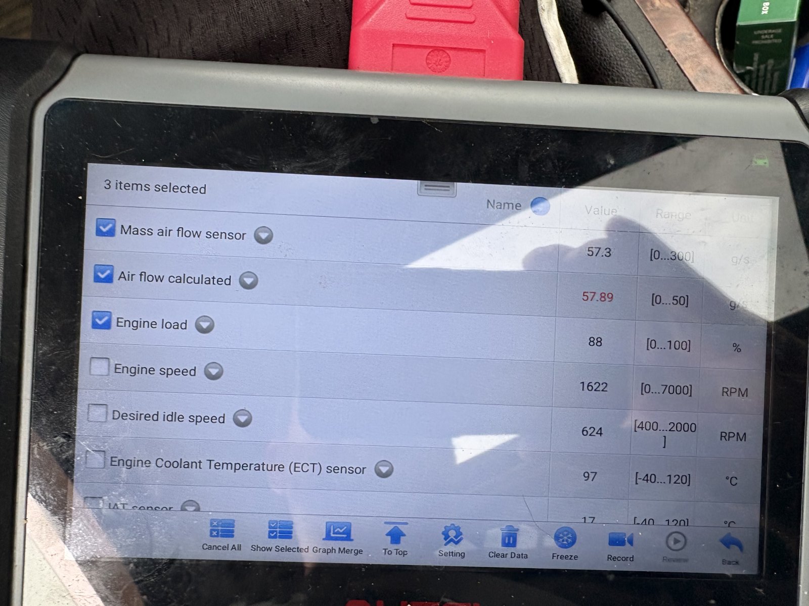

Ok so changed scanner to read g/s and went on a 100 mile trip. My maf seems to be sending some data and it does rise proportionally to the rpms when I’m not driving. When I’m driving mostly they are good. At idle reads 5ish/g/s when I double rpms the g/s double also to about 10. I still misfire on cylinders 3&4 when idling under no load but all misfires go away when over 1200rpms according to graph and scanner. Also fuel trims at idle when misfiring are bad bank 1 -13% and bank 2 -22% but fuel trims almost even out completely while driving to around 0’s. Now for strange part last night when I was going uphill the Tahoe started losing power and rpms dropped to about 1500 and Tahoe was “pulsing/bucking” a hill. Also dash lights dimmed. Happened a few times so looked at scanner during on uphill pass and when it was doing it uphill I noticed each time the Air Flow Calculated PID would always go red when it happened. I’ve attached a pic

Side note I made sure to check O2 sensors and they are new and reading good and went with genuine gm. After all this I’m starting to think it’s time for a leak down test to see if I got a leaking valve. Course that wouldn’t explain the misfire on 3 AND 4 cause there on opposite banks….in just don’t know lol
