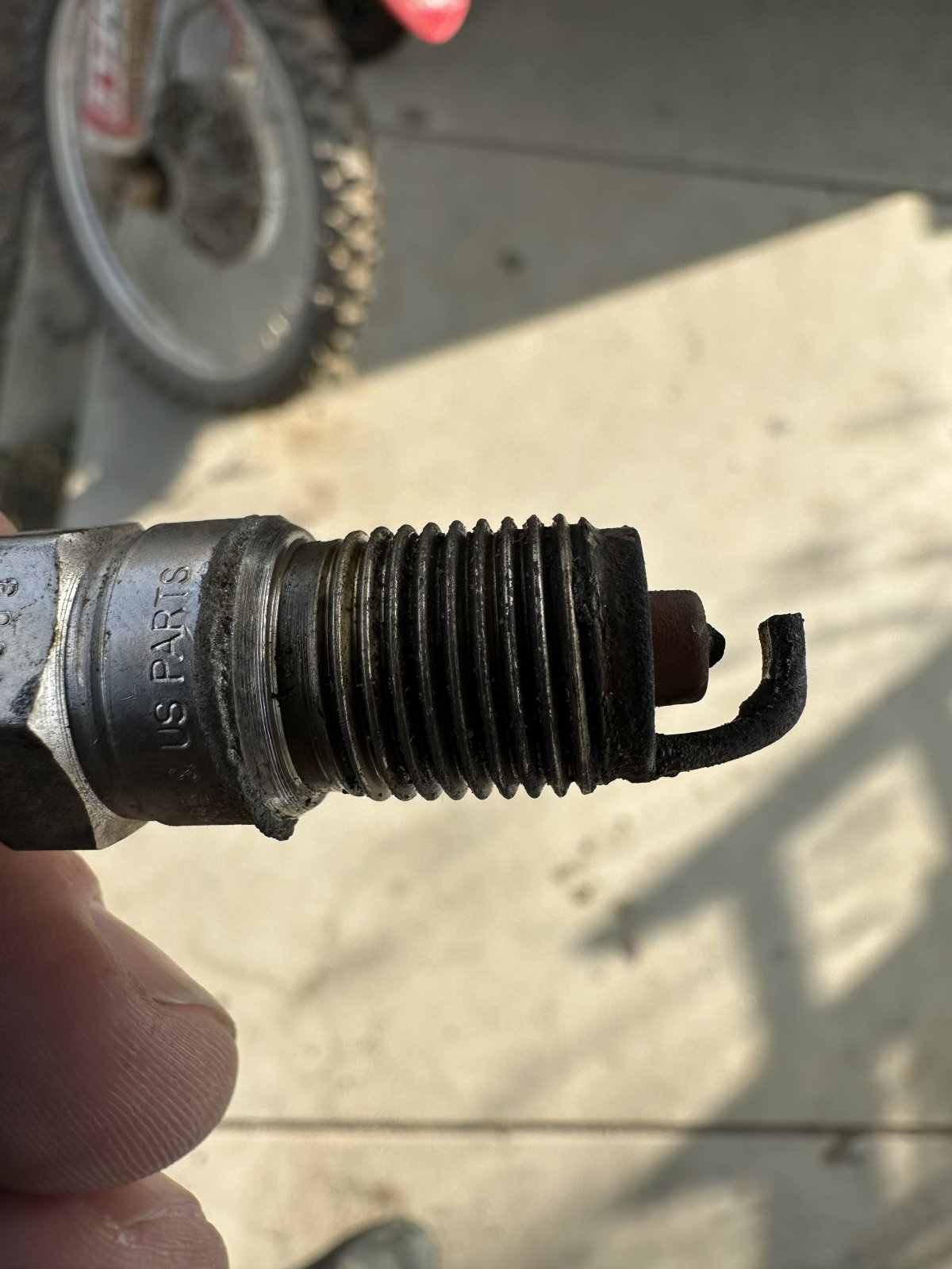

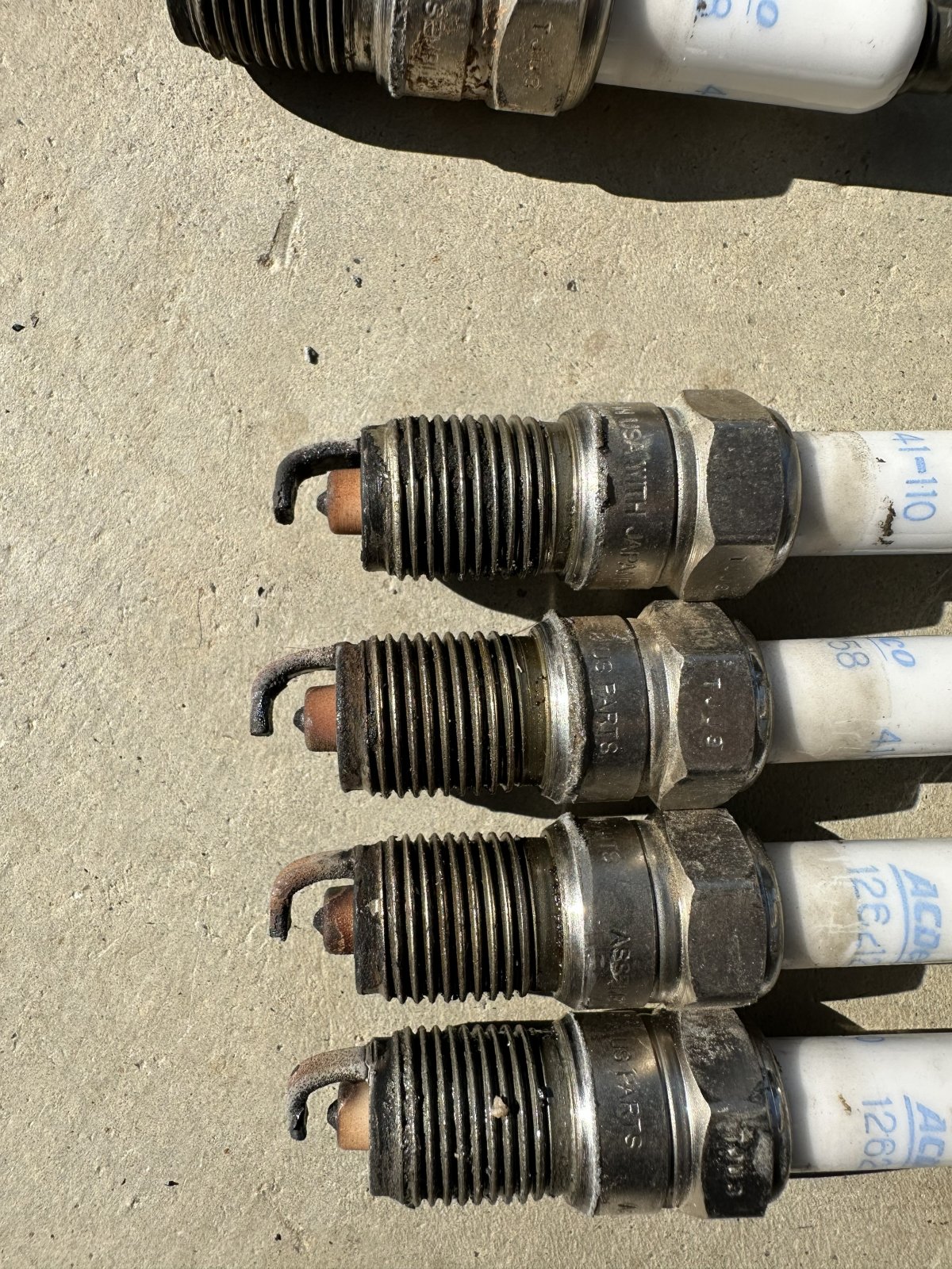

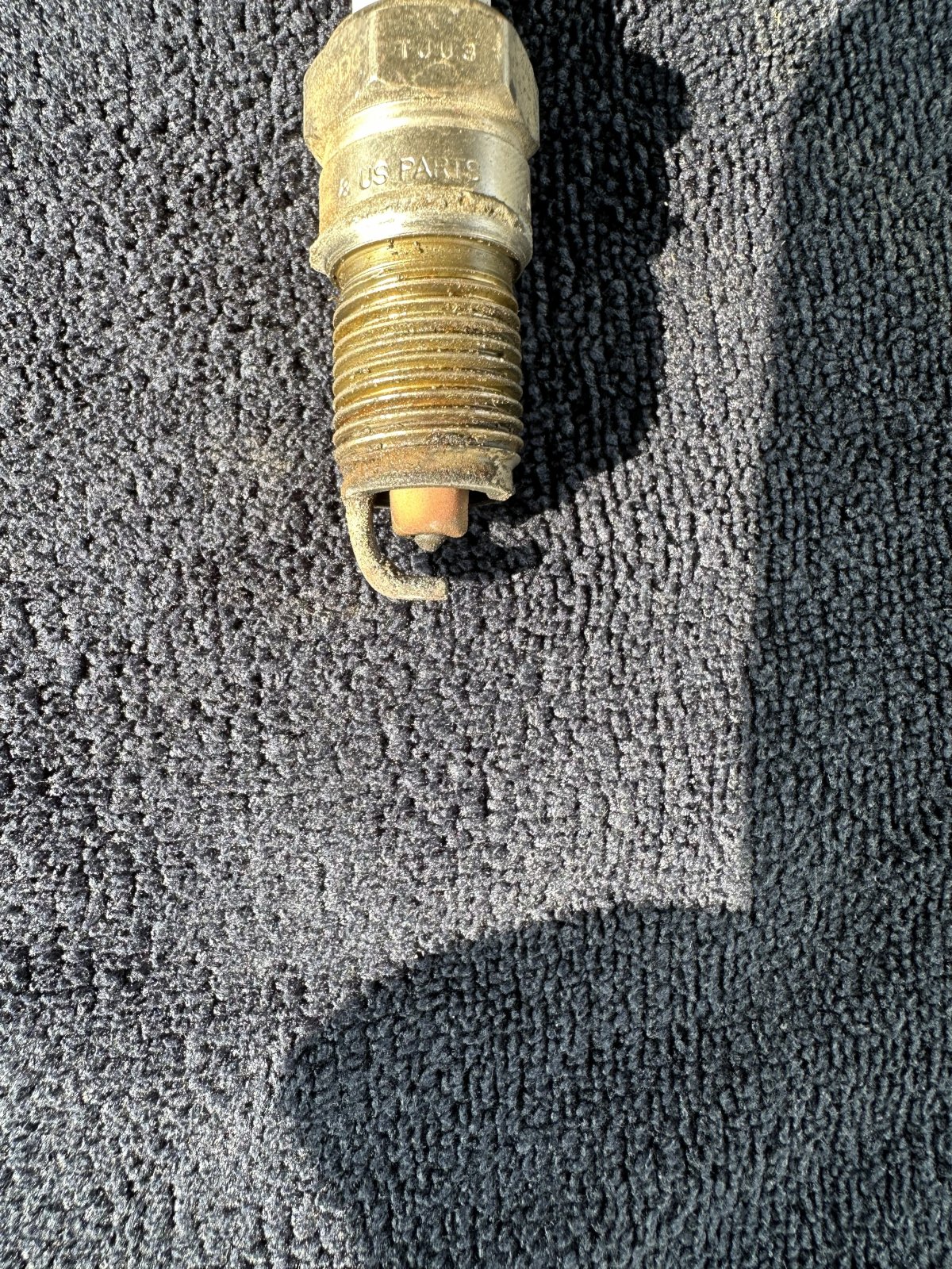

So, I've been dealing with a slight annoying rough idle issue for as long as I can remember. I've shot the parts cannon at this thing with no avail. So, after watching the following YouTube video by Royalty Auto Service which got me thinking were did I get the plugs and wires from? Well, you guessed it the ACDelco Iridium 41-110 plugs I bought off of eBay for a whopping $24.00. RockAuto who I believe is one of the most cost-effective places to buy genuine GM parts sells 8 ACDelco Iridium 41-162 plugs for $6.74 ea. or $53.92 for 8 of them. So, what the hell did I expect for 24.00. As you can see by the attached picture, I did NOT get Iridium plugs! After purchasing new plugs and wires from RA I now no longer have any sort of rough Idle, and she purrs like a kitten. Moral of the story, you get what you pay for. BTW I only put 27,693 miles on those fake plugs.
