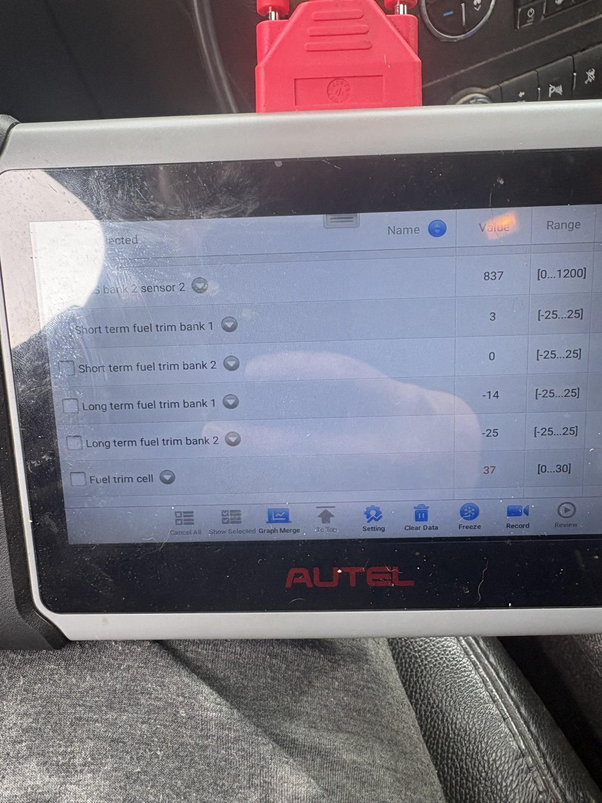

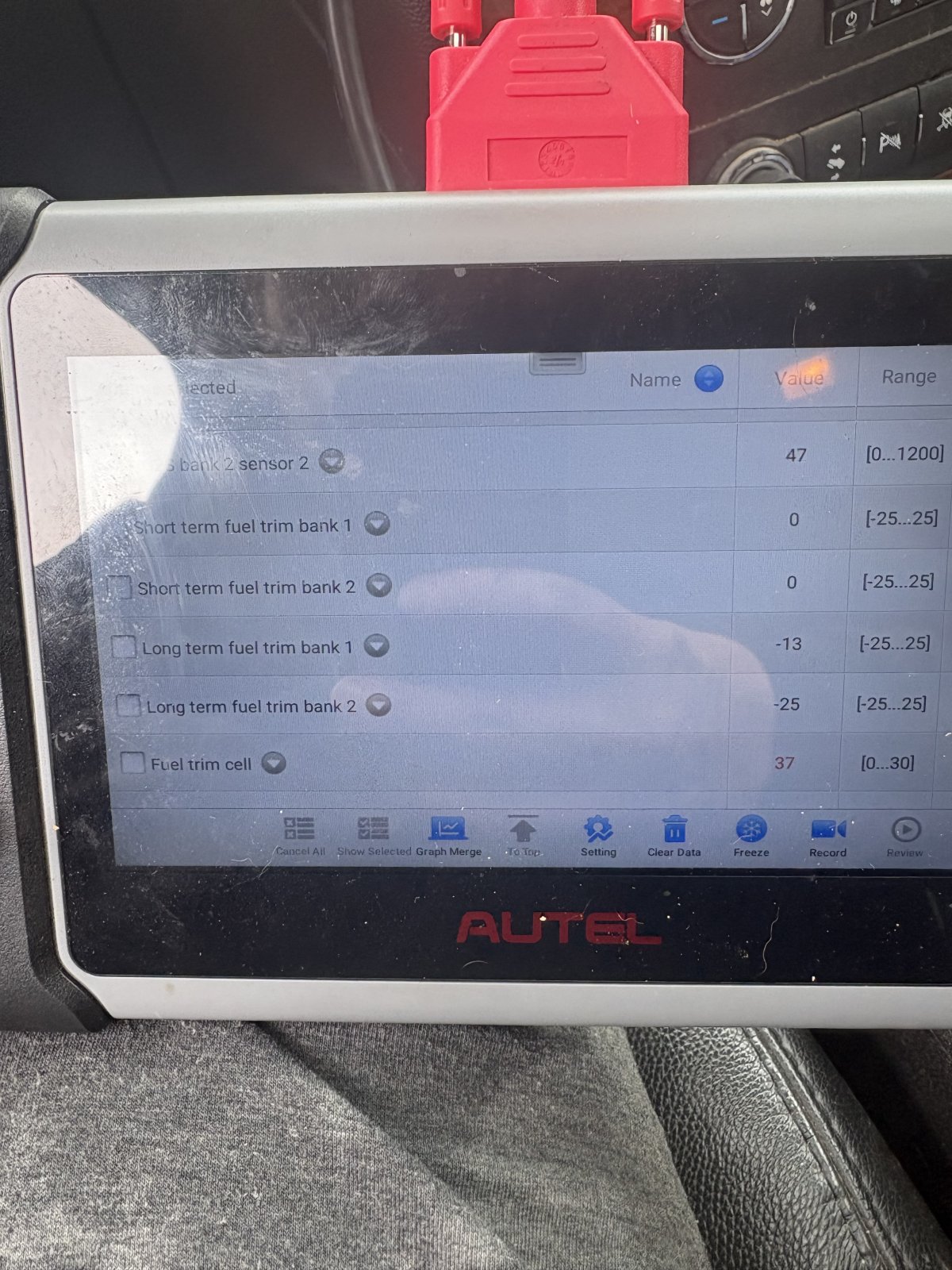

Here is 2 pics I took earlier today of fuel trims. Side note when I checked for vacuum leaks I did a smoke test from a few different locations. Also tried the propane test all around and for S&G also did the carb choke cleaner spray test all around.

I wouldn't keep looking for a vacuum leak -- just the opposite. While LTFTs at -14 aren't awful, when they're good they will be closer to 0. -25 LTFTs for bank 2 (passenger side) are what trigger the money light, and that shows that there is way too much fuel on that bank. ST and LT fuel trims for each bank should be added together for the overall fuel trim value: in your latest 2nd pic the Bank 1 overall FT is not too bad at -11% (still a bit high), but the Bank 2 overall trim is -25%.
I would suspect a leaky or over-fueling injector, especially if aftermarket injectors are in use. A leaky injector might cause hard starts, but minor leaking or over-fueling might not. An injector balance test could confirm or disprove that as a cause.
If it's been rich for a while -- which seems to be indicated by the LTFTs -- there could be fuel vapors in the intake, crankcase, and oil so that would keep things rich until the cause is corrected and it has time to burn off the vapors.
Did we ever see what the running fuel pressure is, or did I miss that?
Also, what composition of gas (E10 - 10% ethanol, E85, etc.) is it using and what does the scanner report for the calculated ethanol/alcohol percentage? Are those ethanol percentages similar, say, within 10% of each other?

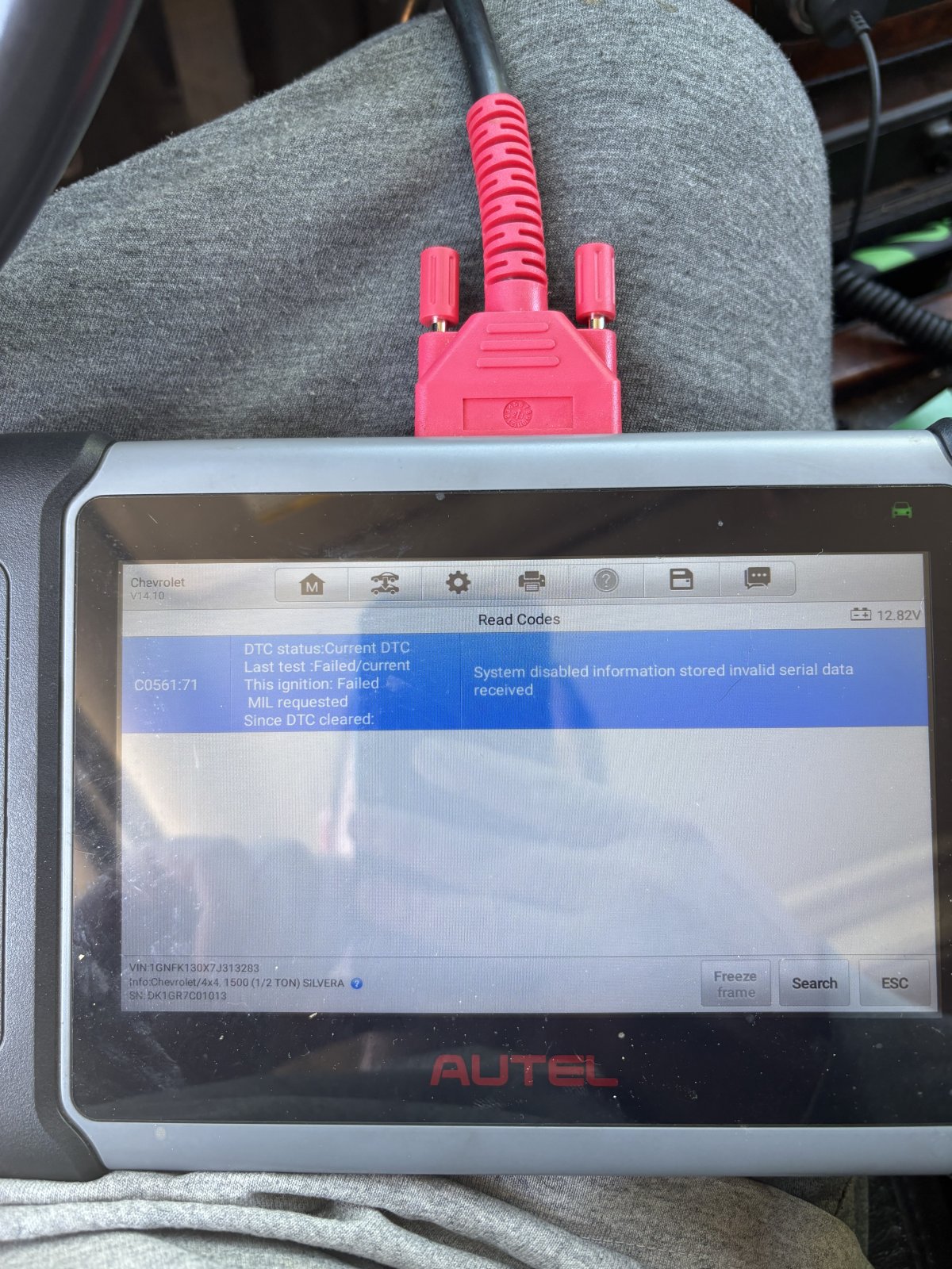

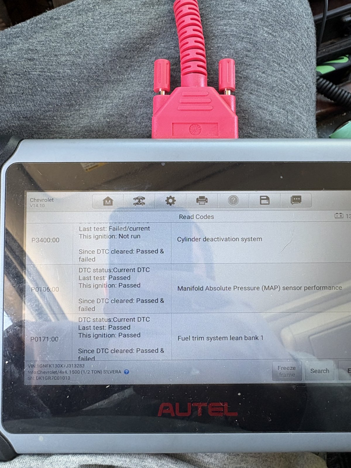

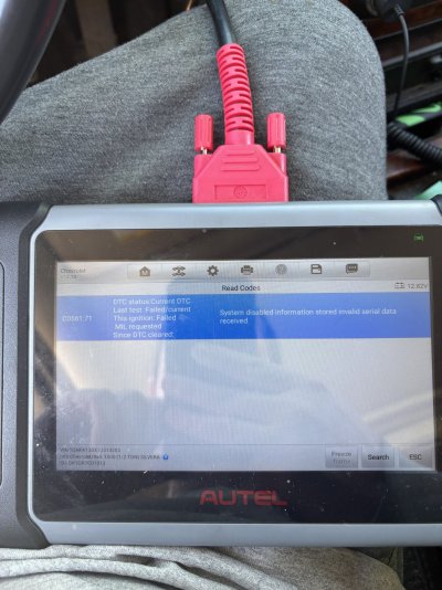

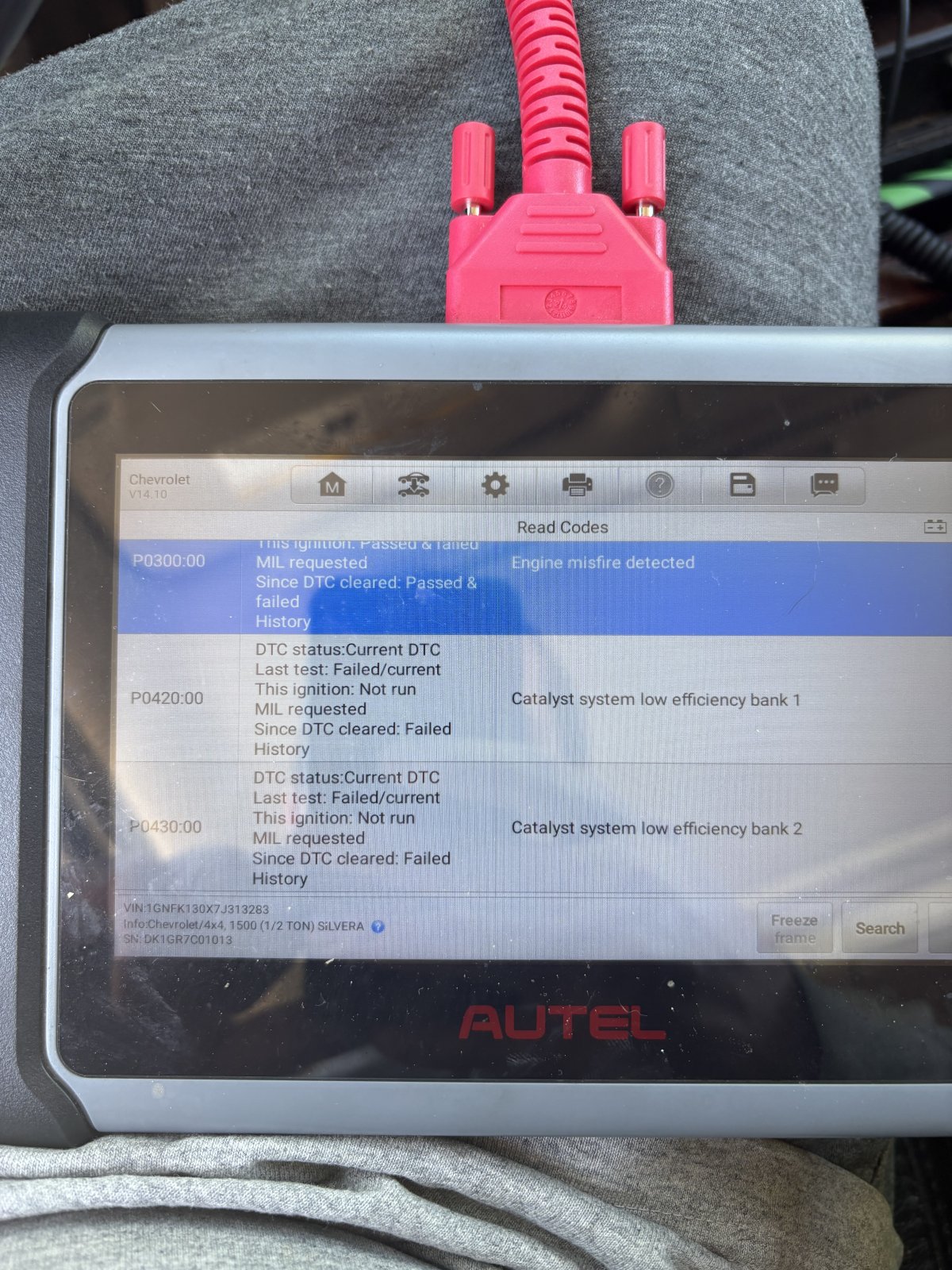

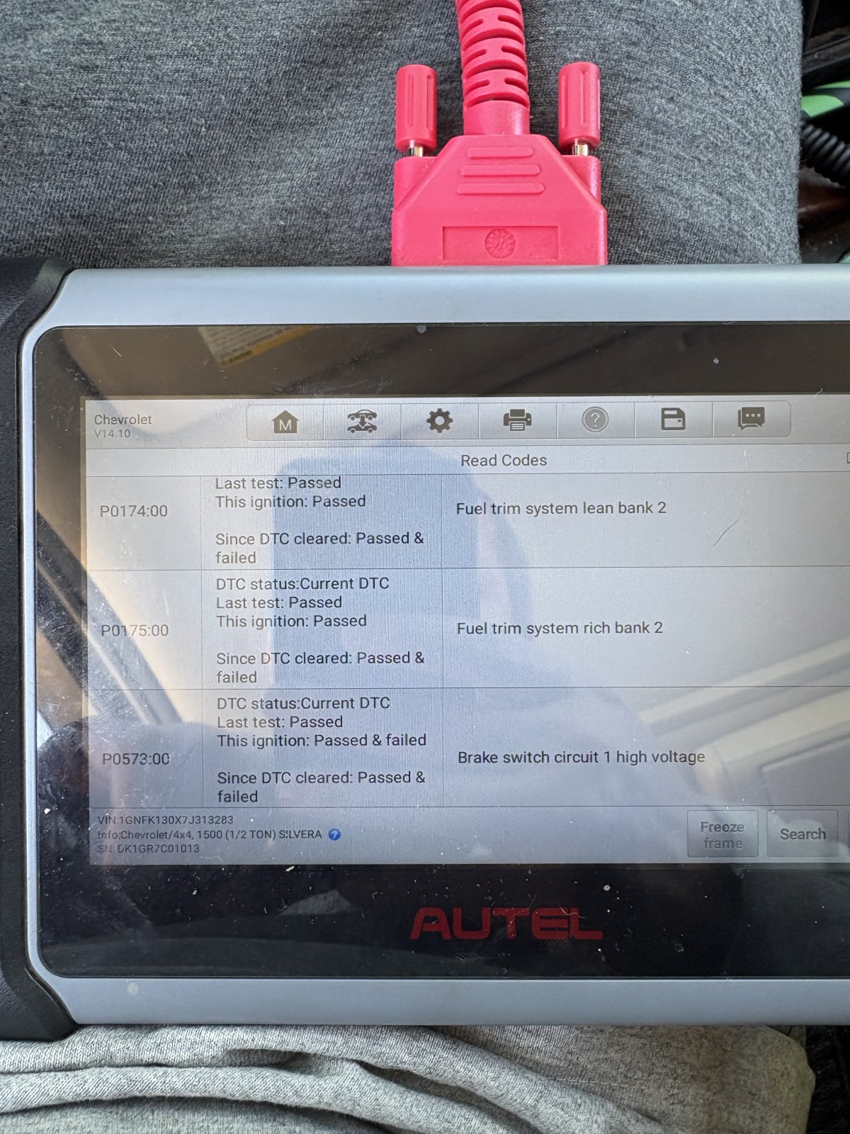

Ok so fun update. Unplugged the range obd2 afm disabler for first time in 5 years and went driving around town. She runs a lot rougher with it unplugged and has harder misfires. Also seems it was blocking some codes being plugged in cause I got a few lol. Got a
P3400- afm issue though it’s on opposite bank as misfire
P0300 random mis but scanner shows it on 4
P0420&p0430- assume caused by steady misfire
P0106- MAP performance
P0171-bank 1 lean
P0174- bank 2 lean
P0175- bank 2 rich
P0573- brake switch circuit
Stabilitrac warning popped on twice also and caused blinking CEL. This is starting to seem like when I was chasing a misfire on my 2015 Silverado finally after checking literally everything else found a dead lifter

I consider risky to unplug a disabler thousands of miles after it was plugged in.... No data to back that up, but left unused for so long would make me very cautious.
I'm assuming you plugged it back in and you're back to misfires on only the two cylinders? Might as well pull the valve covers and check for a collapsed lifter I guess.
After rereading everything, I lean towards a couple bad fuel injectors..... But now you have to check on those lifters. I also wonder about the disabler itself. No idea what happens when they have an internal failure.
Interesting.... While unplugging the disabler may have further convoluted the situation, by the same token it may actually be pointing to the problem.
I noted your compression reading was 150? That's at the very low end of what I'd expect. A partially collapsed lifter could give you the low compression reading....but.... On two opposing cylinders at the same time? That seems doubtful. Especially since one is an AFM cylinder and the other is not.
