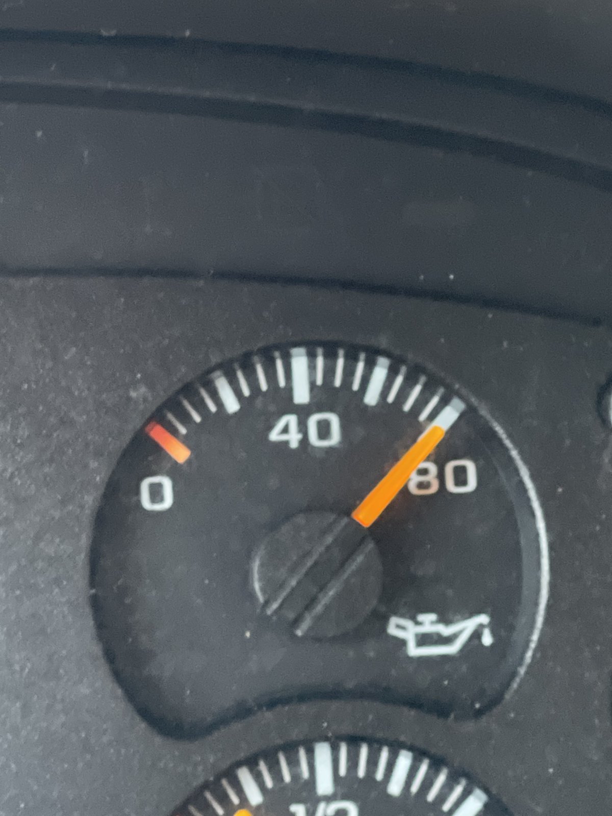

It’s pegged at 80 so I’m not sure if that’s the actual pressure or if the oil pressure sending unit is bad.

It’s pegged at 80 so I’m not sure if that’s the actual pressure or if the oil pressure sending unit is bad.View attachment 364430
Definitely seems suspicious.
Have you checked your oil level? When was your last oil change filter change? Might want to get a analog gauge on there and see what the actual pressure is.

Yeah. Oil level is good and clean. I had an oil change about 300 or so miles ago. I’ll have to try out an analog gauge.
What does the oil pressure gauge read with the key to 'run' and engine off (KOEO)?
You might also see what the oil pressure PID reads with a scanner, KOEO, and with the truck running.

It reads 0 when it’s in the run position. I’ll have to try a scanner tomorrow.

Check the connector on the oil pressure sensor.
According item #2 to the post below, a gauge pegged to the max. could be result of a disconnected sensor.
Could also be a broken wire or bad connector...
Start there, with an inspection at the connector and wires to it.
This was posted on ChevyForum.com. Maybe it will help you figure things out on whether it is your gauge or the sensor...
(1) Check the oil level and correct as necessary. Turn the ignition switch on, but do not start the engine.
(2) Disconnect the sensor lead at the sensor. The gauge should read full scale.
(3) Ground the connector. The gauge should read at the bottom of the scale.
(4) If the gauge functions properly, replace the sensor.
