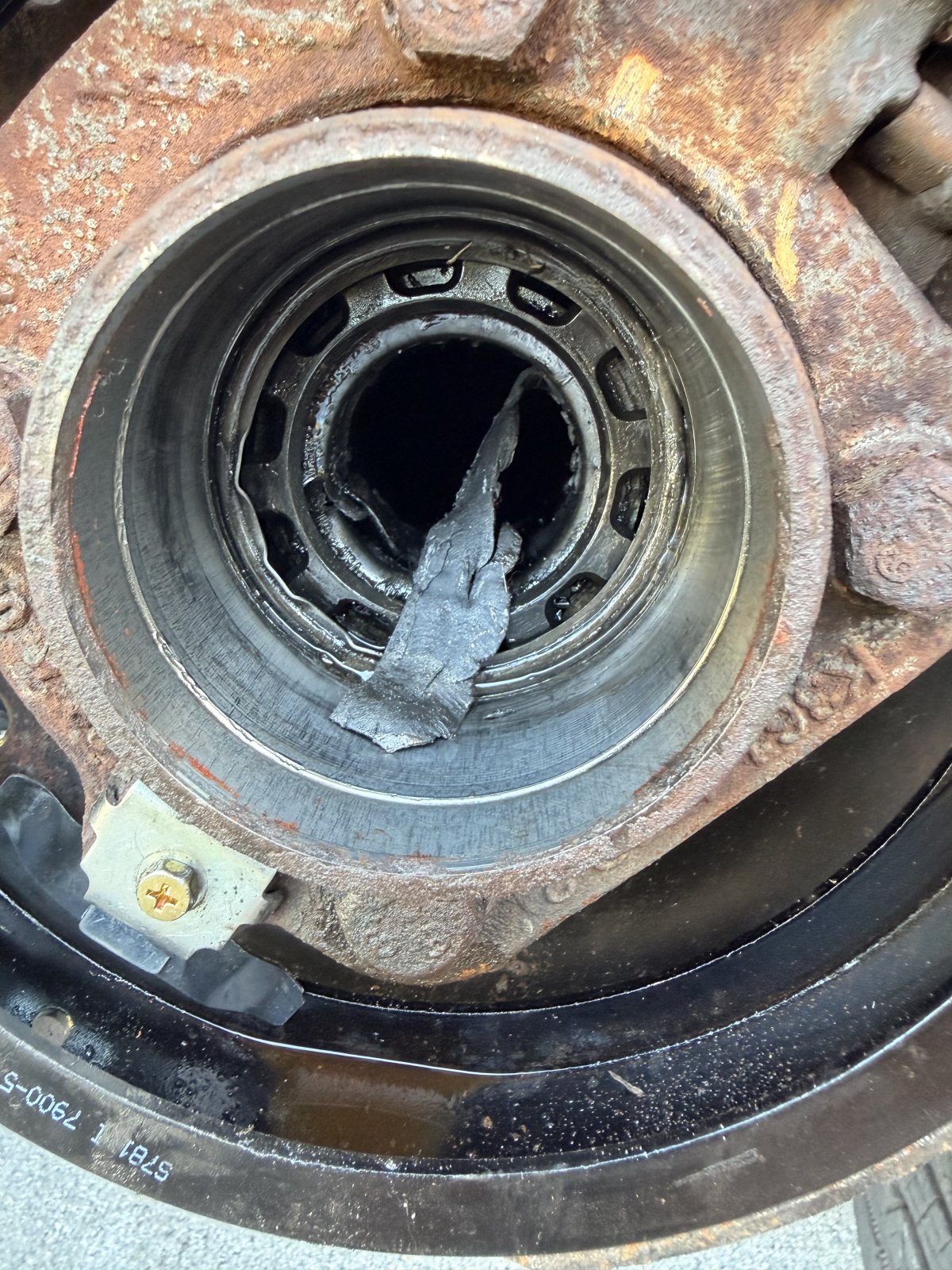

Well all it’s been awhile , and the hoes been sleeping in the yard the past few years - got her running recently and driver side rear wheel started smoking - hoping it was sticky calipers but the smell doesn’t lie - the smell of burning shit that is…. , pulled the rotor off and got to see the parking brake completely disintegrated and everything caked in burnt diff oil - got the outer seal and bearings out and I’m not quite sure what I’m looking at and don’t see any videos on the this inner race seal , so any advice would be greatly appreciated.

looks like the inner race is torn, have fun with that...
if you can find a small crow bar then you can probably get it out, wedge the tip in and then pound it out
beware the rear abs sensor ring is just behind there, don't mess that up.

the tone ring is back father behind the bearing, just letting you know it's there so don't shove anything down the tube that shouldn't be there.

Yeah I ordered and replaced it - ABS TONE RING if anyone ever comes across this on there Tahoe.
