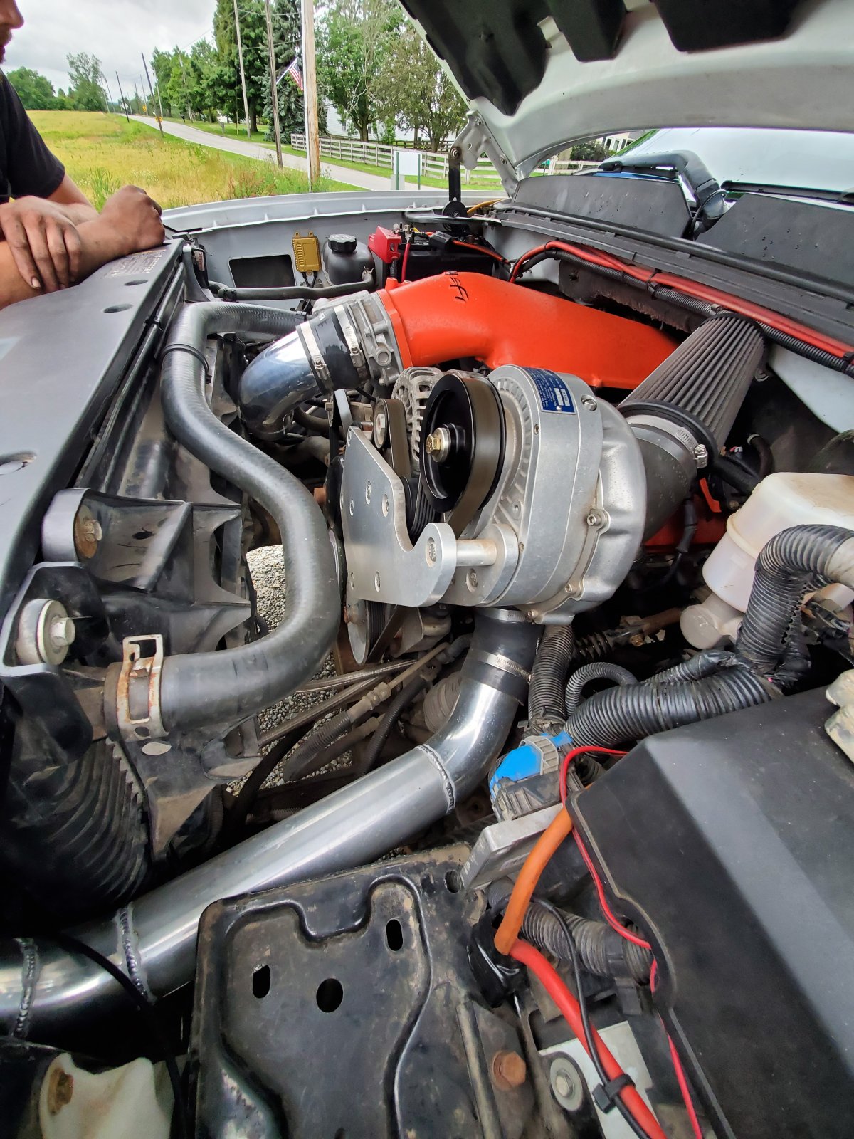

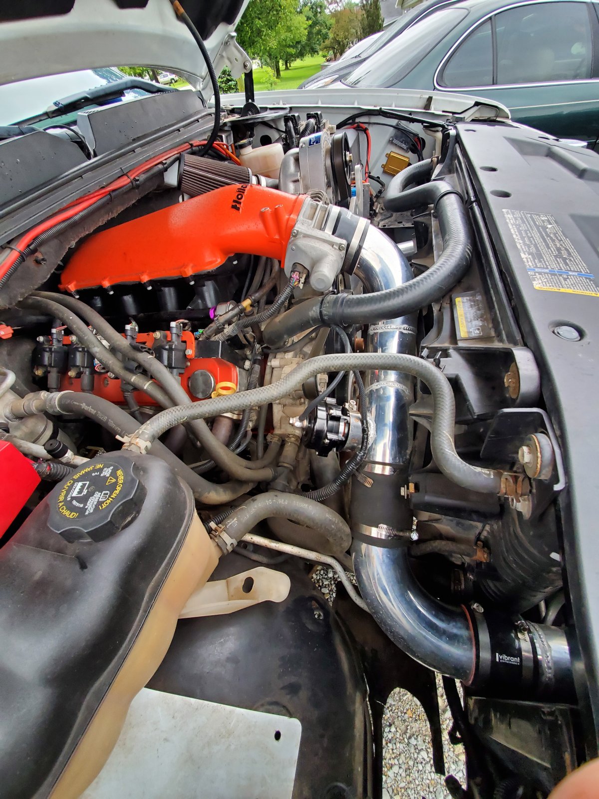

For a small fee I can fix you up there too no stupid lifter issues with this beast.

You don't think she would enjoy 800hp?
Now I never said she wouldn’t enjoy it I’m sure she would, but does she need it no. Lol
The goal with this is to be reliable for her. Honestly didn’t think I would be doing lifters on it so soon
