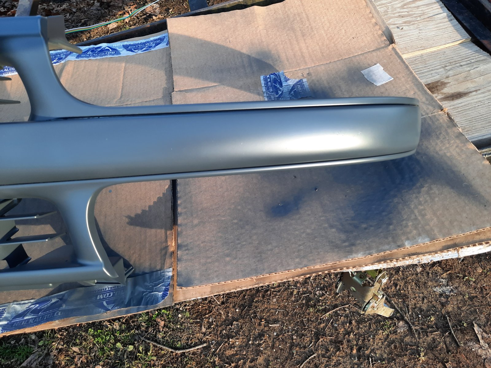

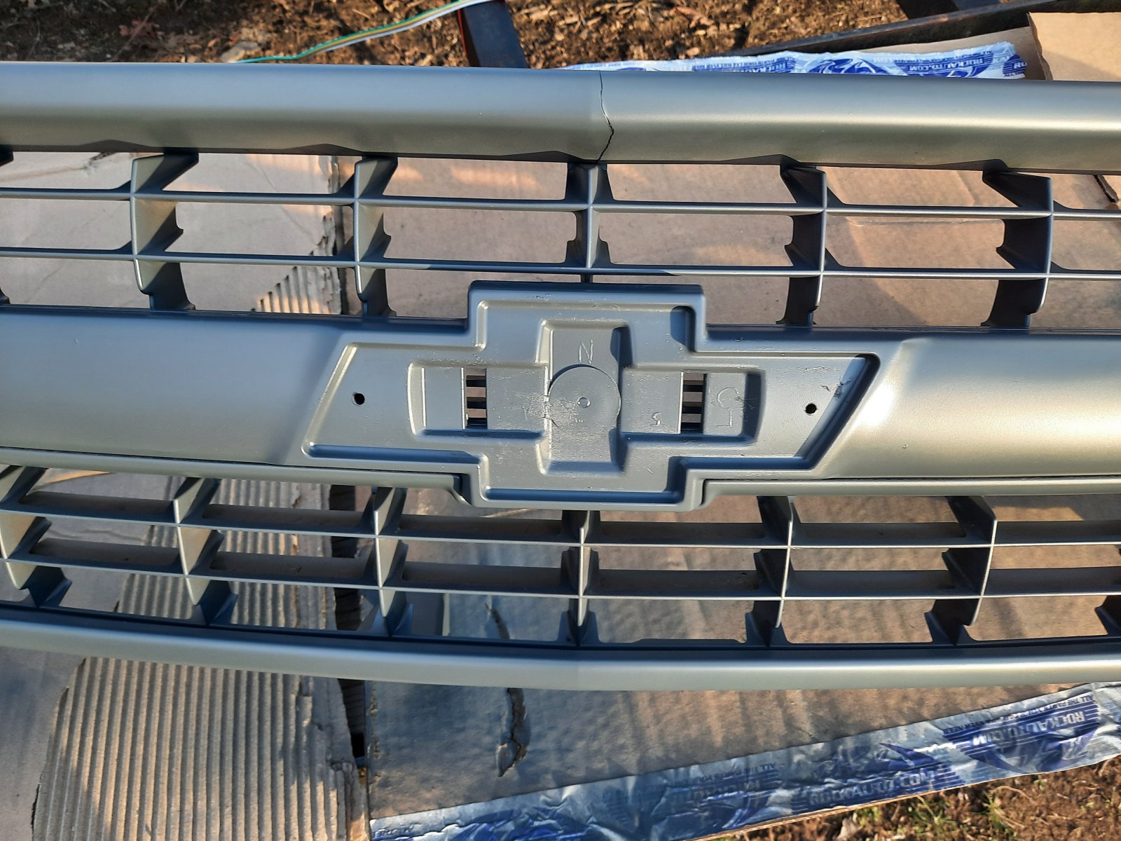

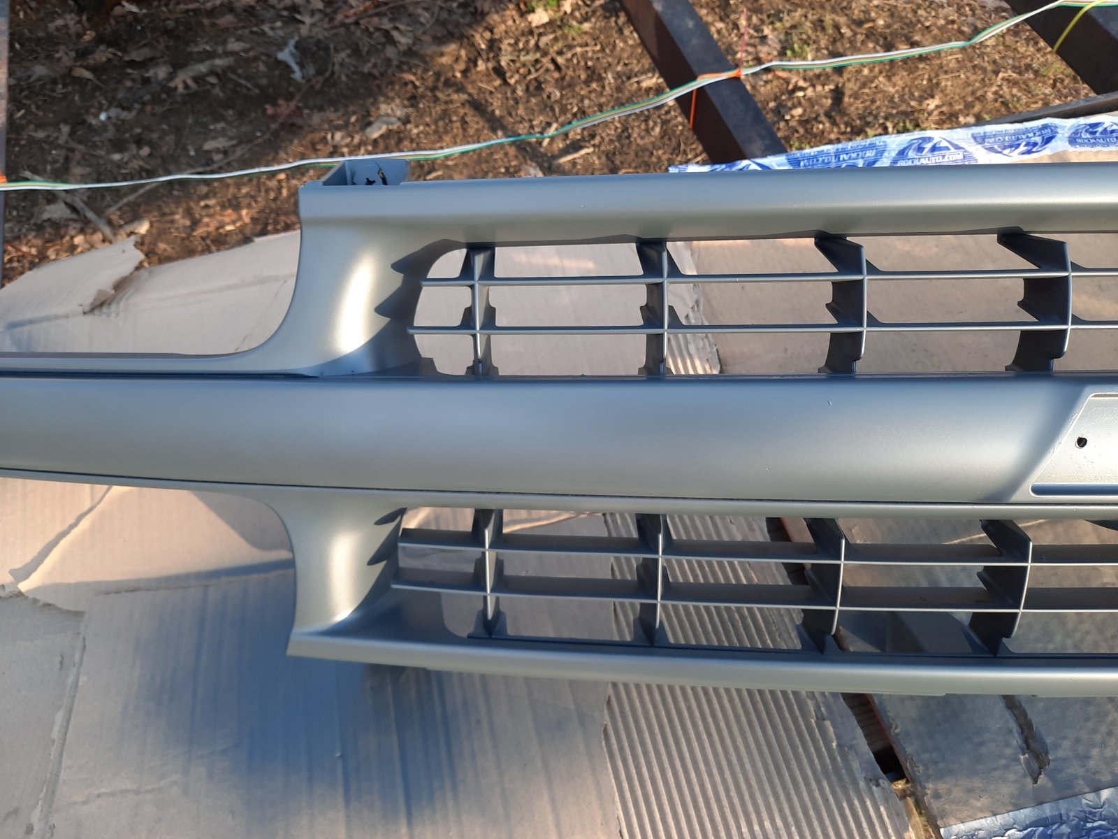

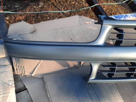

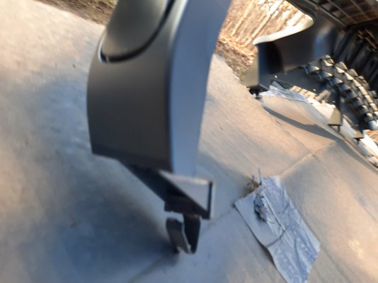

I started painting my grille yesterday with some rustoleum slate gray paint and primer combo. I still have more to do to it but here it is thus far.
26,678
52,943

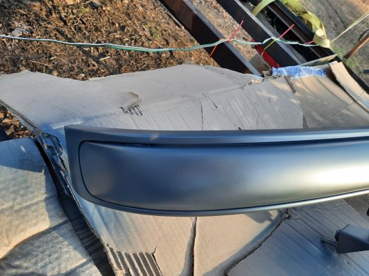

All painted clear coated and reinstalled.
Looks good. One question-why didn’t you color match it? Automotivetouchup.com sells spray cans in your paint code plus clear coat, it makes it pretty easy. I’m no expert painter and I’ve done some parts that way that came out great. Just a thought.
