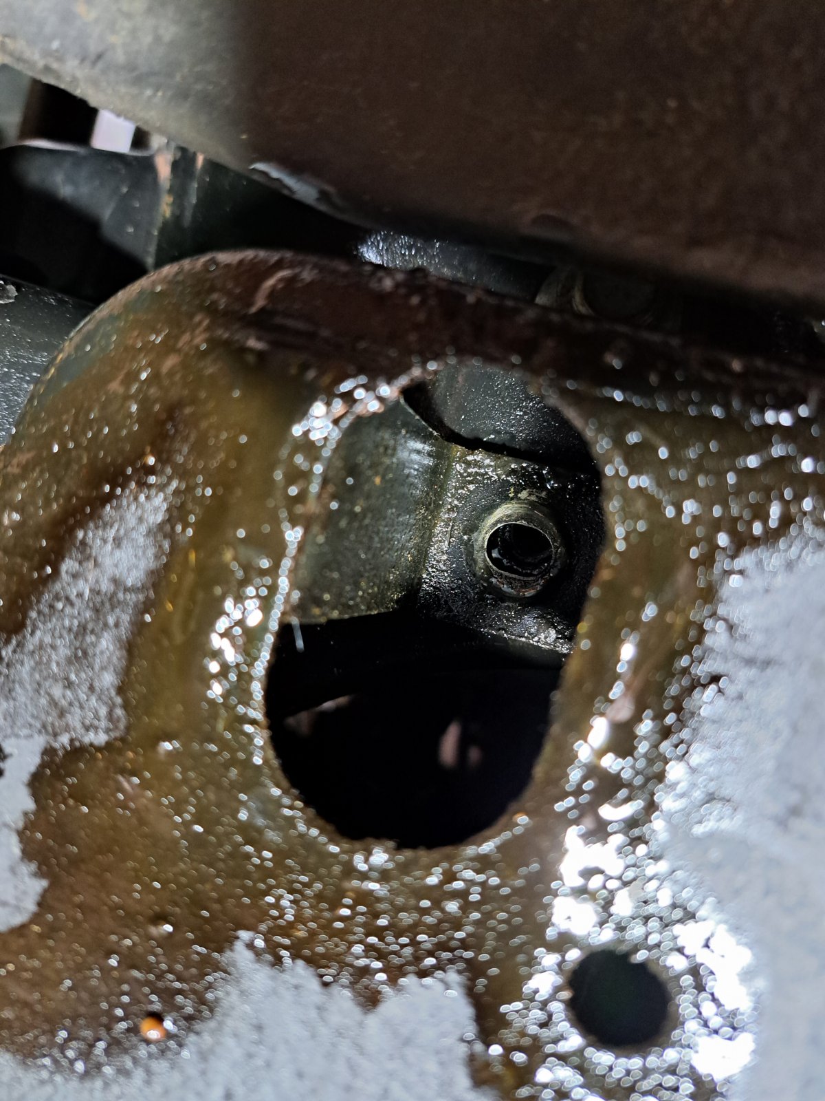

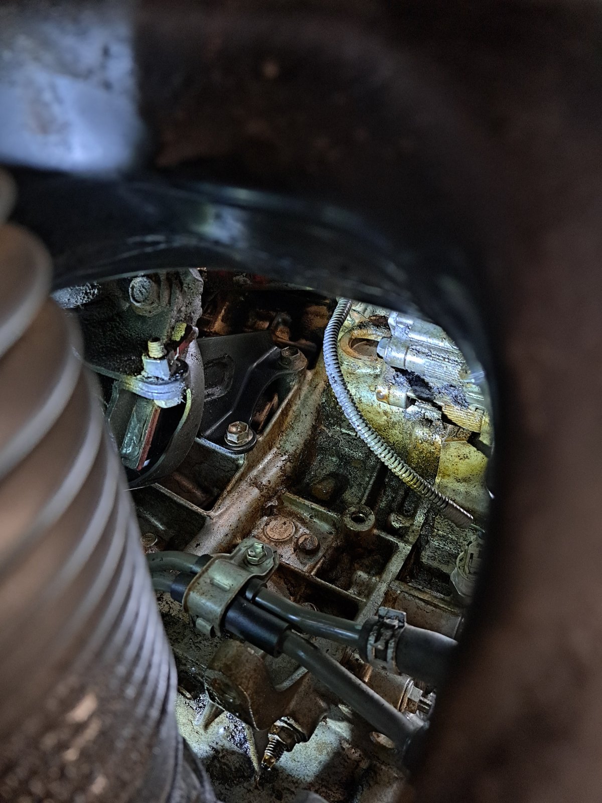

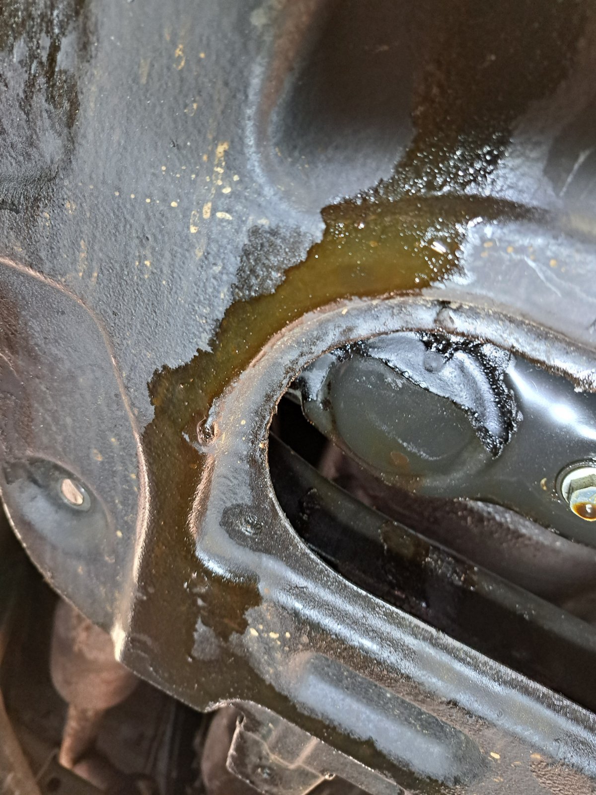

Well, the 2010 FJ Cruiser was dropped at 4:30. The lower engine covers were wet with oil. I removed them and immediately saw a wet p/s pump that had drops on it. But the p/s level was at full and the same place where I saw it a couple days ago. The oil level was down though from when I checked a couple days ago. The oil leak looks like it is coming from above the p/s pump and am thinking the valve cover. My previous gasket and oil sender are dry. Gonna let cool overnight and tomorrow morning I am gonna remove the air snorkel and as much as I need for sight access and see if is the valve cover. No, in the pic, the oil pan drain plug is not leaking.

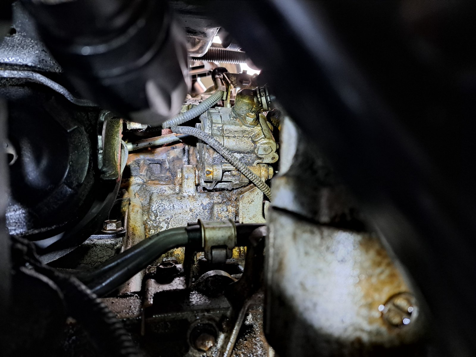

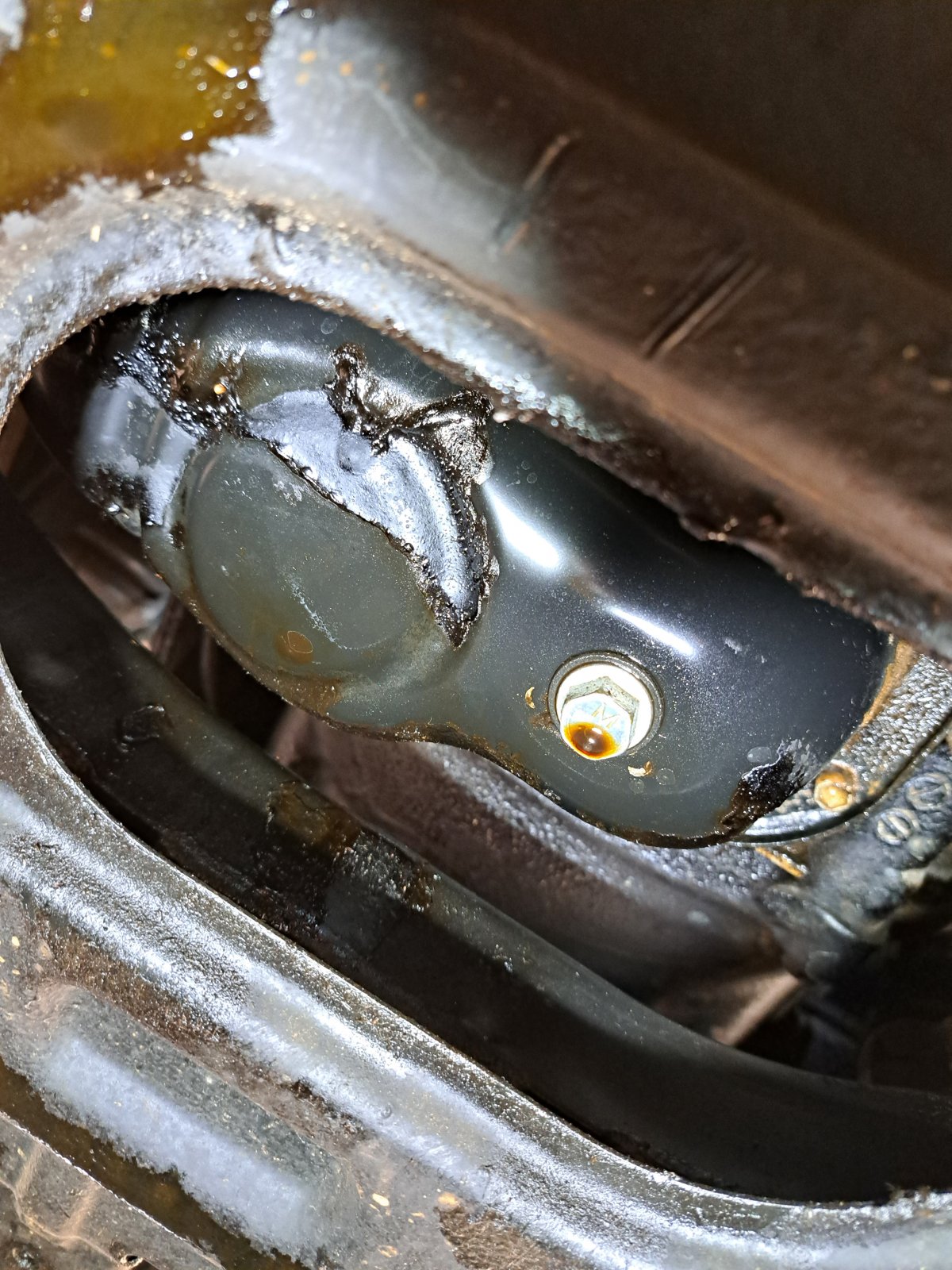

This morning, on the 2010 FJ Cruiser 4.0, removed the air filter housing and the complete snorkel assembly but left it all plugged in and started the engine and waited for oil drops. After about 10 minutes, saw fresh oil drops hanging from the power steering pump and verified that the timing cover was leaking from the junction where the back of timing cover and the front of the head complete the shelf for the valve cover to seal against. That work is beyond my space capabilities and my desire to have such a long job. My friend that just opened the shop, see my post of flatbed truck bringing in his tool boxes, is going to do the work. Gonna do timing chain complete set and water pump and fan clutch and belt.
Could I have done it, yes. Could my back handle it, maybe. Would my 70 year old body have ached for days, very much so. Pic shows fresh oil drop at bottom of p/s pump.
