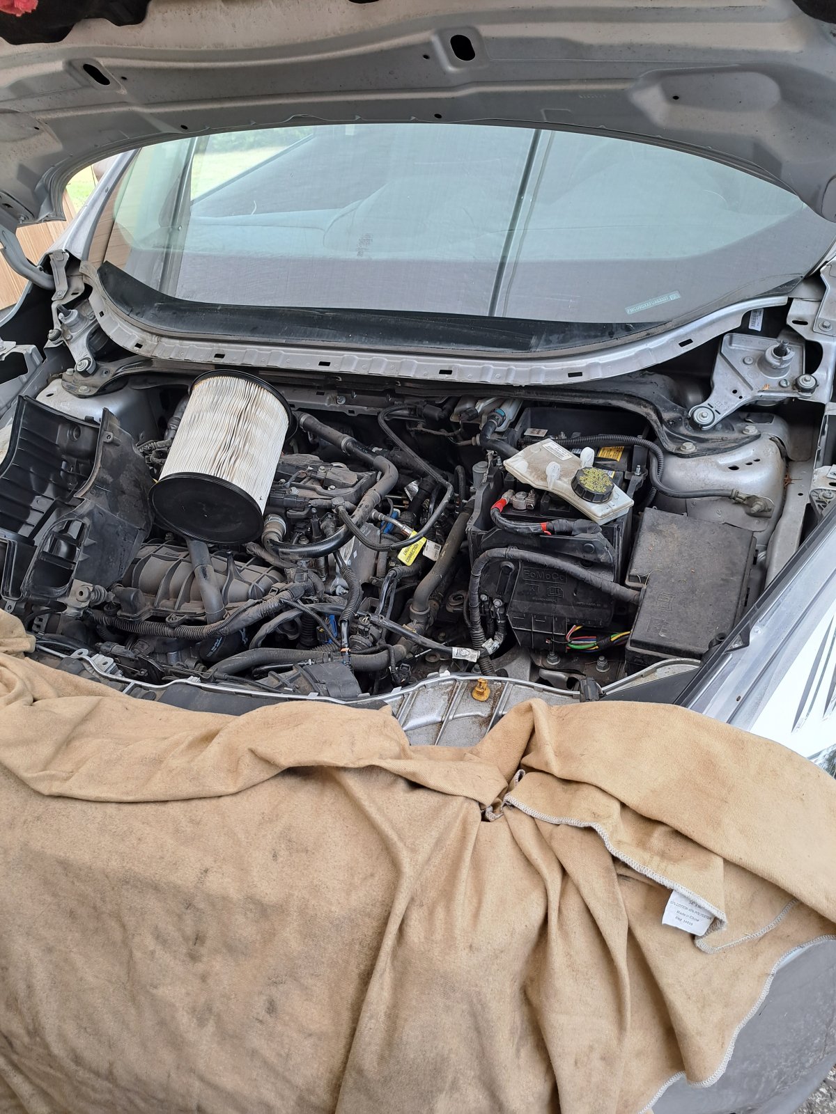

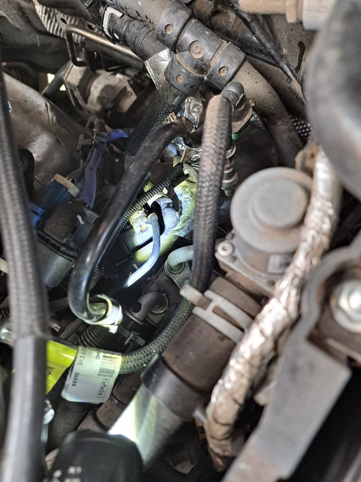

Last night, about 6, got a call from landlord and asked if I could help a golf buddy of his. Turns out the guy is a vet and was 1.5 miles from me. He has a 2015 Ford Escape SE with a 1.6 eco-boost engine and he got it hot and shut off in his driveway on Friday. He saw it getting hot and made it home but set a CEL and the gauge was in the red for 1/2 block. I threw my floor jack and some equipment in back of my Tahoe and my girl and me went to see what is going on. Jacked up, set a jack stand for safety, crawled under and saw coolant leak dropping thru a hole in the splash shied at back center of engine. Buried from bottom but saw a way in from top if remove cowling. It ran fine with no smoke at tailpipe and stayed at 1/2 gauge with reservoir full. My girl drove my Tahoe and I drove the Escape and got home, 1.5 miles, quick as could. Only hit one stop light. This morning I took cowling off and air snorkle tubing at back of engine and none of my pressure tester adaptors fit reservoir. Had to fill with water again and I started it and let run at idle. Then I saw the leak. Broken plastic hose that comes out of rubber hose at back of head, snakes to driver's side and up to front at radiator and tee's off to driver's side of radiator and a quick connect and from the tee goes to the passenger side and attaches with another disconnect at the coolant reservoir. Dealer had part today. I will be doing it tomorrow. With the tear down and diagnosis of this and the complete inspection of the 98 Sidekick and running to dealer and Auto Zone and day getting hotter, at my retirement age, I shut down and will do the hose crap in the cool of early tomorrow morning. Then reassemble all I took apart to get to the culprit. In the brightest part of the light you can see the rusted looking end of the rubber hose and the pulled to the side, rusted looking end of plastic line that broke completely when I laid hands on it. Also, in the last pic you can see the positive cable end that I will be cleaning too. Seems like every vehicle I touch needs that work at the minimum.

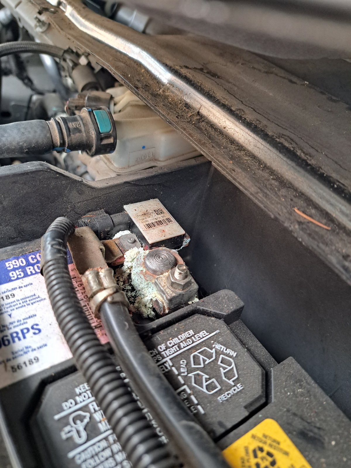

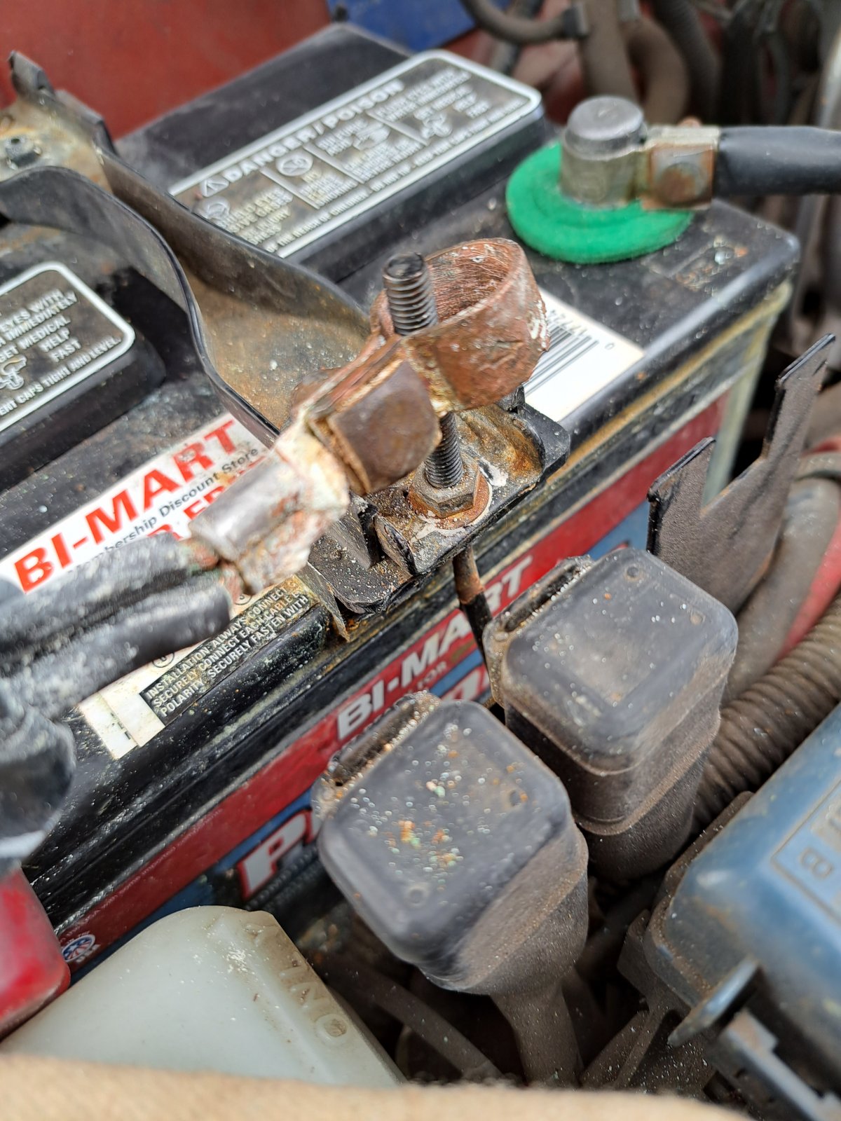

Got failed part removed/installed this morning for the Escape. PITA back in there. Easiest part was the cowling replacement. Turns out that the badly corroded battery cable was the negative cable. Surprised me. 4.5 total hours labor for teardown, diagnosis, part replacement, refill and road test, battery cable cleaning. Labor money in my pocket was $340 plus a $50 house call.

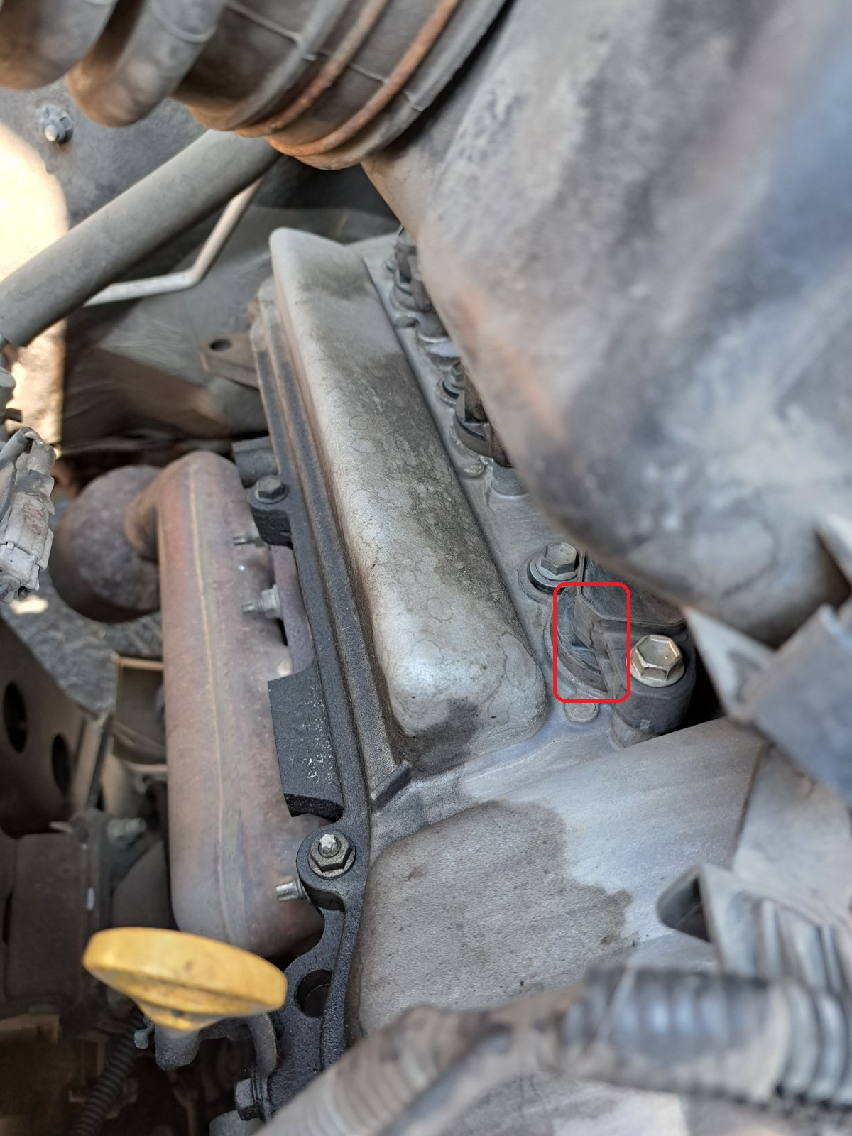

Unfortunately, I had a problem with the 98 Suzuki Sidekick 1.6 SOHC work. Valve cover gasket went smoothly and found 4 of 6 hold down bolts just finger tight. 4-5 hoses over the top that easily unhooked and a bracket that is a support for the snorkle from throttle body to MAF/air cleaner. Had an old style/smaller size oil pressure sender and my sender socket would not fit. Had to use a deep 6 point socket to remove. Then cut off the badly corroded cable end and installed a new cable end. Found that the plugs should be changed every 30k and had 36k on them, so did them too. Installed new pcv valve. The old one was severly clogged and would not rattle at all when shook. It was a pleasure to work on something older for a change that had easy access to components.
Then the shoe dropped. Sorry but have to get back at it tomorrow to figure out my problem. Details and repair/fix tomorrow.

Ok, mystery problem with the 98 Suzuki Sidekick is solved. I did the all the listed work a couple posts back, but when I went to back off the ramps, the engine started and ran for 2-3 seconds and then sputtered and died. Strange. I checked new plugs and they were fuel soaked. I checked spark with an old plug and had good blue spark. Obviously had fuel. I took about 15-30 minutes rechecking my work and found nothing wrong, at all. I then looked at the fuel pressure regulator, that I never touched in the previous work, and when I unplugged the vacuum feed hose, fuel came out. Turns out that the regulator diaphragm blew on the 25 year old vehicle. See video and that was me just turning the key on and no crank. Replaced with a new regulator and it took a bit to restart but was definitely a different cranking sound and then fired off and ran at a higher idle for about 10 seconds and then idled down and was smooth. In gear, still smooth. That damn regulator failed in my driveway. I showed the owner and he agreed that was not my fault. Collected my payment and he said he still wants me to inspect his 86 Nissan Hardbody Pickup. In all the years I have been working on vehicles in my driveways at home, 40+ years, I have only had a vehicle towed 2 times that was towed to me and the repair was more than the vehicle was worth and so was towed away. I had to sleep on it but I figured it out.
So, when some guys have a problem crop up out of the clear blue sky after doing some work, remember, some components/systems pick their own time to fail.

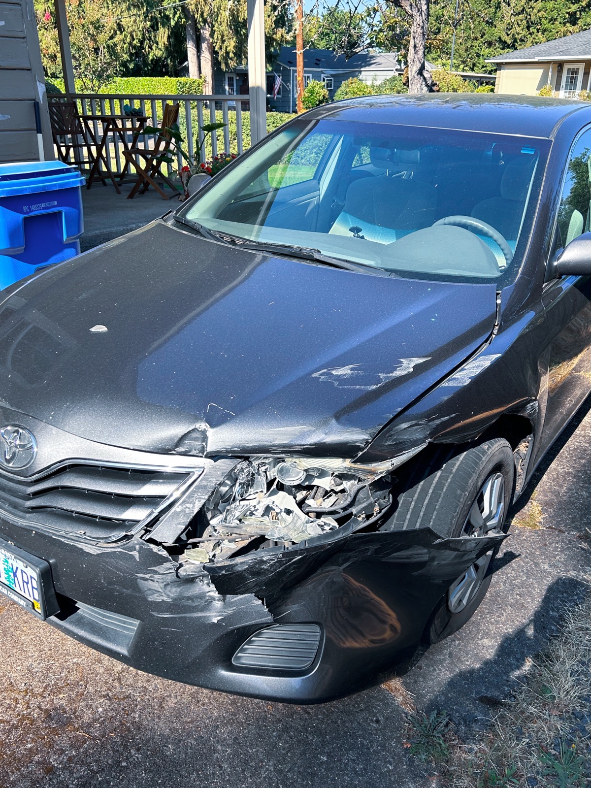

Now some bad news: I worked on the next door neighbor's 2010 Toyota Camry and did the two tensioner assemblies, both serp belts, water pump, thermostat and housing, alternator and new front pads and rotors and an oil change. Just this last week the wife was involved in an accident about 3-4 blocks from home and the vehicle will be towed away this coming Monday as a total. I want to get the hood up and take the alternator off but I don't think the neighbor will allow it. Up close, it looks worse than the pic. It twisted the body and the passenger side rear door will not hardly open. You have to really pull it to get it open enough to step in to sit. Fortunately, their new baby was at home with dad. They plan to buy a used SUV in a couple of months. They have a beat up Corolla that he is going to have me inspect and just get reliable enough for a couple months.
