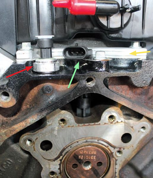

Cam sensor on a Gen III engine is next to the oil pressure sensor, aft of the intake manifold.
The valley cover could be leaking back there, too.
Looking forward from the rear of the engine, the red arrow points to the oil pressure sensor, green points to the cam sensor, and yellow is the valley cover.

Darn for some reason I assumed they moved the cam sensor to the front of the engine after the split model year. Nice to see if with the cover rear cover off. I assume, if that sucker leaks it's going to look an awful lot like the oil pan seal. My plan was to just pull it and put a different o-ring on it.

Looking at that cam sensor photo, I think if the o-ring is shot it'll leak in the same spot. That's my next thing. Thanks again for the photo @Fless !!
