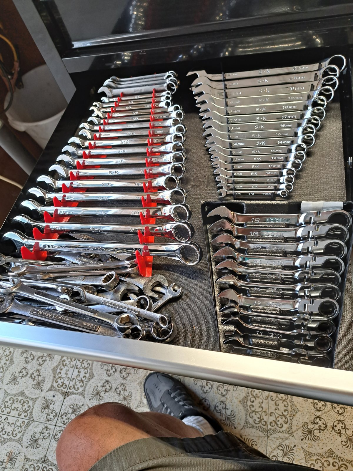

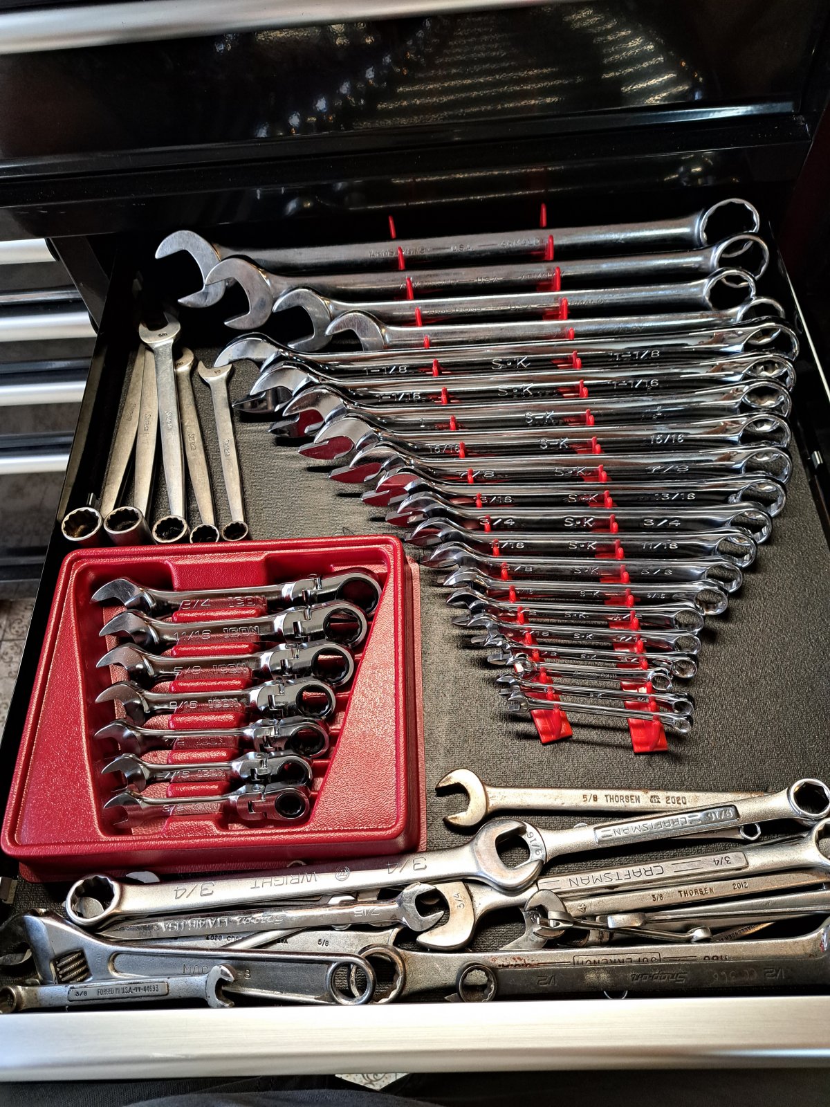

On the metric side of tool box I have a full set of long SK wrenches and a full set of regular SK wrenches. I have needed some stubby's from time to time but did not want to go $400 for a set of stubbies with metric and SAE wrenches. Since I rarely need/use a stubby wrench, I decided to get a set of ICON flex head ratcheting stubby wrenches that cover metric and SAE. I have a long set of SAE SK wrenches as well and have not run across any need for a regular length SAE wrench set. So much of what I work on is metric anyway. I have some loose metruc and SAE wrenches in each drawer.
View attachment 407157View attachment 407158
Those ratcheting wrenches are awesome.
