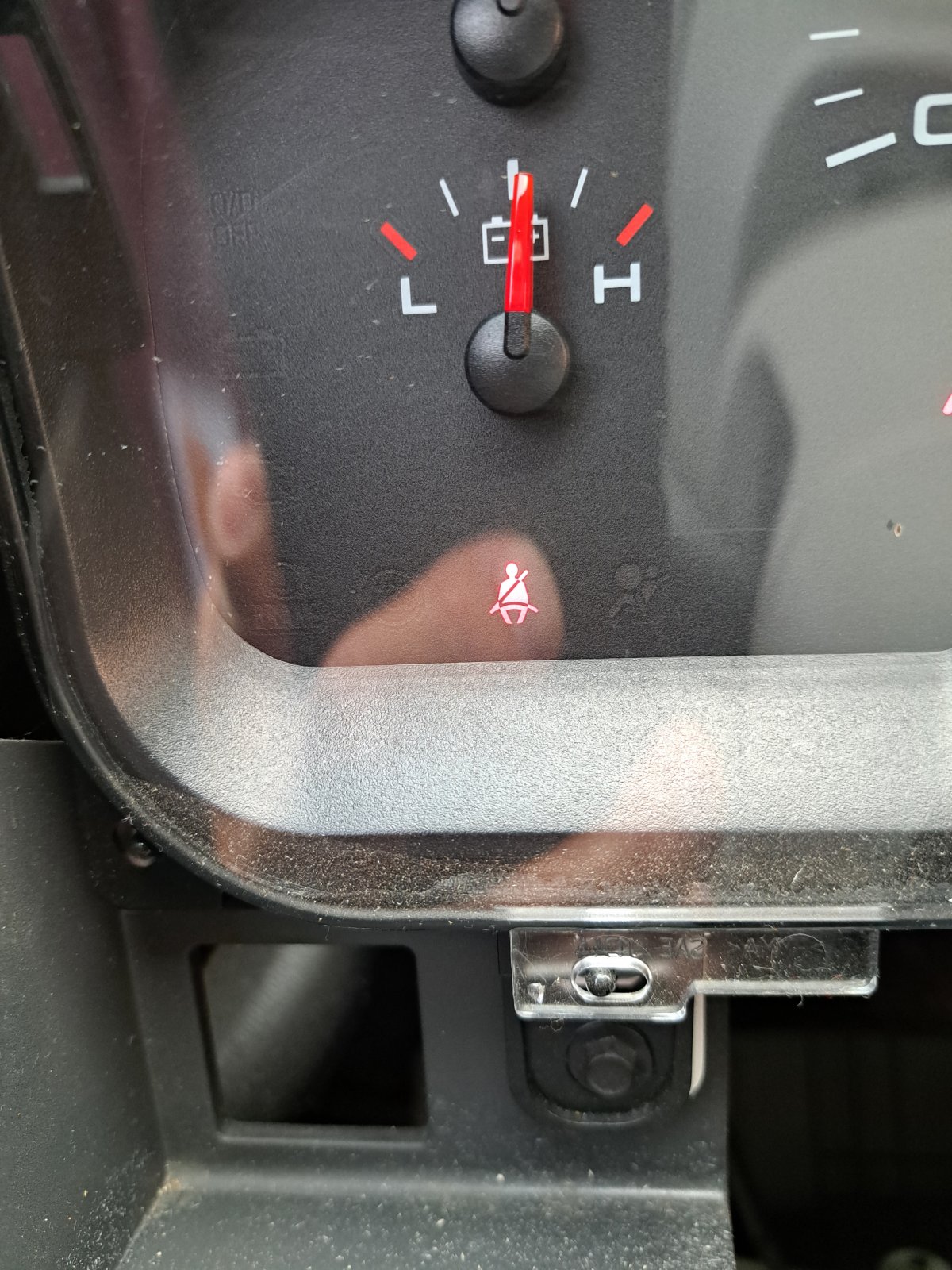

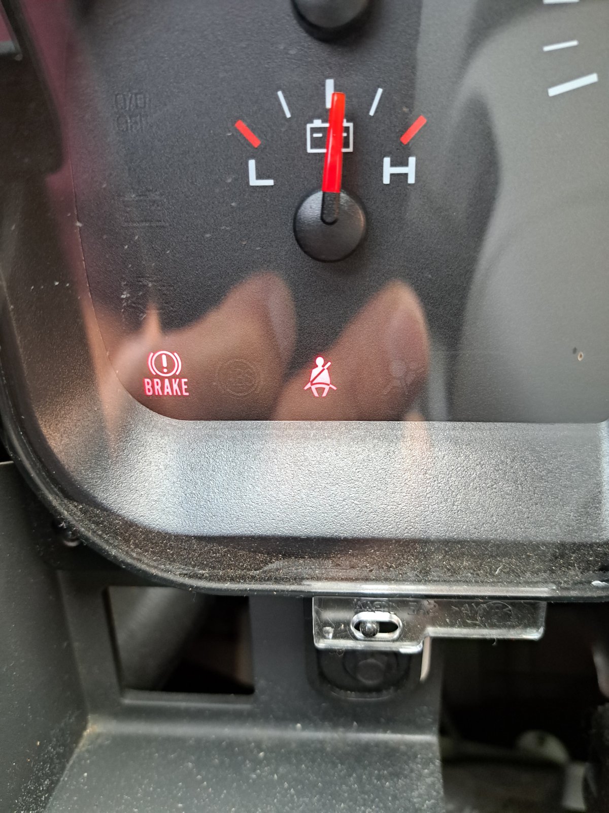

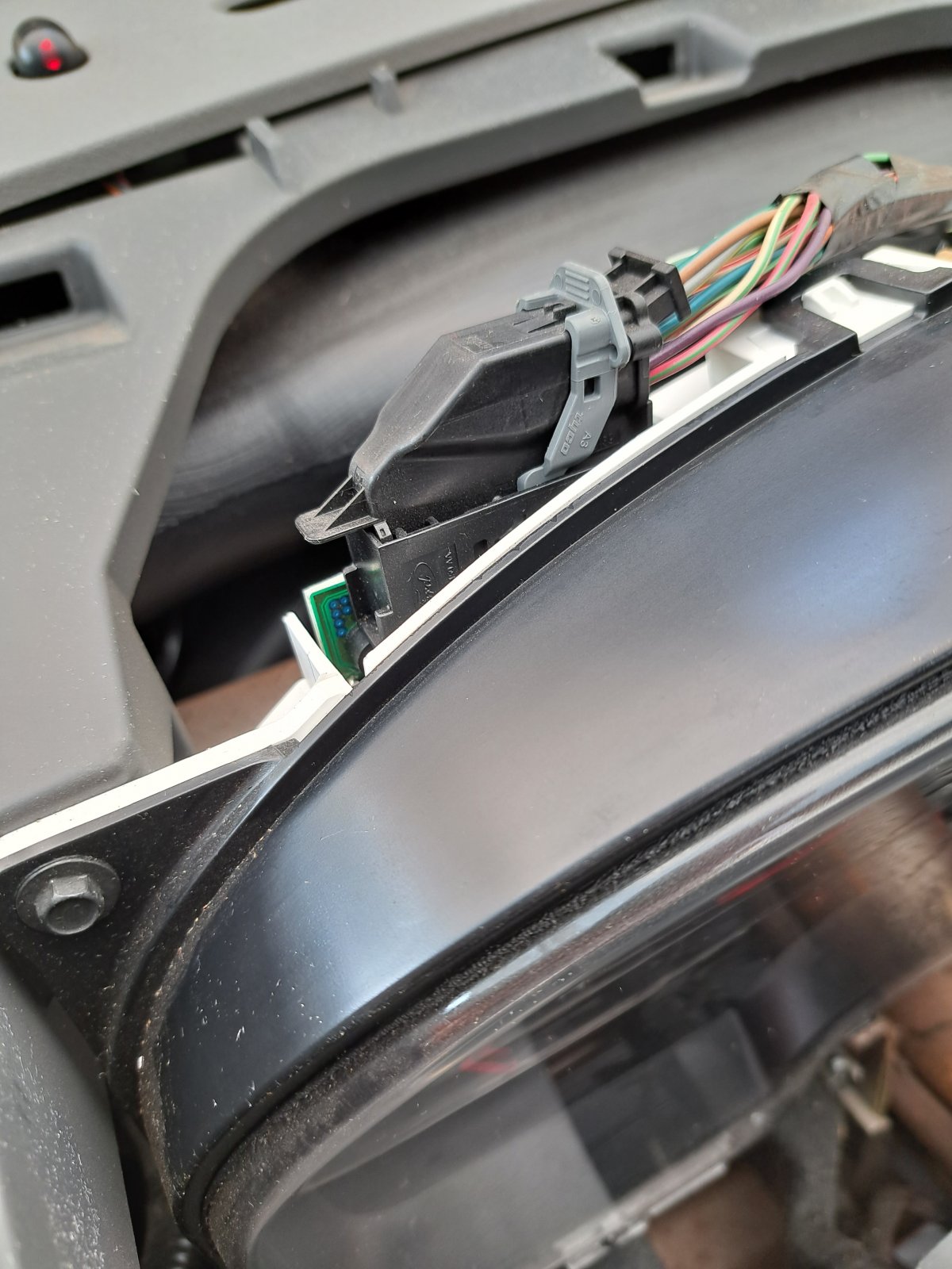

Ok, in the pictures below I am showing you where I was after the lower trim removal and the upper cluster surround trim cover are removed. The problem, as I stated above, is that even with the park brake off, the park brake light on the dash would stay lit all the time. The harness connector in the pic is where the problem is. I did not unplug it but I just flexed it forward and back and left and right. The sweet spot is pushing it back, toward the engine, and toward the driver's side and the light went out and stayed out. If I flexed it the opposite way, I can turn the light back on.
I also road tested the truck this morning and was able to load/accel the engine and make it misfire any time I wanted and for as long as I wanted. It does feel like a torque converter locking and unlocking but I still believe it is a misfire for two reasons: I heard a small backfire this morning and I can accel hard when in Park or Neutral and feel the misfire but not as bad because I am not pulling the truck weight, like when driving.
See pics, all taken with engine running:
View attachment 406493View attachment 406494View attachment 406495
Seeing as how that connector base appears to be connected to a circuit board, you might see if there are any cracked solder joints on the pins that attach to the circuit board. If you can get at it with the cluster pulled.

@iamdub & @Fless , It is one of those engines that is involved with the spark plug problems but fortunately the dealer did replace the plugs at 101695 miles and it now has 136698 miles on it. If I do end up doing the ignition coils, about 95% sure I am, I hope that when I pull them up and unplug the coils, the plugs stay in the hole and I will look do in there to see if I see anything obvious. I do not have the special tools required for that problem and don't want to be involved.
@Fless, At this point, all he wants to do is know what to do to keep the light out and it will set and turn on and off when the park brake is set and released. He is still not 100% sure he is keeping and I showed him this set up this morning when I had the covers off. For now it is staying out and if need to go back in again, to get to where it is in the pics, is no more than 10 minutes.

Clusterf...ix if you ever do one.
I'd probably touch up the solder connections where the connector base meets the circuit board. Looks like those also use twist-in bulbs and it might be wise to change them out while it's apart.
