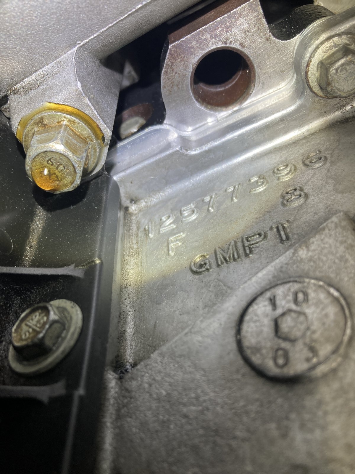

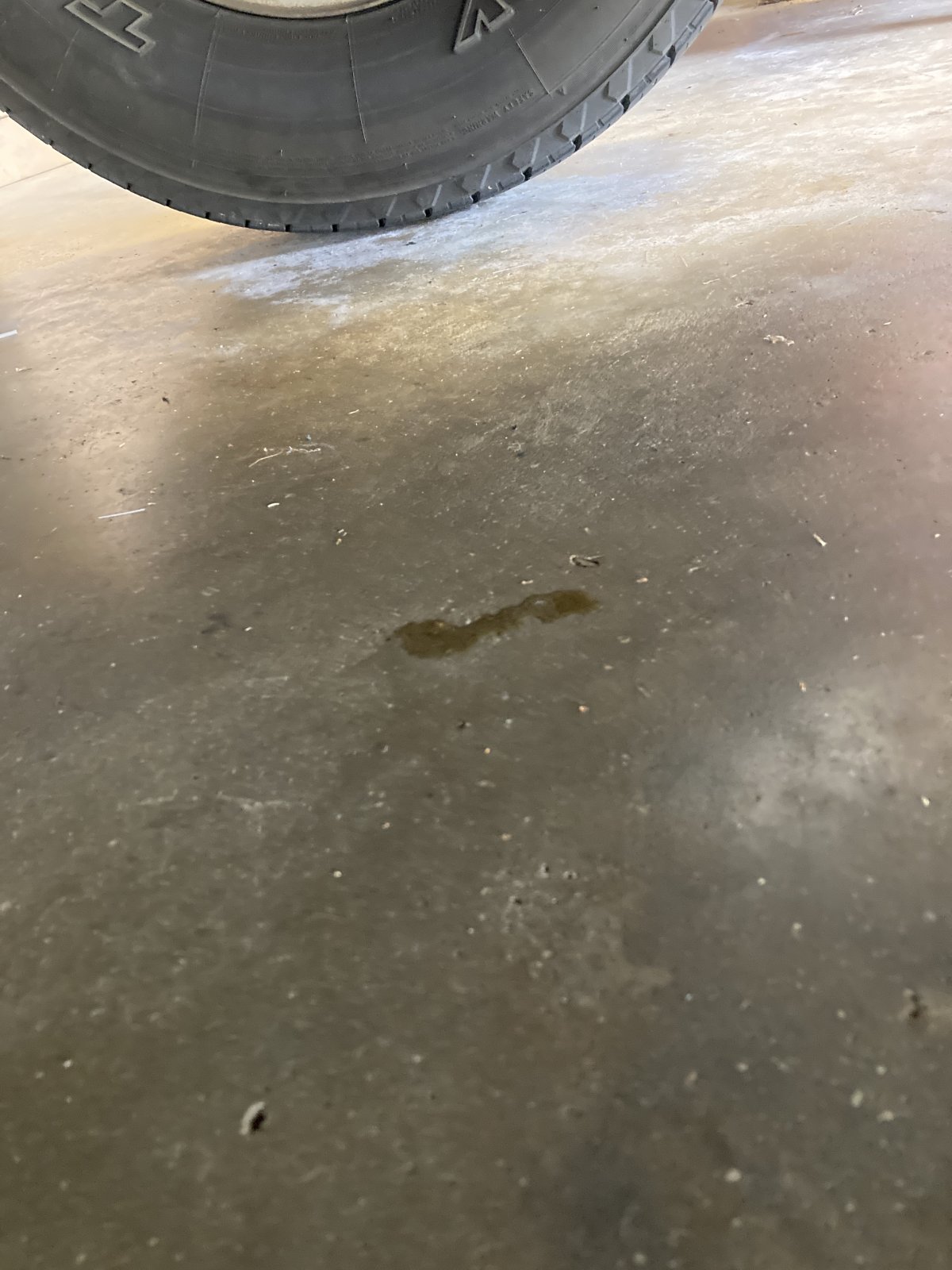

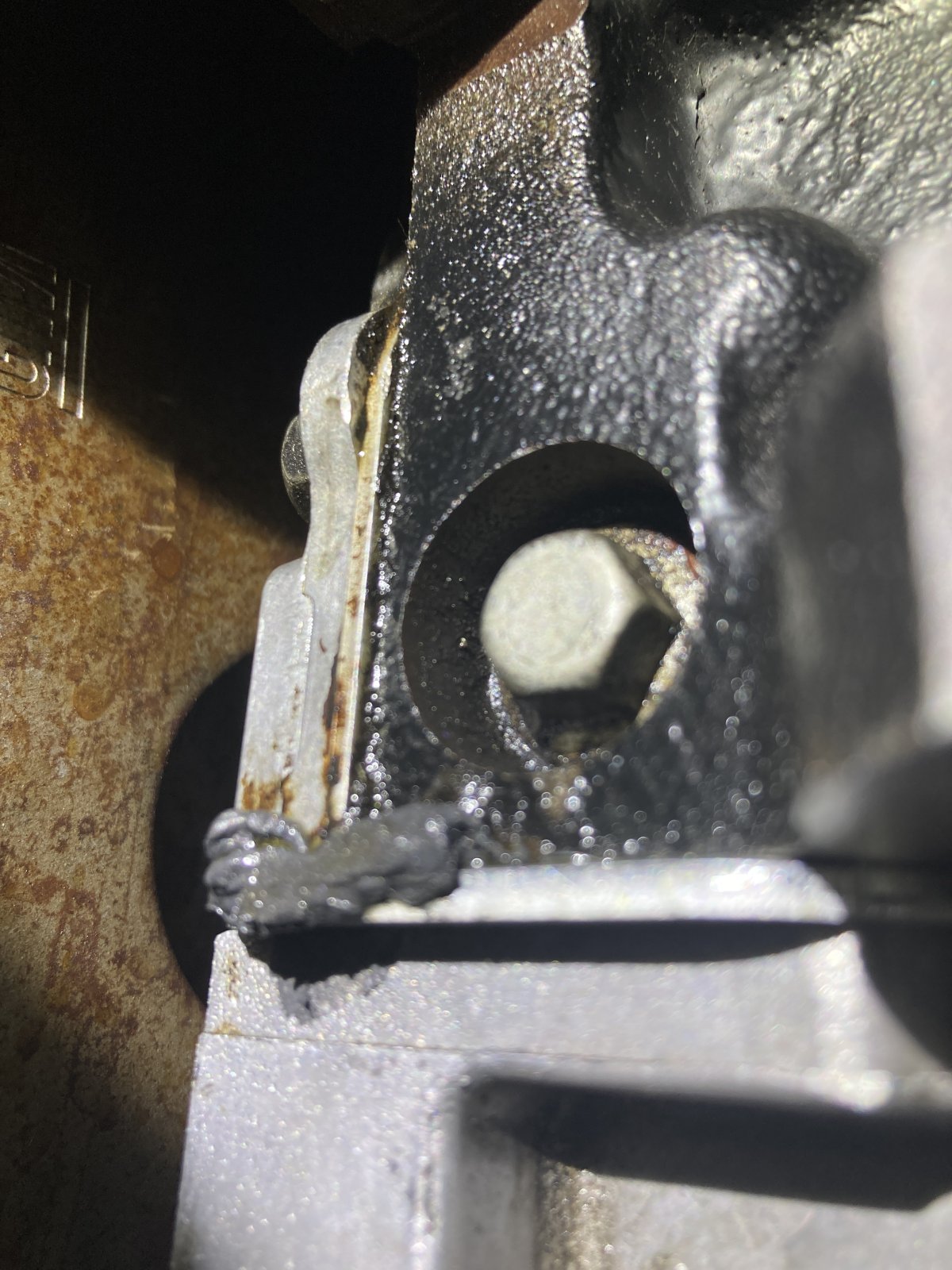

Another Update - The next morning there was one or two drops worth on the floor (pic). They fell from the inboard starter mounting bolt (pic). Since this bolt is very close to the joint of the rear engine plate and the oil pan gasket corner, I couldn't tell which one was leaking. I pulled the starter and cleaned up the area (before and after pics). I'm going to let it sit a while to see if any new oil shows up. If not, I'm going to install the starter, run the engine, take it back off and wait for oil to show. Hopefully I'll be able to finally tell which is leaking.
There was no oil on the driver side bolt pan bolt noted in my last post.
More to come....
More to come....
Oops. I forgot to attach the pics

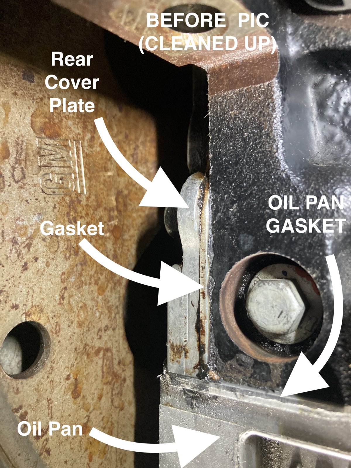

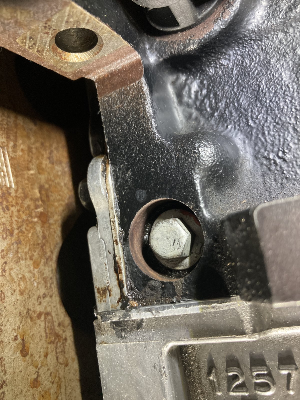

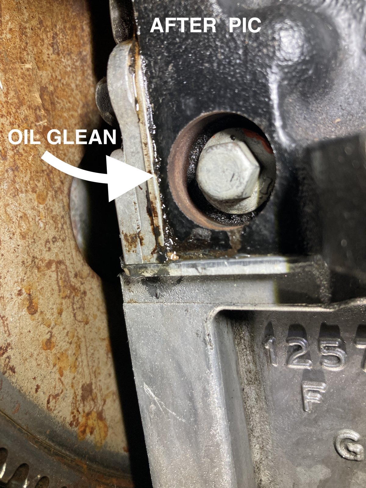

Update - Looks like a rear plate leak to me. I cleaned up the area and waited an hour or so for oil to show up. Attached are the before and after pics.
If it's clearly a rear plate leak, I'm going to use a shop (giving up my man card) to replace the plate gasket, rear main seal, and refurb the transmission while it's out.
Thoughts?

That is the very best job I have seen cleaning up the engine and getting very clear photo's showing your leak. Nice Work.
I just completed removing the tranny/transfer case and replacing the Rear Main Seal, Plate gasket, T-bone or Dog bone, and the 6L80 got a new Torque Converter. I chose the Luk and like it a lot. Works great. No leaks at all so far. I hope yours turns out perfect.

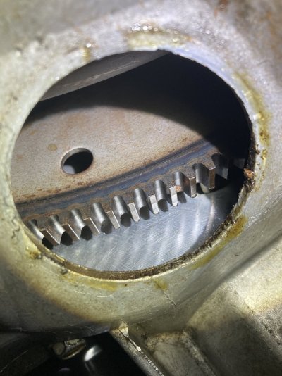

Determining if it's RMS or Rear Plate Gasket....

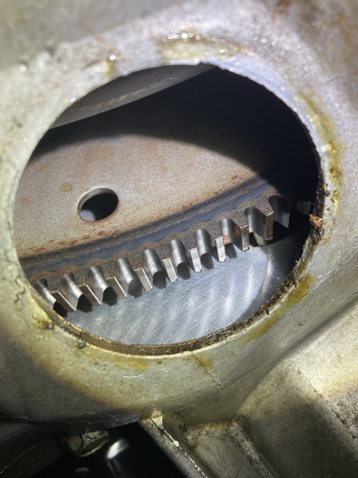

I suppose it doesn't matter much because either leak requires transmission removal and both RMS seal and rear plate gasket should be replaced at that time. My shop quote was ~$1K, but I chose to refurb the whole drive train at $4.6K. However, I was able to determine it was the rear plate by removing the starter, cleaning the three way joint and waiting (see pic in the thread above). I was trying to make sure it wasn't the oil pan gasket before spending a lot of money. You could try removing and looking through the inspection plate. A video probe helps. As others have said windage and the spinning flex plate can throw that oil around. Mine was clean in the bell housing (see pic) because the leak at that corner wasn't going into the bell housing.

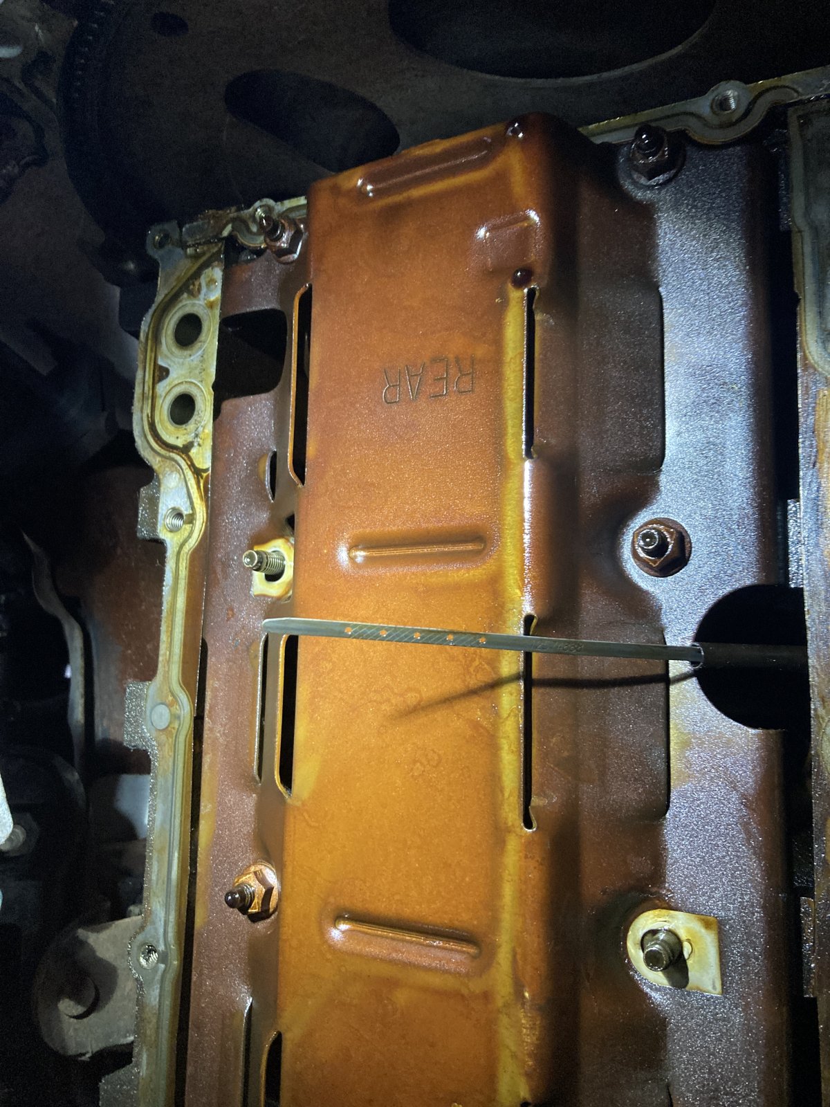

Thoughts on observing how long it leaks after parking....
See pic of oil dipstick with the oil pan removed. The resting oil level is below the top of the oil pan. This should mean that all oil leaks except for the drain plug should stop after the truck sits for a long while. Of course there's a lot of oil on the internal engine parts and surfaces that will continue to seep out of leaks above that joint.
Some parts under pressure, like the oil pressure sensor, leak most when the engine is running. However that oil travels down the outside of the engine and could continue to drip at the bottom.
The Rear Main Seal is mating with a rotating shaft and should decrease leak rate after shutdown, but again has to travel down surfaces inside the bell housing to get out.
Bottom line: It's not very definitive to observe how long it leaks after parking, but if you clean a lot on the outside and keep in mind the paths and timing for the oil to appear, it helps a little.
