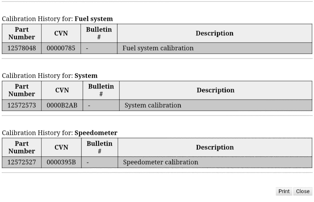

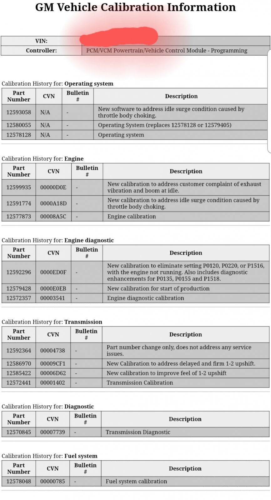

VVT was introduced in 2010 on the LC9 and LMG 5.3 motors. Well, as to whether or not yours has those calibrations listed, plug your VIN in here and have a look: https://tis2web.service.gm.com/tis2web
I really don't know if it will be a patch or a whole new program.
I got this for my 03---
I don't know if this is specific to my vehicle or if it's for just my year vehicle--Recalls or updates in general. Cool stuff tho.

I got this for my 03---View attachment 263731 View attachment 263732
When you request the info from your vehicle with the Tech 2 and then plug it up to your PC and TIS2000 it reads the current VIN and software calibrations and then it will pull up all of the software updates available for your vehicle since the current/existing calibration and give you the option to update to the newer software and it will list out what each calibration addressed or fixed, just like what you are seeing there.

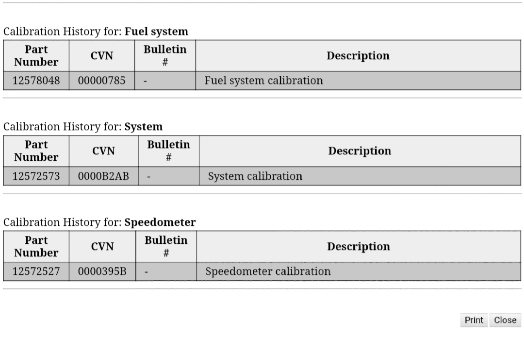

Got a simiar for mine. Yeah its nice to know a list is available to know what ya need. My numbers didnt match at all what i posted earlier. Probably for another vehicle if the engine is used in that. Maybe....

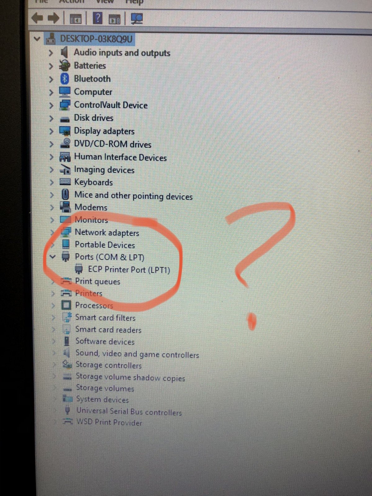

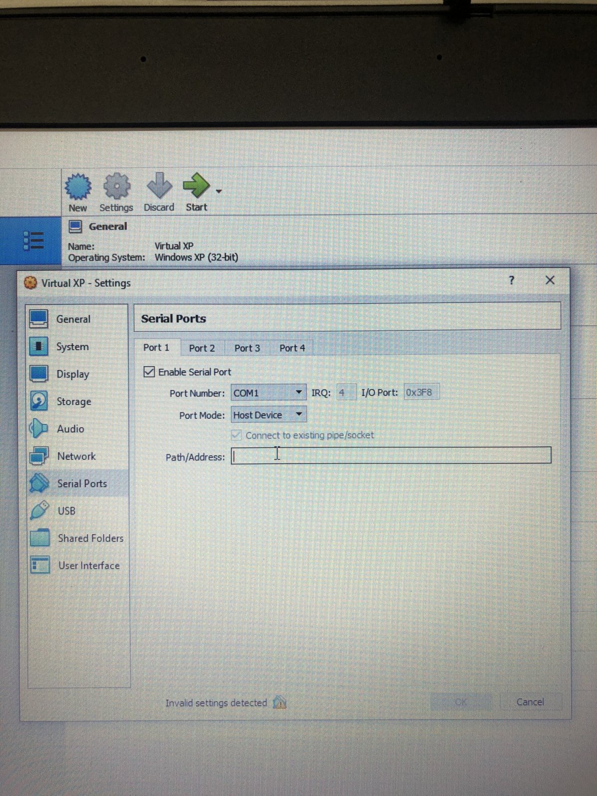

Here is where I get stuck:
I need to set Virtualbox to allow my machine to communicate with the host COM port on the screen shown below.
But when I follow the instructions I linked before the VM won't start. it just gives me an error saying it "failed to start". I figure maybe that's not the name of the port so I go looking for information of the port in Device Manager and find a whole bunch of nothing as you can see here.
So Close!
Sam Harris
Sep 26, 2018
7,445
14,977
Texas
So Close!
Yeah looks like it’s listing printer port and no com port. Do you have a real com port, or a usb emulating one? It’s pretty rare to see an actual serial port these days, but absolutely preferred.
I had the same problem with my MacBook Pro. It was using an emulator for the serial port, so I could talk to some lab equipment.. never got it to work. It’s a pita.
George B
¯\_(ツ)_/¯
Feb 5, 2020
7,882
18,994
Oconomowoc, Wisconsin 53066
I am thinking I will need to find a USB to Serial adapter. the problem then will be that mi TIS2000 is looking for COM1 and I will be on something like COM7, 8 or 9.
I dunno...
