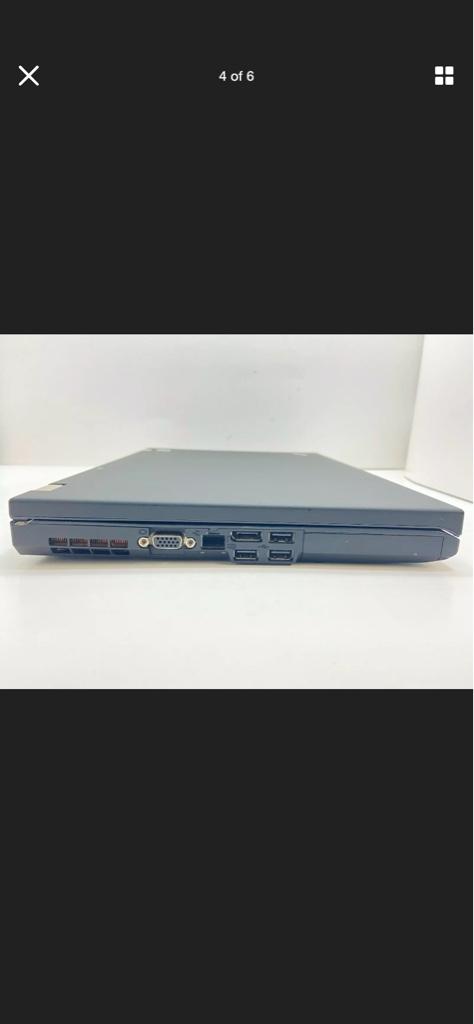

I’m sure you can make it work. I haven’t bothered to try using TIS2k, after speaking with some knowledgeable folks on this forum. I don’t have a need for it at this time. If I do, I’ll invest in a cheap laptop that has an onboard serial port. Then, there’s no BS adapter, which, in my experience, very few actually work. Look at a Lenovo T410. They’re cheap, and have a serial port. [emoji106][emoji631]

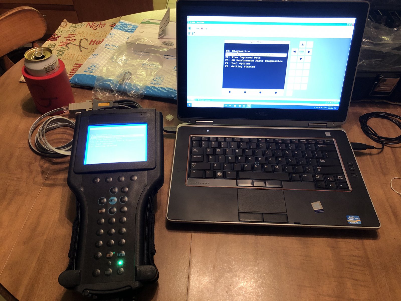

Ran out of time tonight but I noticed it would only connect to the Tech2 view. None of the other options would connect. Any pointers? I figure if it will connect for the view it should connect for the rest.
kbuskill
Mar 11, 2017
5,861
9,931
NE. FL.
For me it is sometimes finicky. I will usually go into Tech 2 mode/view and once it connects I back out of it and connect to the SPS.

I was able to read the info from the Envoy and get codes from tis2000 but programming of the envoy failed. Thought I messed it up but it still runs. It kept dropping connection to the pcm and I would get the unknown driver message on the dic. I may have to go into special functions to get the connection to make and then back out to program. I think the truck has a communication issue. May try again some other time.
