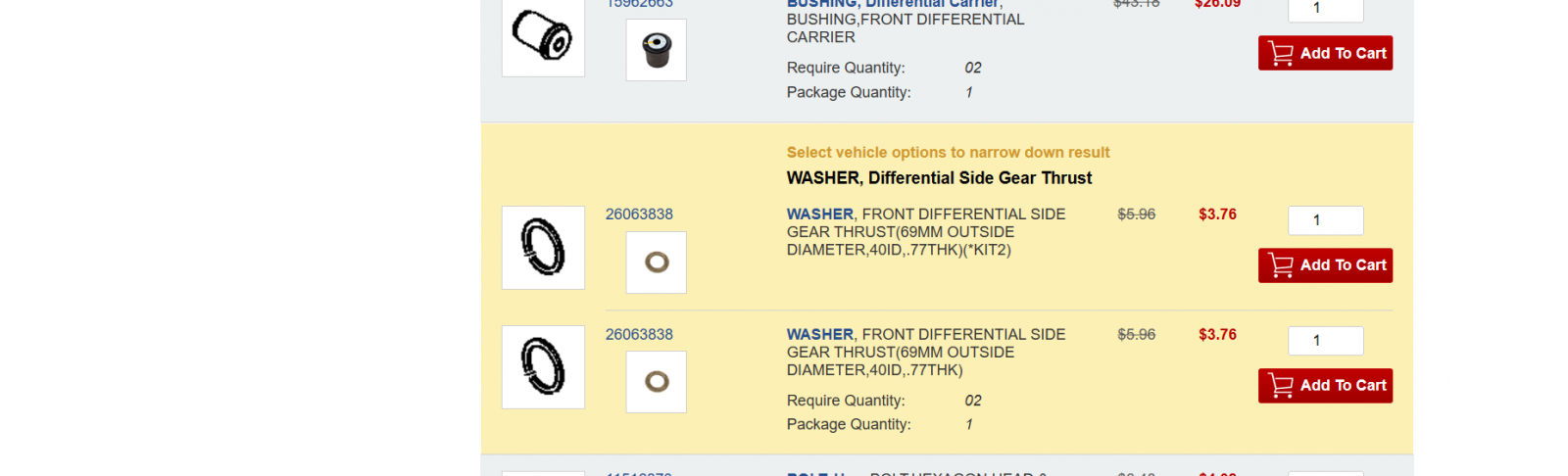

I don’t see that info on the GM website, where did you see it?
thats weird, its showing it on the parts website I was directed to from you guys

I asked a question on the other one that was posted, it looks more like it. If that doesn't work then junkyard may be my best bet.
How bad to you think it would be to use the washers that are slightly bent?

I guess I don't see what part of the diff you're working on. Could you describe it a bit more in detail? Do you see it in the diagram on the link that @Rocket Man posted?
I'm working the right axle shaft, replacing the seal. Didnt realize there was a lock ring on it and started trying to hammer the shaft out of the housing which bent the 2 washers.

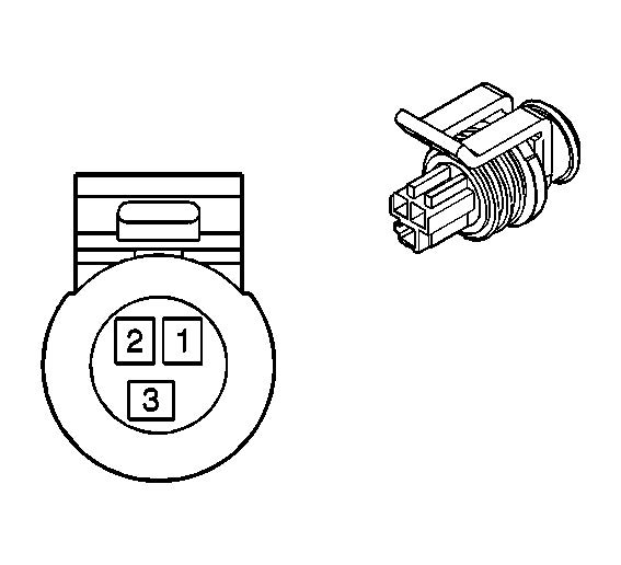

Displayed Oil Pressure
The scan tool displays 0-682 kPa (0-99 psi). The displayed oil pressure gage value in the IPC.
Engine Oil Pressure Sensor
The scan tool displays 0 to 5 volts. The PCM monitors the engine oil pressure sensor signal circuit where
a low voltage indicates low pressure.
Oil Pressure - Minimum - Hot
6 psig at 1,000 engine RPM
18 psig at 2,000 engine RPM
24 psig at 4,000 engine RPM
EOP Sensor Terminal Identification
Pin Wire Color Circuit No. Function
1 BLK 2755 Low Reference
2 GRY 2705 5-Volt Reference
3 TAN/WHT 332 Oil Pressure Sensor Signal
