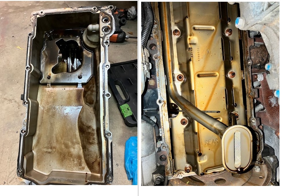

My oil pressure drop a small amount and I got some ticking and some other noises at idle intermittently , So yesterday I pulled the pan the ring was very lose compared to the fel pro i replaced it with I was able to get the pan out by droping the axel with a jack , I cleaned the pan and put back together, I cleaned the battery ground while under their as well so I have no yet started her up. I replaced the pressure sensor a few months ago as PM due to the amount that they leak. (I have had bad experiences in the past with oil pump o rings ) My truck has about 190k

I questioned it my self but after finding a number of You tubers said that o ring was their solution I added it to my PM list figuring if it was not failing it would be soon and my engine noises were more frequent. It also a good opportunity to clean the pan and see the internals , I also drove 2k miles over Christmas .

Some days I believe anything is possible i use the same oil and filters for years so that not my issue having diff out of the will make it a lot easer , check and clean you ground wire driver side while your under their having the diff out will make that very accessible,
190k Most of its life Mobil 1
