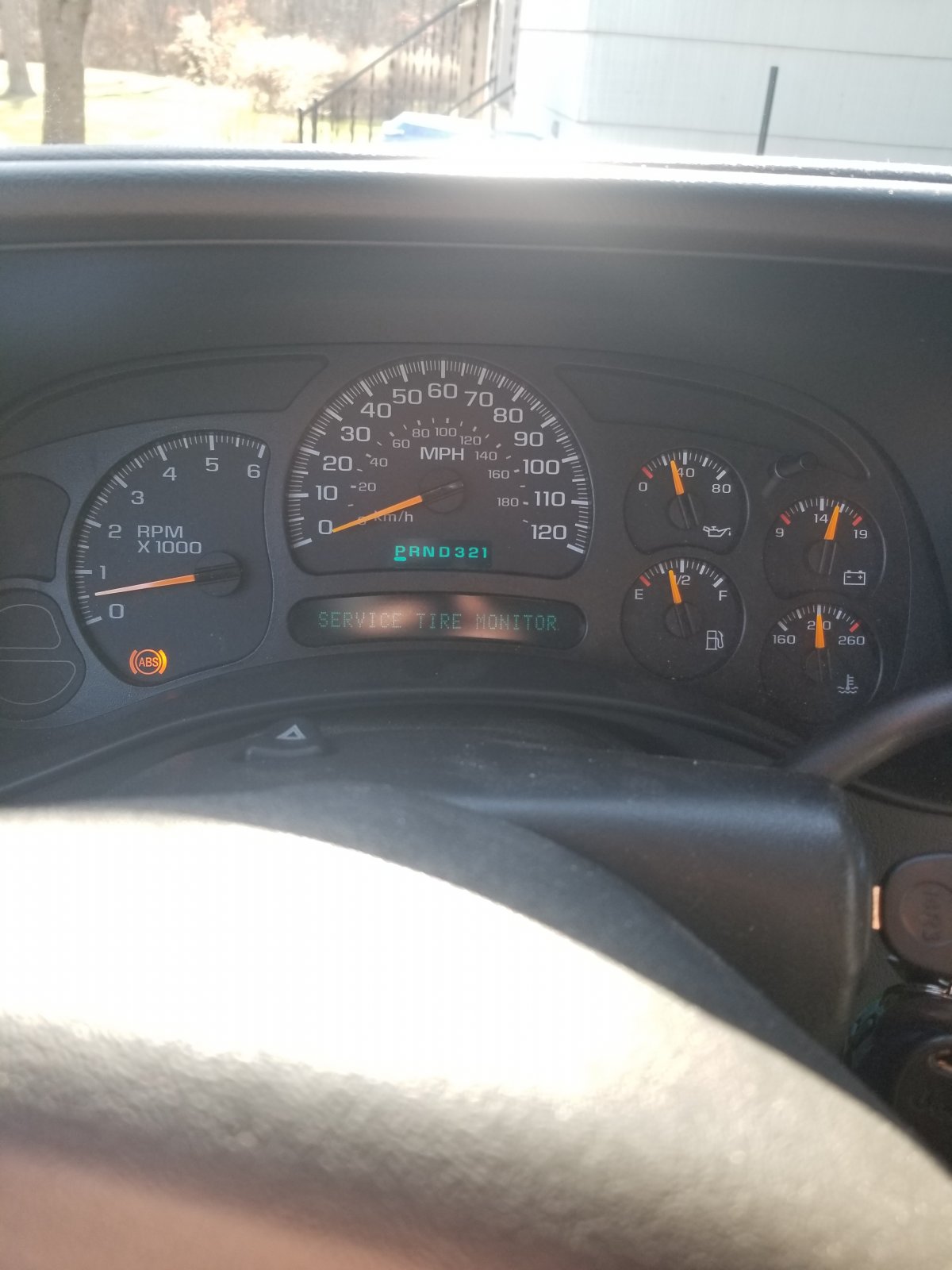

Hi so my 05 tahoe with the 5.3 seems to have lowish oil pressure while idling. At idle it has around 25-27psi of oil pressure, compared to a few months ago where it was a steady 35-40psi. Oil was low the other day and I topped it off, but the oil pressure stayed the same.

I'm curious to hear the comments you receive. On a related subject, I've never been very comfortable with the accuracy of these dashboard oil pressure gauges in our Chevys. If I'm going to diagnose an issue, I want to be sure my data is accurate. Has anyone verified the accuracy of these dashboard oil pressure gauges? What method did you use to verify? Sorry, I don't mean to hijack your question, just feel better knowing we are looking at real readings.

I haven't verified with hooking a gauge up yet, just going off of the one on the dash, and yeah I'm not sure I believe it either.
